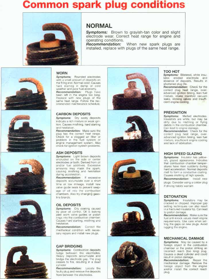

also, when checking to see if a spark plug is good, you need to unscrew it out of the head. Here's a basic diagram to diagnose your sparkplugs.

thanks for the pics caboose. i just went ahead and bought 4 new NGK plugs. they were only $10 for all 4. bought new plug wires too. i will keep in mind if she has trouble starting again thanks.
