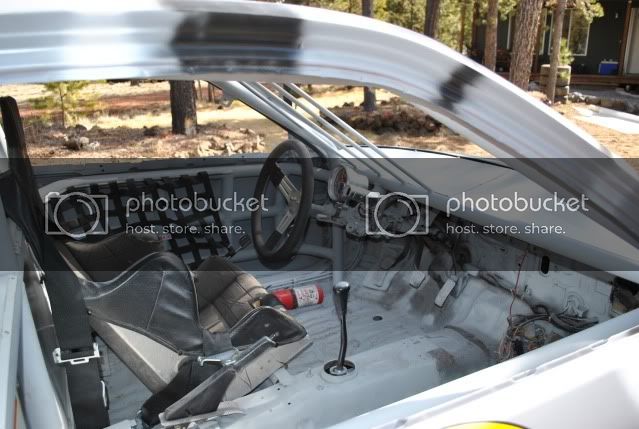

thanks for the braking tips. Im sure that will help, I have no doubts about the power to weight or traction in a straight line, just was a bit concerned about gettin it to stick in the corner but it sounds like that will help. I got the decals done last night a few more touches and I'll get the final product pics up. Thanks for all the support.:D

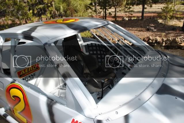

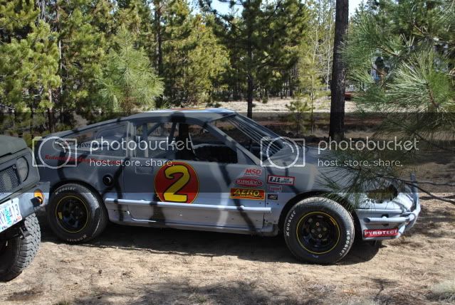

well here it is done and ready for the races...weighed it today full of fuel and ready to race....1877lbs. was shooting for 1800lbs even but this is close enough.

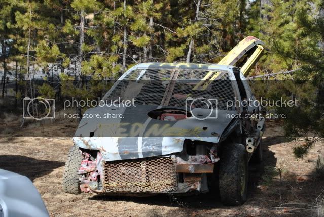

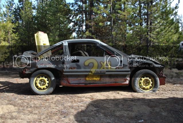

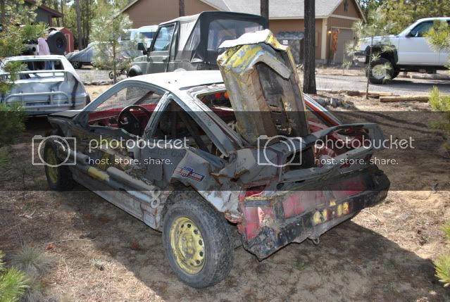

...as you probably saw in the background...that is my derby crx it was a 89, d15 dpi with a bad set of rings, and a complete bondo rear quarter cost $50....derbying a crx ..priceless. It will be finished off this fathers day derby in Redmond Oregon, if anyone local wants to come cheer it on...lol.
...yeah it still runs, but smokes like a factory. its been in 1 demo derby, and 3 bump to pass races against cars like cadillacs, and lincolns. Notice the driver door...I was t-boned by a cadillac in the last bump to pass race.

a setup tip...run the left front tire almost flat..run slightly more in the left rear,run the most in the right rear and the right front should only be a little more in the right front..
so say..
LF-15psi LR-18psi RF-23 RR-28psi

thanks for the air pressure hints, that'll give me start point. we almost got the eg finished up today, a little sheet metal work and it'll be ready. and the other hatch...well turns out it had a bit of a warped crank that ate the bearings at start up. crank is now back from the machine shop, and will be re-assembled tomorrow. I can only suggest if you have aa dirt track near by...go for it. the rush is awesome, nothing like running side by side at 60+mph with 12 cars on a 1/4mile dirt track....:eek:
