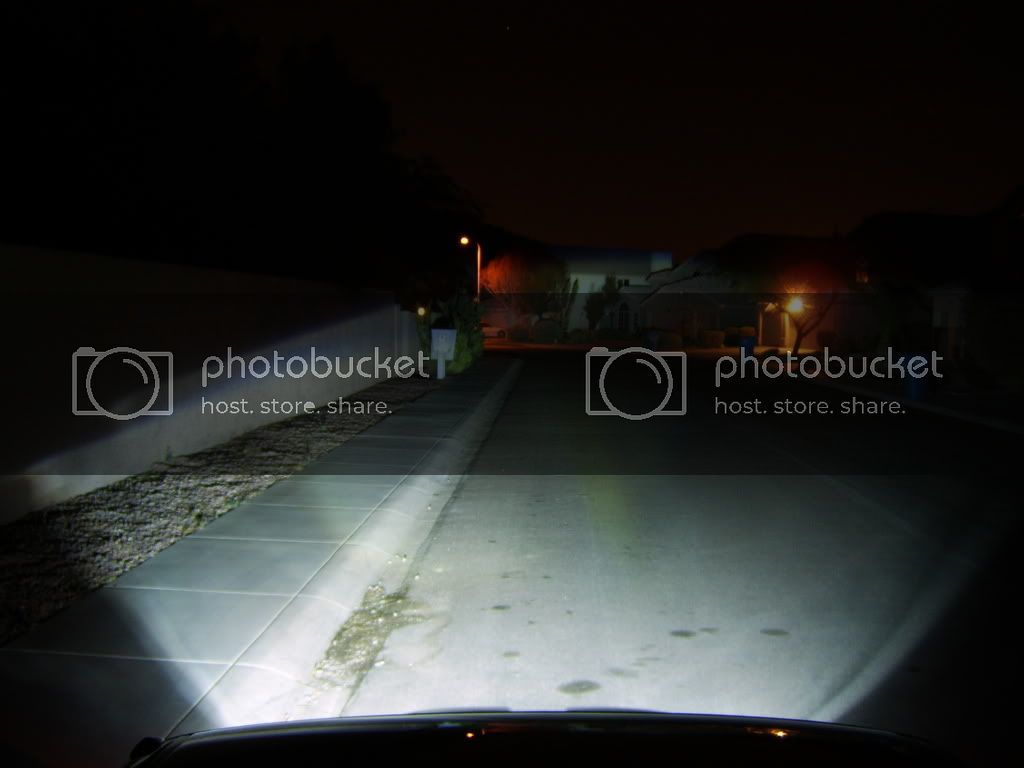

    Ok, you're doing this all wrong. HID bulbs with an H4 base do not make it function properly. If you put a HID bulb into a halogen reflector it will diverge the beam. The reflector for a HID bulb converges the beam, and then the lense diverges the beam.
    With the TYC headlights you picked out, you'll have the beam-pattern equivlent of a flashlight. Sure, you'll have the blue-white color you're after, but the night-time visibility will be horrid. You'll probably be blinding people too, because the tyc headlight isn't designed for that type of bulb.
    You need HID Projectors, not those shitty TYC 'projector headlight housings'. HID projectors look like this:
    You need this:
    HID Projectors
    bulbs
    ballast
    relays to make the wiring harness.
    You need to read my DIY thread.
    One thing you could do is to retrofit some TSX Projectors into the TYC headlights. That's really the only way I see that you can do it how you've described.
