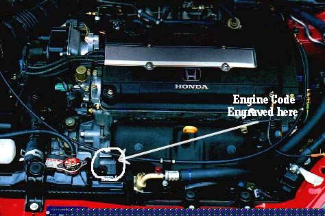

i am new to the whole honda thing but i would like to know how to tell which motor i have.i was told that it is a 1.6 v-tec but would that be a b16 d16 or what?it is a 1994 honda civic.if anything just post some pics thanks
on the front of the engine on the left side of the block right next to where the tranny bolts up there will be a flat area with a code stamped into it
depending on how filthy your engine is you might need to scrape away a layer of shit to see the code... a large flat screwdriver works well
ok to add to my stupid question....my motor is a b16z6 in comparison is it better or worse than other b16??or just a small explanation of which order they do in according to power and performance.thanks again
I think you need to check it again it should read d16z6 or someone is messing with you. Someone correct me if im wrong the civic did not have the B16 until 1999 and the del sol had it as an option from 94 until end of production. Also the motor in the car should be a single cam. The picture above is a B Series motor.
