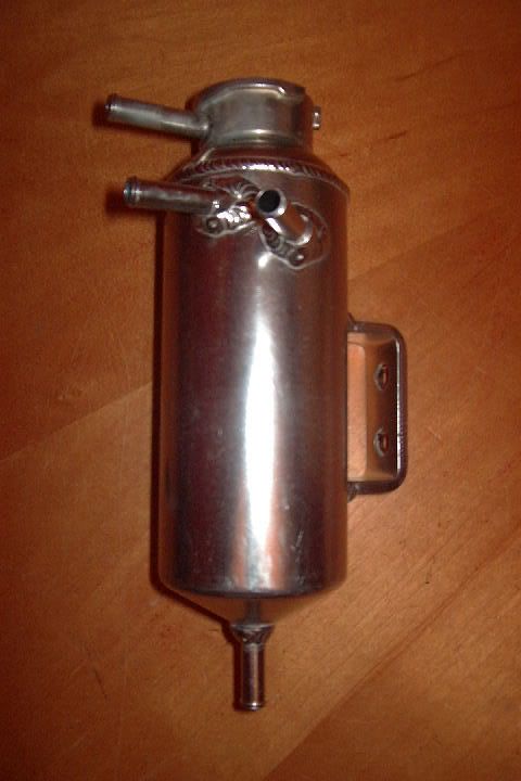

wouldn't that just be an overflow?
Its different. A breather tank is positioned higher in elevation with respect to the radiator so that bubbles can be bleed out of the system.
I installed an ebay breather tank along with my koyo radiator. Car ran like a freezer when it used to overheat (after merciless beatings on very hot days). They look like this:
sounds like improper air bleeding when filling the coolant system to me
cant really say i've ever heard of anyone using those
usually any air left in the system will get pushed from the radiator (highest point on most system) into the overflow
and when the system cools it pulls back in coolant
Its not improper - its just more efficient than letting the fluid slosh into the overflow tank. This is what the setup looks like:
