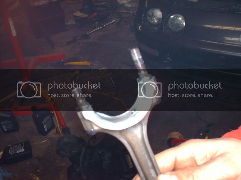

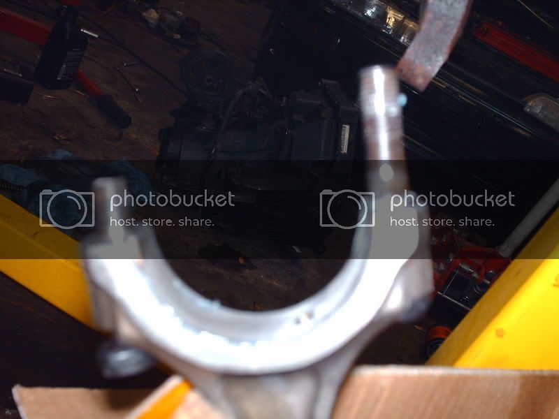

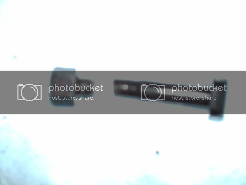

    Heres a couple of pics of the 8 mm arp rod bolt that snapped.

    Probably a bad batch of metal, send it to arp and they will probably send you a new one.

    crossthreaded perhaps?
