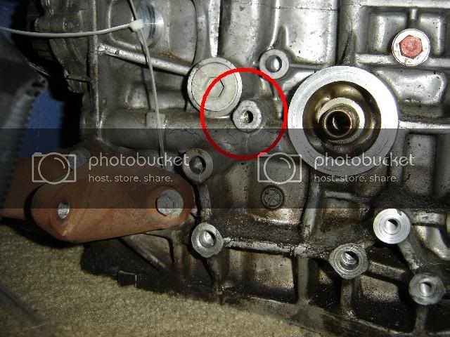

E ef9civicgen4 Senior Member Mar 2, 2006 #1 Is this the oil pressure sensor used for an oil feed line for a turbo setup?
9 97hatch ? Mar 2, 2006 #2 yes that is it be carefull that is a metric pipe thread and a us fitting will not fit in there with out leaking it is a 1/8in bspt you will need one of these www.mcmaster.com part number 4860K141
