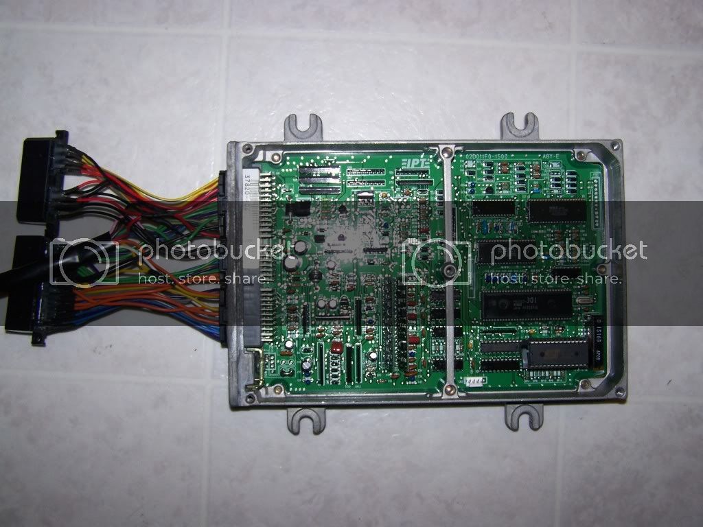

Are you familiar with chipping an ECU or are you sending out or having someone you know do it?
I already have a chipped P06 ECU. I just bought a SST chip with a D16Z6 stock basemap on it so I can just pull the old chip out and pop the new one in and be on my way.
make sure of that, some people are jerks and solder the chips right in instead of putting a socked in place.
This is what I have:
