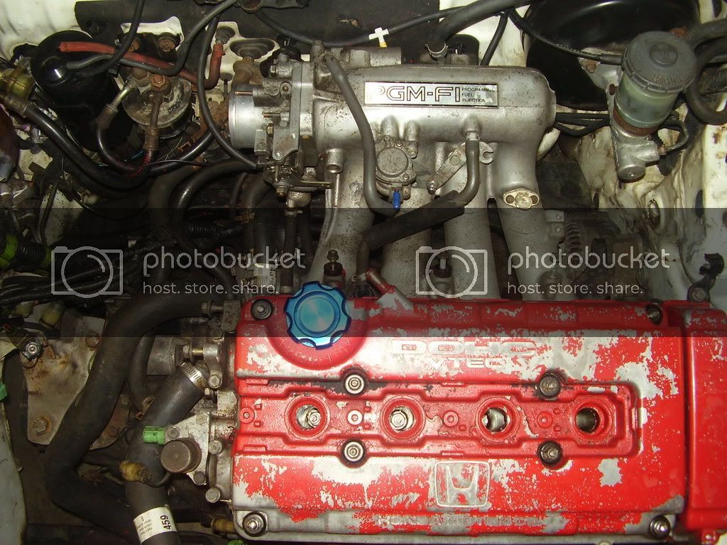

    pics and (little) progress
    first, thank you blanco for your help and advice.

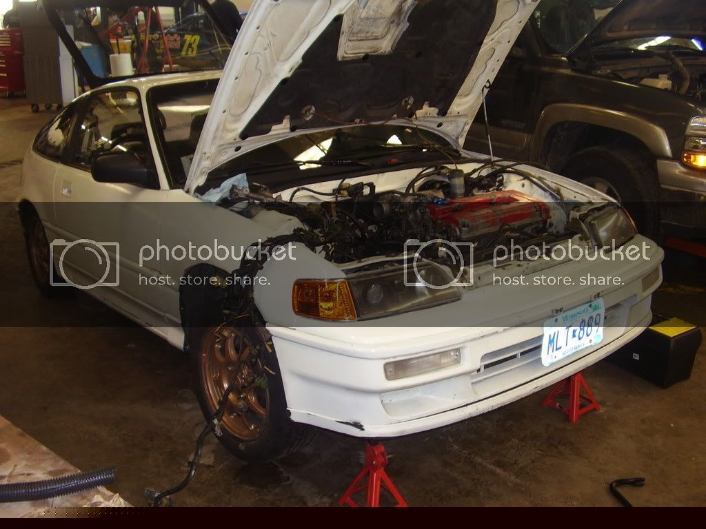

    well I thought I would have had the engine out today but not the case I am having trouble removing the axles from the tranny to lift out the engine, tomorrow I will try and remove the castle nuts from the outside of the axles and see if that helps.
    started by removing the harness, I couldn't figure out the injector clips without breaking something so I took out the fuel rail and left the injectors connected to the harness.
    I noticed I was missing a spacer for the fuel rail, I'm wondering now if that was starving my #1 injector and causing the miss I have been chasing since I bought the car.
    after I unhooked the whole wire harness, I put it up on jackstands to fit the tray to drain the coolant, and unhooked to speedometer cable.
    ran out of card for the rest of the day cuz the wife used my camera and didn't tell me, right now everything (except the axles) is unhooked and the engine is hanging from the hoist.
    more tomorrow and I hope the engine is out without breaking anything.

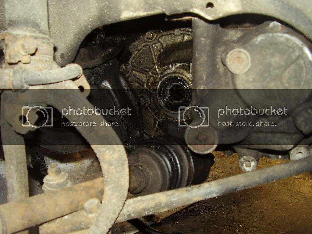

    I thought the castle nuts held the axle into the hubs, do I need to do something different?
  4. hatukazi
    hatukazi ambitious...but rubbish
    508
    6
    Jan 1, 2007
    Big Lake, MN

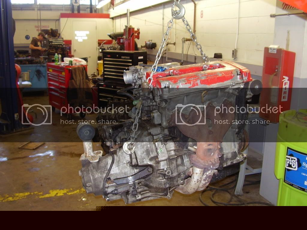

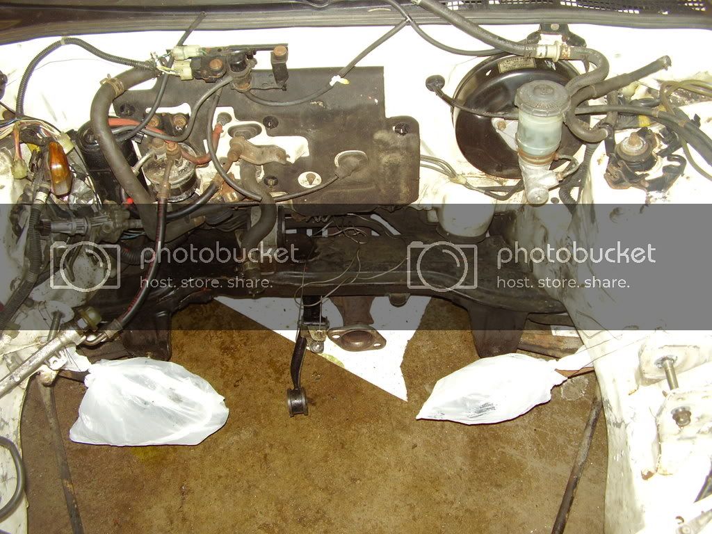

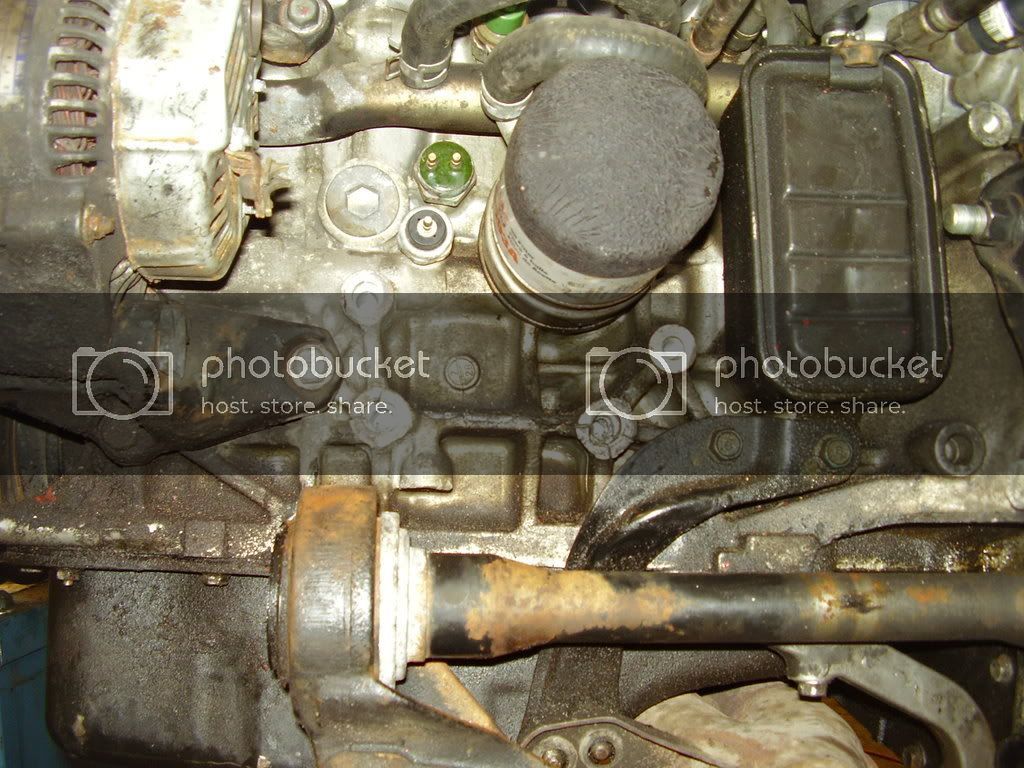

    I was, but your way worked out beautifully.
    so it came out this morning....
    removing the lower control arm worked great for removing the axles.
    and out it comes, just like downtown, without the crowds.
    new problem is the holes for the halfshaft cracked, hopefully I can weld and re-tap them.

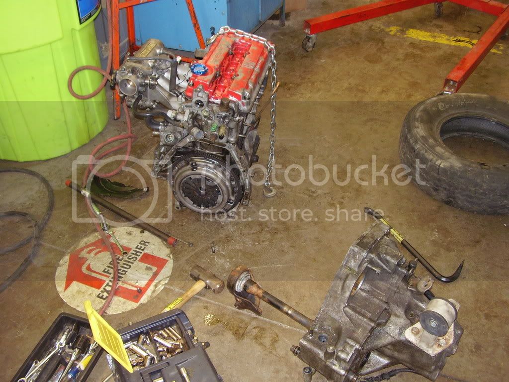

    well, after lunch I went back and worked some more, I also had a pleasant suprise. I found out the gut I bought the car from didn't lie to me about the exedy clutch and light flywheel, so I save some money right there.
    first I wired up my shift linkage and axles to get the car ready to go out side, other people are waiting you know.
    I am getting it ready to put up on the stand now, I seperated the tranny (you have to remove the inspection plate and the exhaust manifold to do that) and took off the clutch disc and pressure plate.
    that's as far as I got today because I needed to buy a socket to take the flywheel off, more tomorrow.

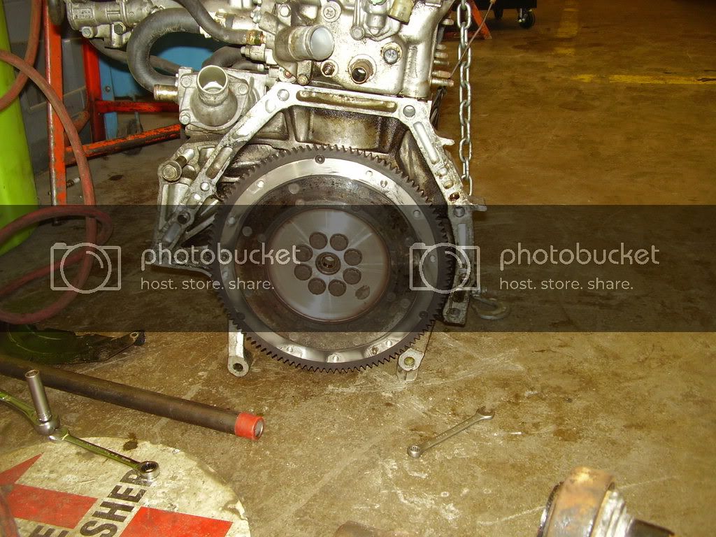

    my dad saw the pics and he said my flywheel looked like toast too, I didn't get pics of it but my clutch disc looks a little glazed in a couple spots I thought it was normal use because I never had problems with it.
    I dont want to put it back in if it's messed up though.

    I didn't get much done today because I felt like crap, got whatever the kids had last week, also forgot my camera. all I did was take off the flywheel and intake and put it up on the stand.

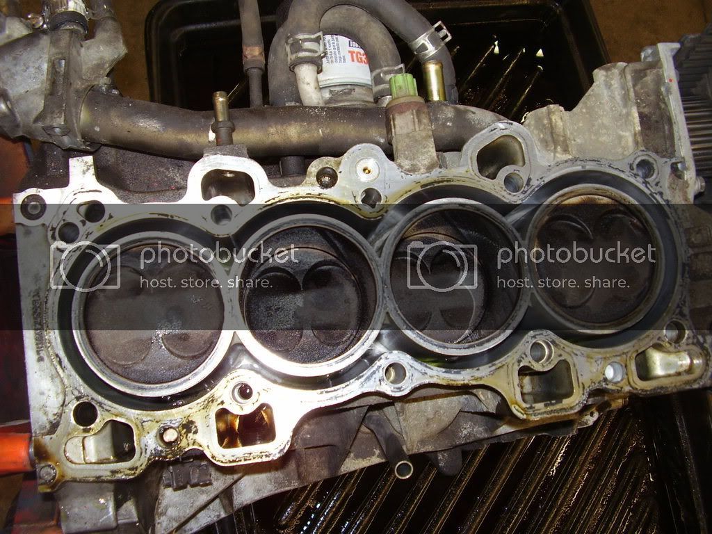

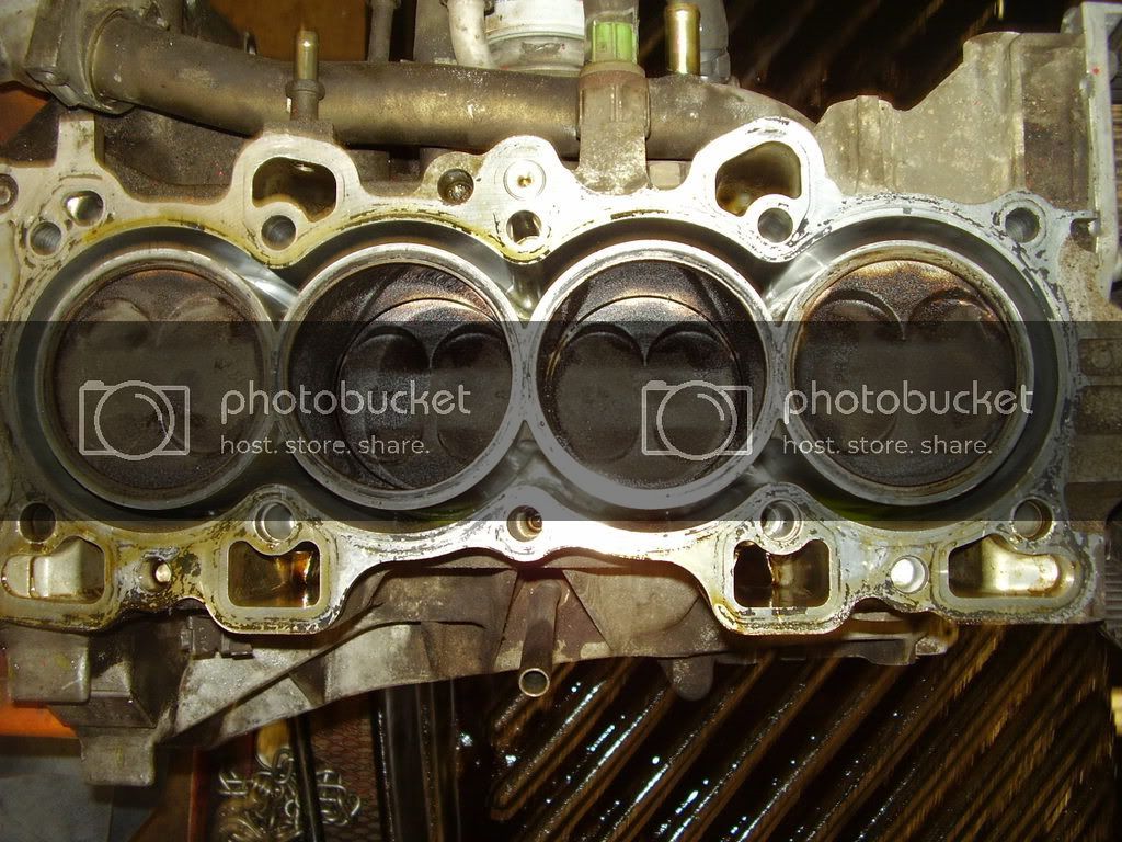

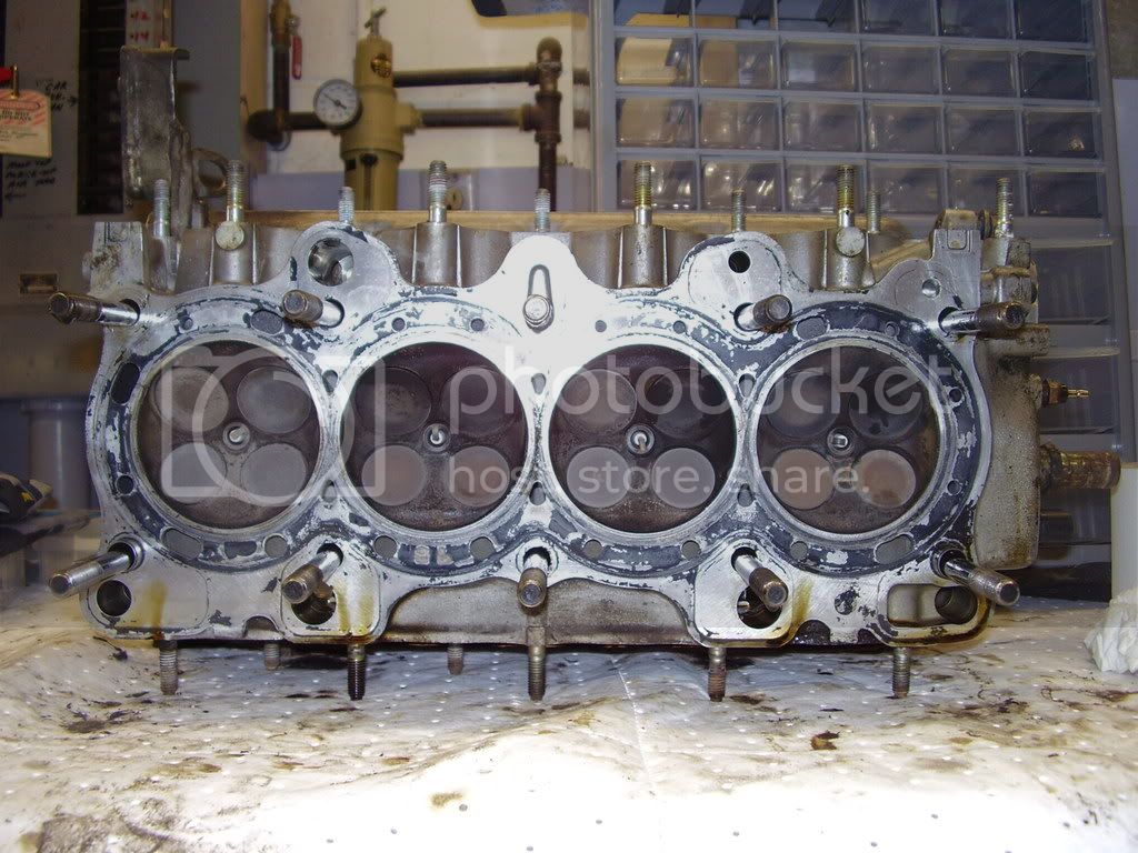

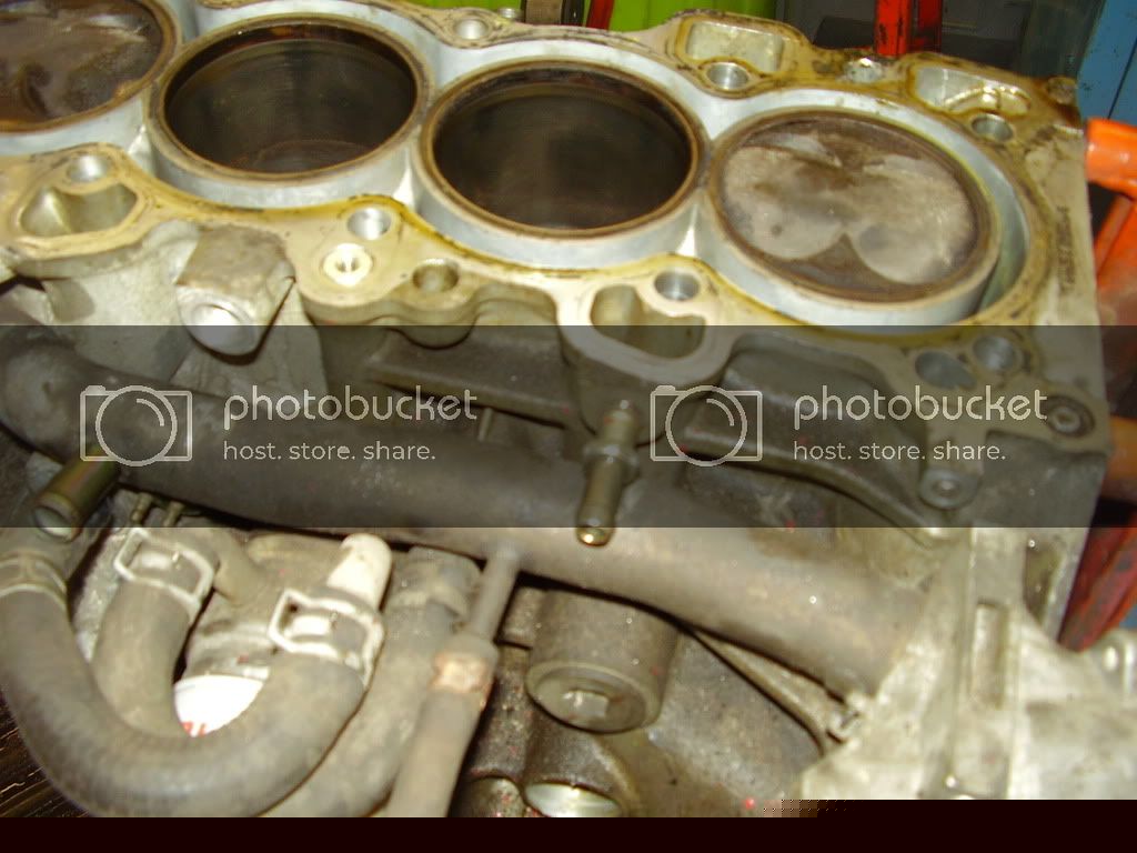

    the "ear" behind my pass. wheel is bent, so I put the stands on the next best solid spot I could find. at least I knew it wouldn't fall on me, it was a little hard to navigate the hoist around them though.
    anyway I made a little progress today, the head is off and it doesn't loook like my valves are bent (I was worried).
    keeping everything in order makes for easier re-assembly later.
    you have to remove the knock sensor and a coolant fitting to remove the thermoststat housing.
    here is how the pistons are looking, not too much carbon buildup but the pattern isnt even, dont know if it means anything.
    also I didn't see anywhere the head gasket was burned through, it looked OK.
