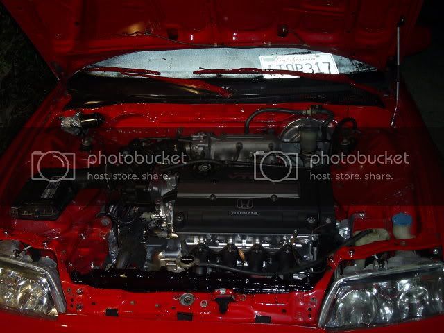

Here's a pic for you to see what I got done during the build
This isn't the most current pic. The intake is back on, with the hose going from the VC to the intake pipe.The brake booster hose is in place, the fuel return line is installed, and there is a "t" between the fpr and intake mani going to the thing on the firewall, because that's what the picture I'm looking at is drawn. I'm trying to track down some good pics of ef/ed's with the same setup so I can compare.
Make sure you have the firing order right, good plugs and wires, and the timing set correct. Very clean swap. It looks almost like mine:cool:
