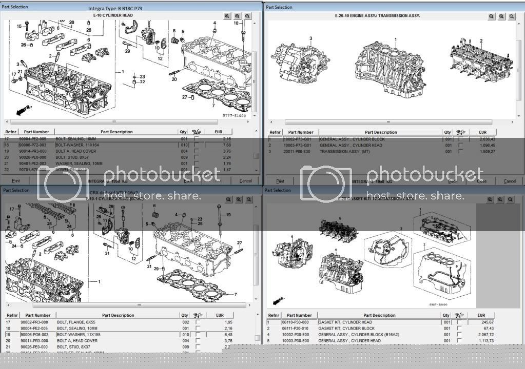

    Did some checking with the EPC but i'm not sure the B18C it shows is the type-r engine i think it's the US GSR version which should be different from the faster Type-R.
