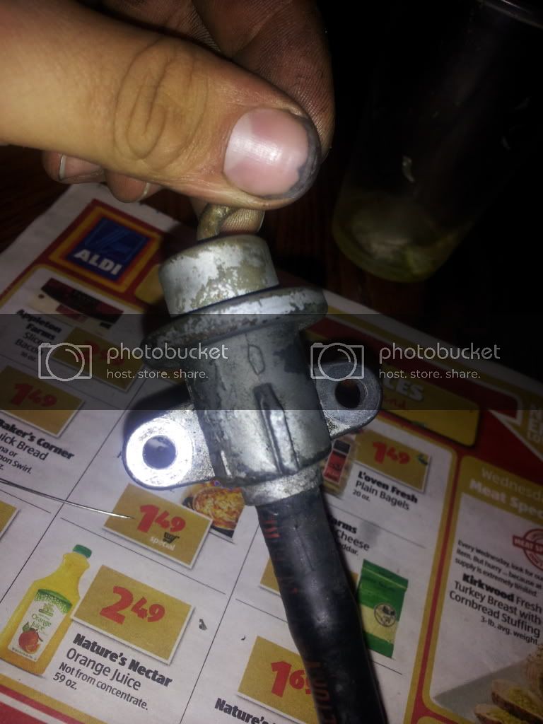

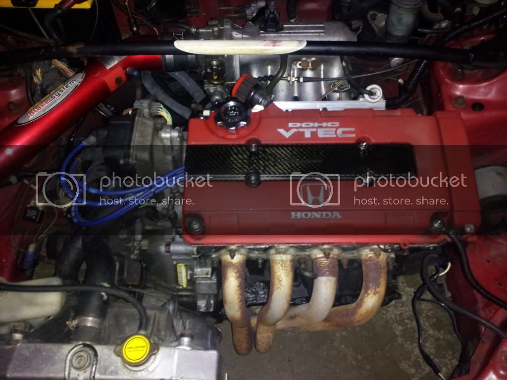

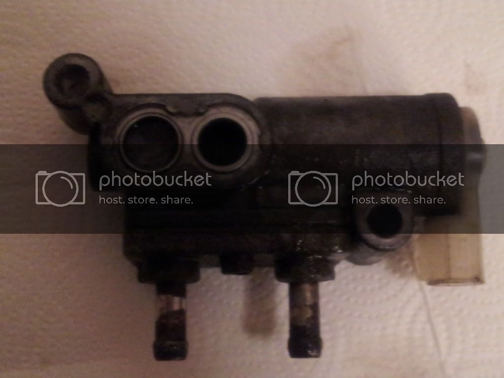

    things i fixed on my car
    [​IMG][​IMG][​IMG][​IMG]
  18. AddictedJDM
    AddictedJDM New Member
    30
    Nov 30, 2011
    Chicago, IL
    What I have replaced and still nothing
    Dist rotor and cap
    Fuel injectors
    Fuel regulator
    Tps
    Changed p30 to p28
    New battery
    Cleaned pvc
    Cleaned iacv
    What else should i check?
  19. wikedeye
    wikedeye Well-Known Member
    1,772
    57
    Dec 14, 2006
    Savannah, Ga.
    Have you checked the timing? Have you checked the idle screw? The IACV looks extremely dirty and could be bad even if you cleaned it. Have you battery tested the IACV? Have you replaced the fuel filter? Have you checked the spark plugs and wires? Have you check the fuel pressure? What is the compression?
