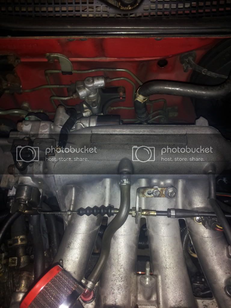

And that is not a USDM B16 manifold. Looks like OBD1 JDM. I owned both at one point. It would have a threaded hole in that metal tab on the back driver's side of the intake manifold. Its to mount the evap purge solenoid (which I am guessing what your miscellaneous vacuum line)
no engine lights on and i know i should have replaced the im gasket my bad rookie mistake. Now that would cause the car to die?... i thought it would idle funny. im going to take the im off again and replace the gasket. whats the wiring diagram for all the sensors by the im because alot of them have the same clip. im just putting guesses out there but this car is really starting to piss me off.. ha but i love working on it. also im going to check for that hole CAFROG was talking about tonight i will keep you guys posted
I am pretty sure that if you had any of the connectors plugged into the wrong spots then you would get a t least one cel. The hole is not there. We can clearly see it in the pic. I don't know if that will cause a problem though. I have the same manifold and I have never used the charcoal canister. I took the whole charcoal system out of my car and I am not using the evap purge solenoid. I would start by changing the gasket then just double check all the vacuum lines.
I see now. If its a jdm ecu then there is no need for a evap purge.
But usdm ecu looks for it.
