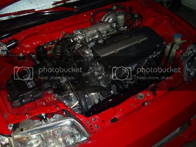

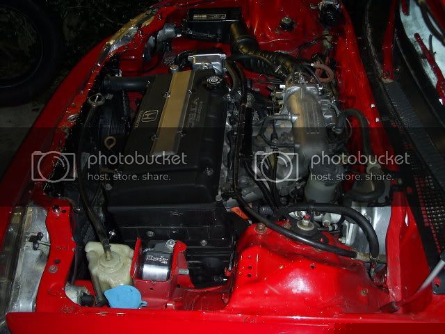

    Here are just a few pics. I rather wait until it's running to add more pics because right now as far as I'm concerned it's just a fucking lemon.

    I think its the dizzy. Can you tell us how you checked for spark?
