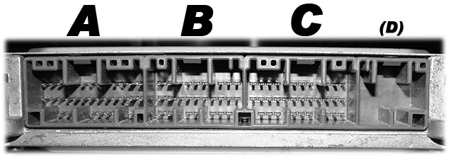

ok well now that i have that side of the wiring down.. whats with the obd2a, and odb2b ecus? and how do u differ between them?
the ecu plugs are diffence and ecu are diffence year honda
obd2a
obd2b
also the major difference is on obd2b there are more emmissions programmed into it obd2a is easier but overall best thing is for you to find a p30 or a p28 or even a obd1 ecu that is chipped to run your program. not saying that p28 is plug and play you need to get it chipped and tuned also. the p30 is meant for a dohc.
everything is a direct bolt on.. just swap it over.. and get a piggy back obd2a-obd2b harness.. and youre set..
