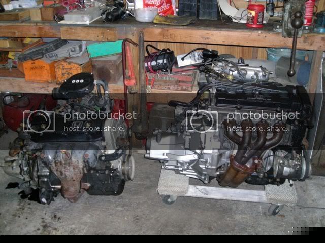

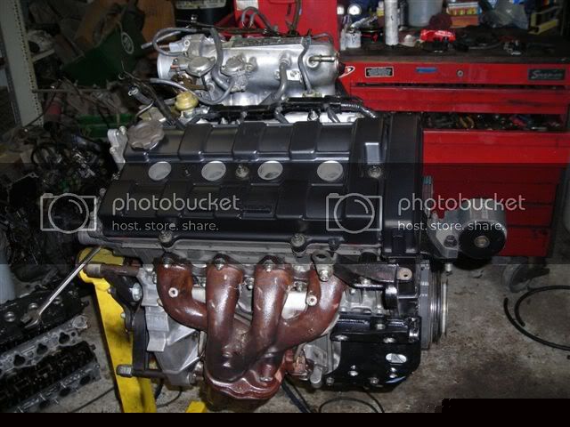

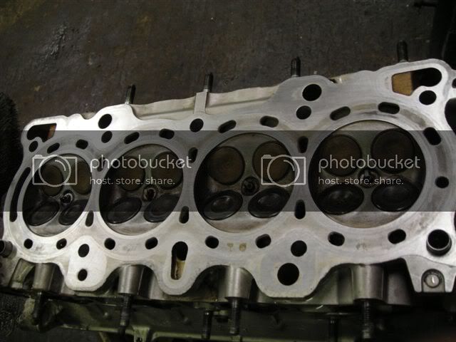

    Tore down the swap engine. I'ts as i suspected, the head is much younger than the bottom end.
    The head passed the gasoline test with flying colors, this one will only get a quick lapping-job and new stem seals [​IMG]

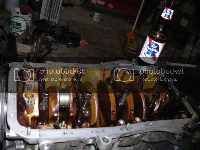

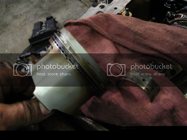

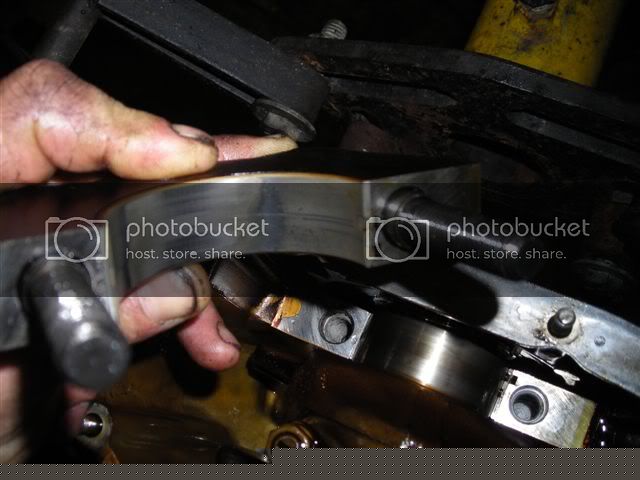

    Rods and mains are original,standard diameter, but well due for replacement.
    pistons are far cleaner than the ones in the d15 I just did for the wife's car. Oil control rings are stuck some, but other than that no problems.
    I was waiting to tear it down to see whether to order the $200+ oil pump... ordering it tomorrow.

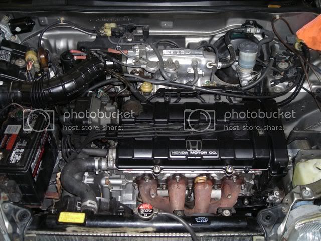

    In my expert opinion, this engine was well cared for early on, then was driven into the ground by a subsequent owner. The new head, new Honda timing belt, new water pump etc... [​IMG] Anyway, with the evidence of heat and early stages of bearing failure, I figure the oil pump has the same scars. At least the journals are all standard, just rings and bearing inserts to do there.

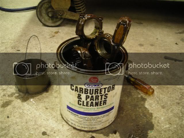

    The easy way to clean pistons:
    And the funny thing is that all 4 fit in a one gallon can [​IMG]
    Leave them in overnight and just rinse with water...voila!

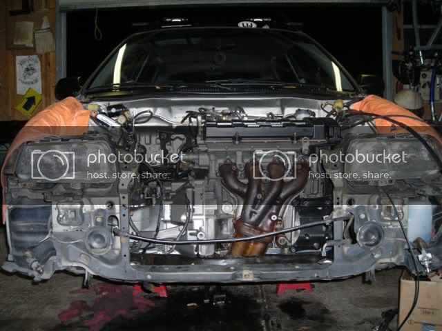

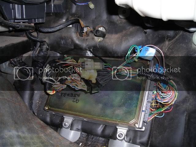

    Thanks, guys. Made some progress today...
    Next I have to fab up a shift linkage, exhaust, intake, blahblahblah
    oh, still gotta do the mpfi wiring at the ecu, too.

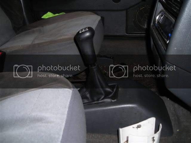

    Had a family reunion today, couldn't get started on the car 'til late afternoon. Took the shifter off the teg, shortened the linkages, swapped over all my new bushings and boots from the OE shifter.
    3 3/8 " shorter with the Hasport mounts.
    Even used the teg stick and knob...a bit shorter and swept back more. I think I'll like it ok, if not I'll switch back
    shifts good, now on to the exhaust...

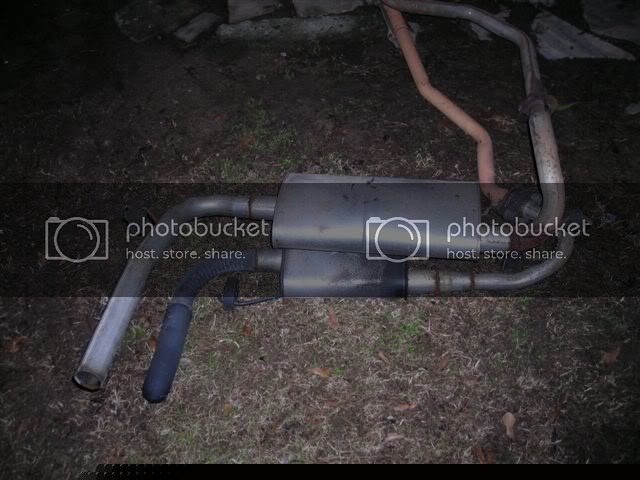

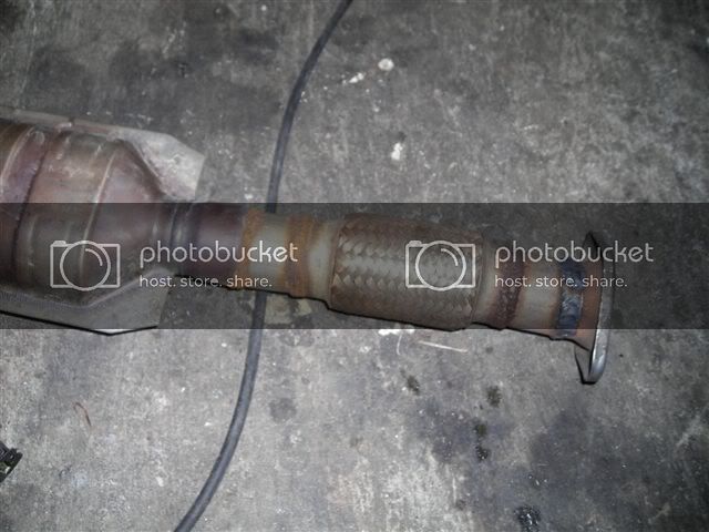

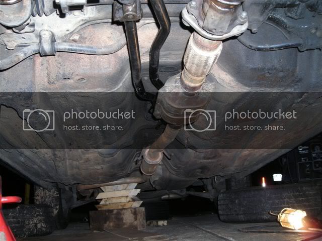

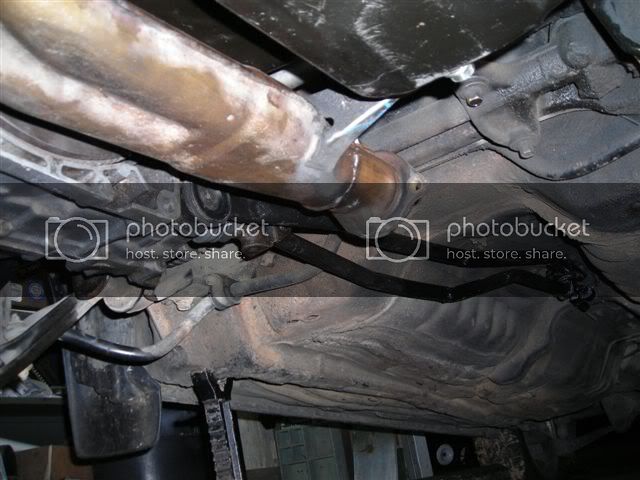

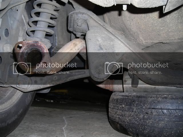

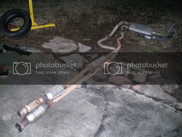

    Do you see what I see? Wagon exhaust on bottom, Integra on top:
    I'm sure this has been done before, right? I was checking out the exhaust from the integra to see if I could piece something together- looks like it'll almost fit!
    The teg was welded straight, didn't have a flange from the A pipe to the cat. Cut the one from the wagon, did some mockup- voila!
    decided to leave that flex coupler in, needed the length anyway. The tough part is doing all this with just one pair of hands [​IMG] wish there was a fellow enthusiast in the neighborhood!
    Note the piles of lumber [​IMG]
    So now I've got the pipe run back to the rear axle. I THINK all I have to do is "flip" the muffler (cut the welds and reverse the offset inlet pipe). That will allow me the length I need to hit the axle-back flange and the ability to tweak the fit thru the lca 'window'. Not a custom hotrod system, but included in the $550 I paid for the swap car [​IMG]
