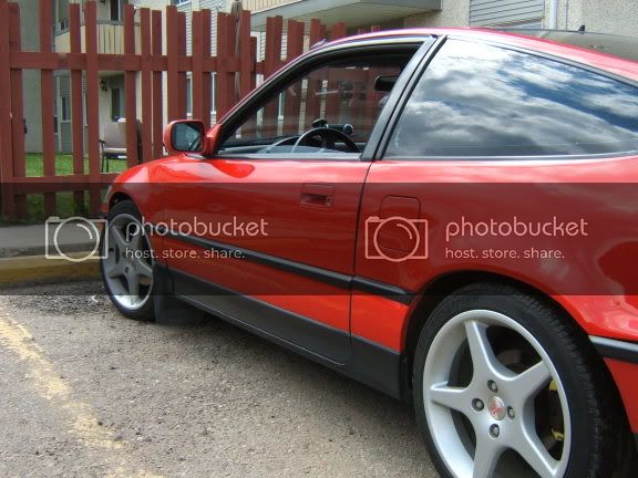

the whells are tooo big?!?!
lol i think the rims make the car look twice as good as before...they fill the wheel wells alot better than the 16" inch rims from before --->

Awesome!!!! anyway. as far as the wheels. 15's are my favorite. you can put anytire and still have cleareance. 17's/18's are just for show. anything bigger than a b16 and those tires are toast.

Don't go spending almost 5k on a turbo kit. You could piece together a much, MUCH better one for less. But if your set on buying a kit then make it one from full-race. They are by far the best pre-made kits. And as far as tires, I thing the 17s are too big. Get 15s or 16s and your suspension will help them fill the wheelwells. As far as low pro goes, hell no. You'll be looking at drag radials.

My advice to you. Take it to a shop that specializes in swaps, tell them you want a k20a, or even a k24 with a k20 head on it, and a turbo. Tell them you know nothing about cars, but want it to be fast. This is the most rediculous post I've seen in a while. You will hate yourself in a year if you spend 20k on a crx, guaranteed. Just my .02, it's your money. If I had a crx, I would drop in a turbo b16 with a jdm type R transmission, and spend a bit on suspension, and GET RID OF THOSE HUGE WHEELS.

As for your wheels. I could care less how they look. I wasn't telling you to pull them off because they look bad, although I don't think they look particularly good. To me it looks like your car has a lift kit on it. I was saying to pull them, because if you are going for speed, you want to reduce the unsprung mass of your vehicle, and large diameter rims slow you down. A little thing called Moment of Inertia.
