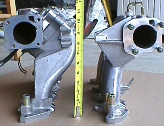

The b18c1 (gsr/sir-g) uses the unique manifold with the IAB butterflies in the runners. The victorX is styled after the ITR/b16 intake manifolds, and thus, the throttle cable mount point is different.
gsr on left, itr on right.
