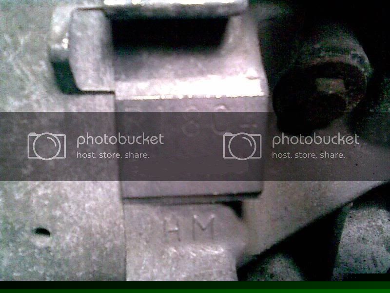

    Is that the old picture I posted years ago?
    Yea the B18C4 was in the Civic VTi in Europe, my buddy had one. It's a GSR engine in a Civic late 90's.
