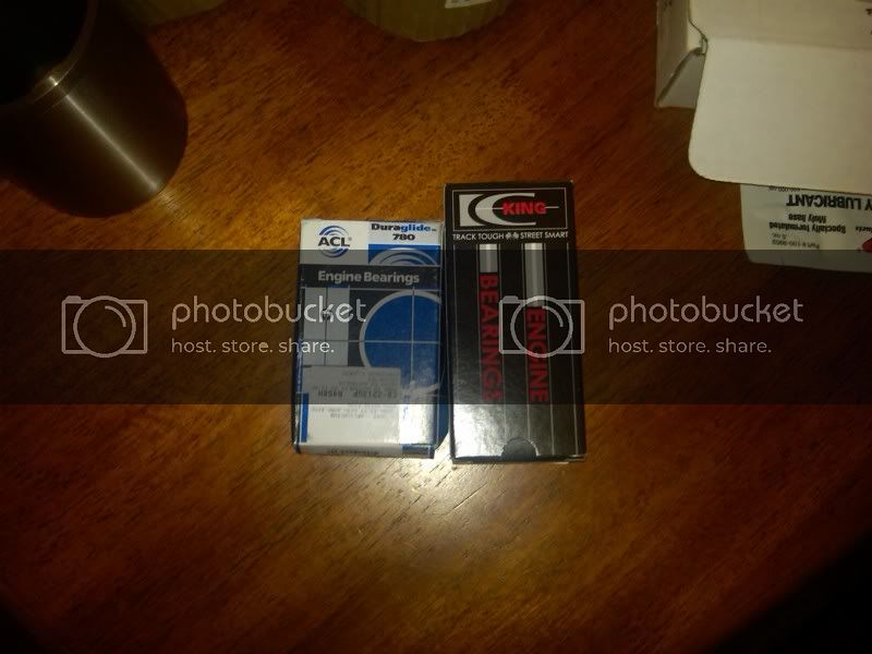

    The b20 blocks are fine for all motor as long as the setup is tuned properly. The problems start when boost is applied, the thin oem sleeves are a weak point with the increased cyl pressures of forced induction. I cracked sleeves in my b20vtec setup with stock sleeves bored to 84.5mm. Everything was fine for years with a low boost supercharger setup (which is more pressure than your all motor setup will put on things), but when I went turbo and started making more serious power it couldn't handle it. Plenty people making over 200whp with all motor setups and have no problems with the bottom end. ARP head studs, aftermarket pistons and rods, new bearings, and a good tune... no worries.

    ok i forgot to install a new bearing.. thanks mate

    1) balanced crank, good rod, crank and head bolts (like ARP)
    2) new rod and main bearings (I like OEM)
    3) correct head gasket and conversion done for the Frankenstein.

    I like OEM bearings im also a fan of
    What I used in my build set up on my H22A a while back, motor was sold and the kid that owns it recently dyno'd at 400whp with out issues... But the barrings went in so well and fit like a glove. I would 110% agree with Hondata as well... S300 if you can afford it
