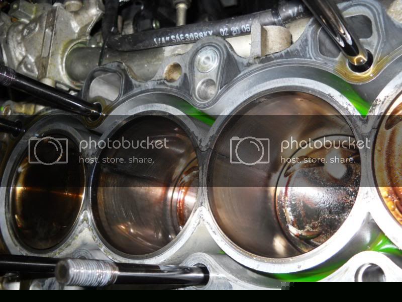

Sounds like you should just stick with the set up you have now for what you are trying to accomplish. I had a stock B20 bottom with a stock B16 head and a Garret T3/T4 set up when I ran into the same problem as mdpsEG. I run a Hondata s300 and I think I had a poor tune. Took it to the and after about 4 runs on about 11psi I was smoking and running hot. Pulled the head and found every sleeve had been cracked. That gave me an excuse to get serious. Pulled the block and had it sleeved with ductile iron, shot peened the stock crank, fitted Wiseco pistons and Eagle H Beam rods (running 8.8:1 comp), new bearings and a block girdle. Used ARP head studs to strap down the head. The head is a stock '99 B16 head with all ITR valve train, except for a CTR intake cam. I put an Edelbrock Victor X manifold with a 70mm throttle body. I also moved up to a Garrett GT3076R and got a wicked manifold. This time got a good tune and pumped out 384hp/296tq at the wheels on 91 octane @ 16psi. I live in AZ so it was tuned "safely" for the hot weather. That was almost 3 years ago. I don't drive it every day (no A/C), but it could be a daily driver. I have been running 109 octane for almost a year now and boosting a little over 20psi on the streets. Still solid.
In conclusion, drive it till you break it. If your going to open up the bottom end, do it right and put sleeves in it. Its gona suck when you put nice pistons and rods in it, run it for a couple months, then find out that you have to rebuild it again. Don't do a block guard. Block guards just keep the cylinders from "walking." It doesn't keep them from cracking. Hope this helps.
