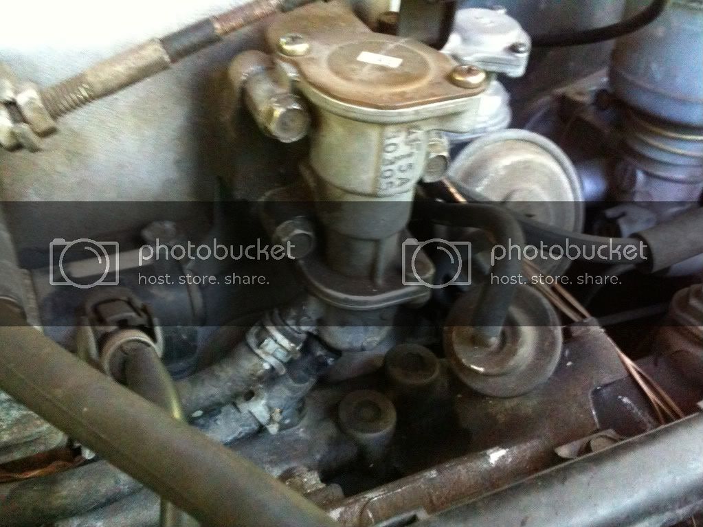

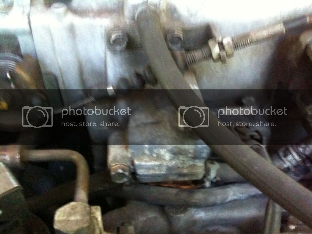

    As you can see it's a 93 2 door accord coupe. I believe it's has a H22A6 w/an auto-tragic trans. It has a roaming idle (or surging if you prefer) that hunts from 1700 -2200 (ish) RPM. I'm betting on it either being the IAC or the TPS. It's my understanding (possibly MIS-understanding) that these cars/engines have 3 IACs and I have no idea where the TPS is hiding. I will include a few pics of what I believe the IACs to be and you guys get to tell me if I'm right or wrong (isn't this fun kids?) Ready??? Lets begin.

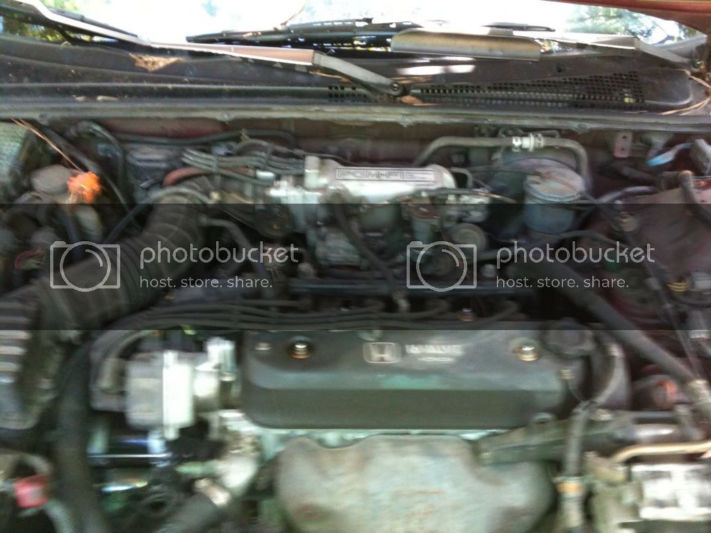

    This is a close up of it upper intake, incase someone can point out where the TPS is located.
    Here is what I believe one of the IACs is located...
    Here's another..

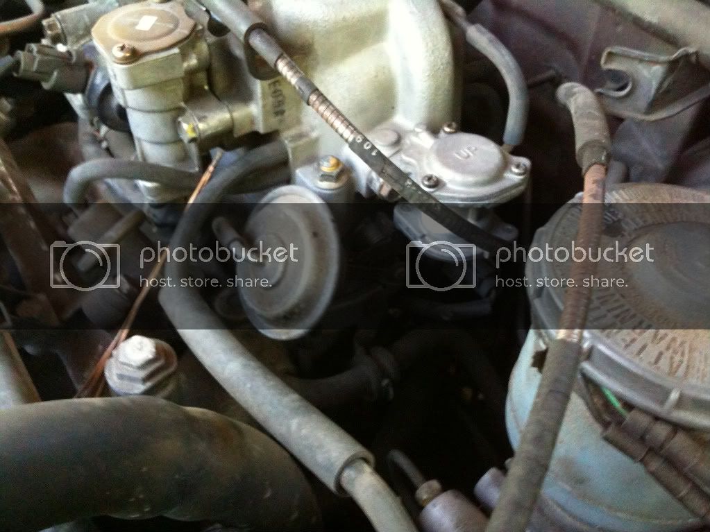

    and frankly, I'm not sure what the hell this is...
    I know one part appears to be something fuel related, but the part that has what appears to be the throttle cable across it... I'm not really sure.

    I'll try and answer these the best I can................ First of all, that looks like a F22A, all H22's are DOHC, and most also VTEC. The TPS is at the back of the throttle body, attached to the throttle spindle which passes all the way through it. The accelorator cable is attached to the spindle at the front. The first IAC (!) is actually the FIT (fast idle thermo) valve. This contains a wax pellet which is heated as the coolant heats up and slowly closes an air passage which provides extra air on start-up. The second IAC is actually the IAC. And in the last picture the diagphram on the left is the throttle pulastion damper and the diagphram on the right is the Starting Air Valve. This supplies additional air when cranking the engine to ease engine starting. Hope this helps somehow.

    Thanks for your answers, F22a it is. For some reason I've H22 stuck in my head. TPS back of throttle body. FIT fast Idle thermo valve, I've done a bit of reading and I can honestly say I understand it's operation (sort of) Clean IAC (which is second picture Thanks a bunch) is there a way to tell on these motors if it's any good (other than cleaning it and it not having changed the condition of the roaming idle) Starting Air Valve, is it possible for either the FIT or the SAV to be malfunctioning causing the erratic idle?

    I replaced both the FITV and the IAC with new components ($$$$$ :( ) and it still had the rolling idle problem. I then loosened the SAV (also known as the Air Boost Valve or ABV) and plugged the hole and voila' idle fixed. So I deleted the SAV and capped off the nipple it attached to on the air hose thus fixing my idle problem. Who'da thunk.... :rimshot:
