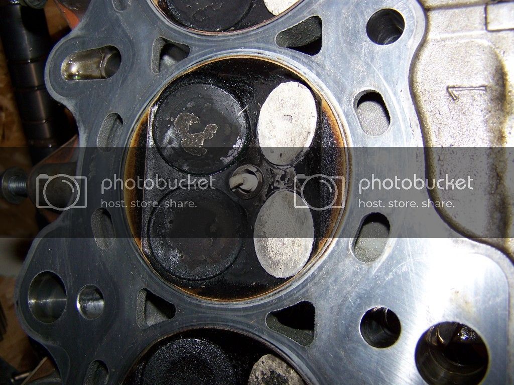

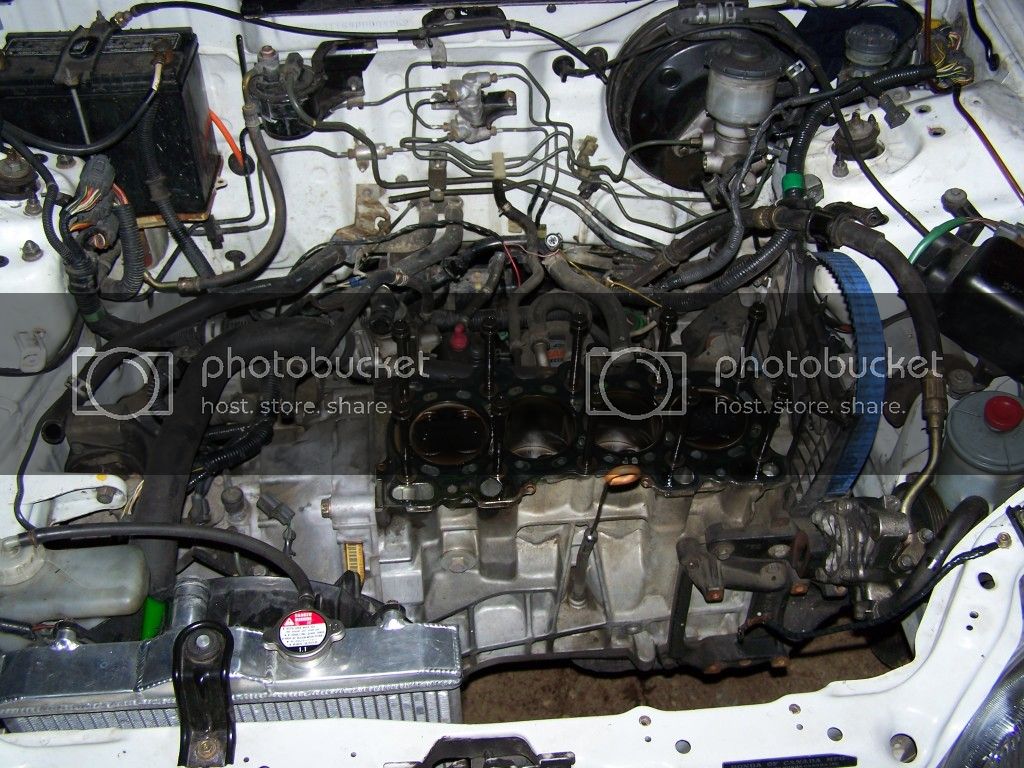

    Alright, my dad and I are thinking I burnt a valve. So the car is getting parked and I'm going to pull the head. Really I should rebuild the thing but I'm on a college budget now :/

    Lol yup. My reasoning for a burnt valve is that I've been open header for a while....my new header has broke in many places and I can't use my exhaust.
    The head should be off tomorrow.

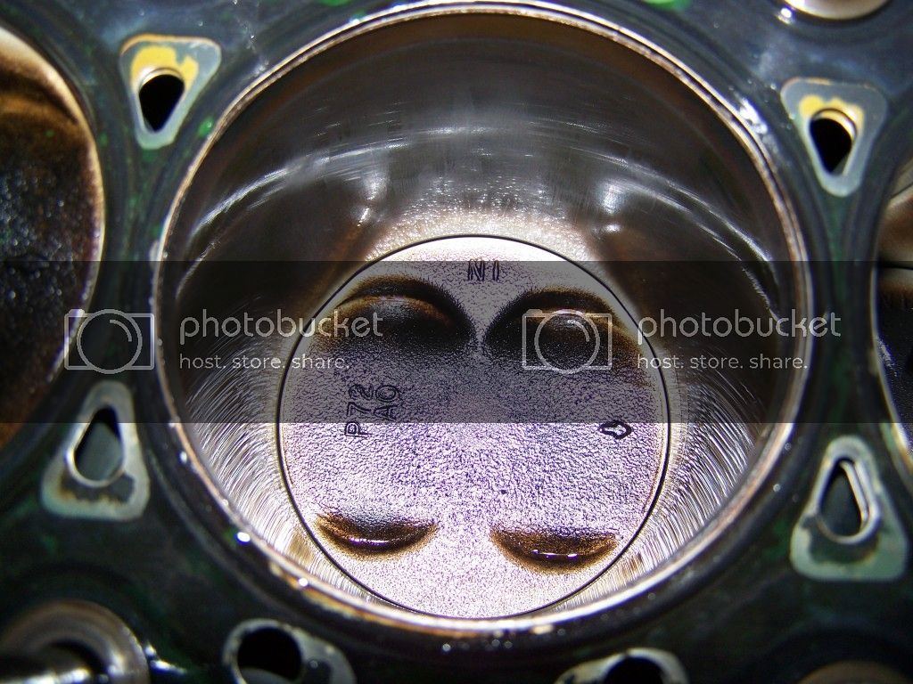

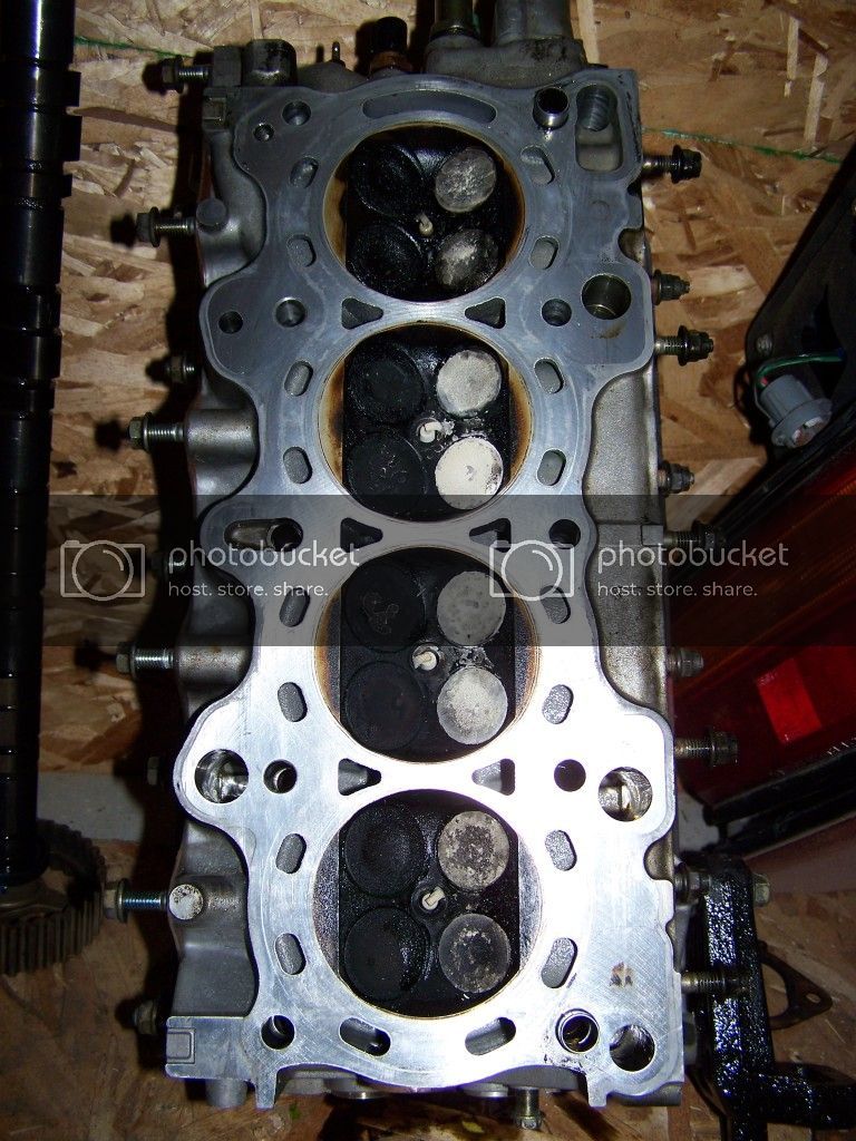

    The valves seem ok but I'll still freshen up the head. The cylinder walls look alright for their age too.

    Brad, so you did the gasoline trick with the head off to ensure the valves are not the compression problem??

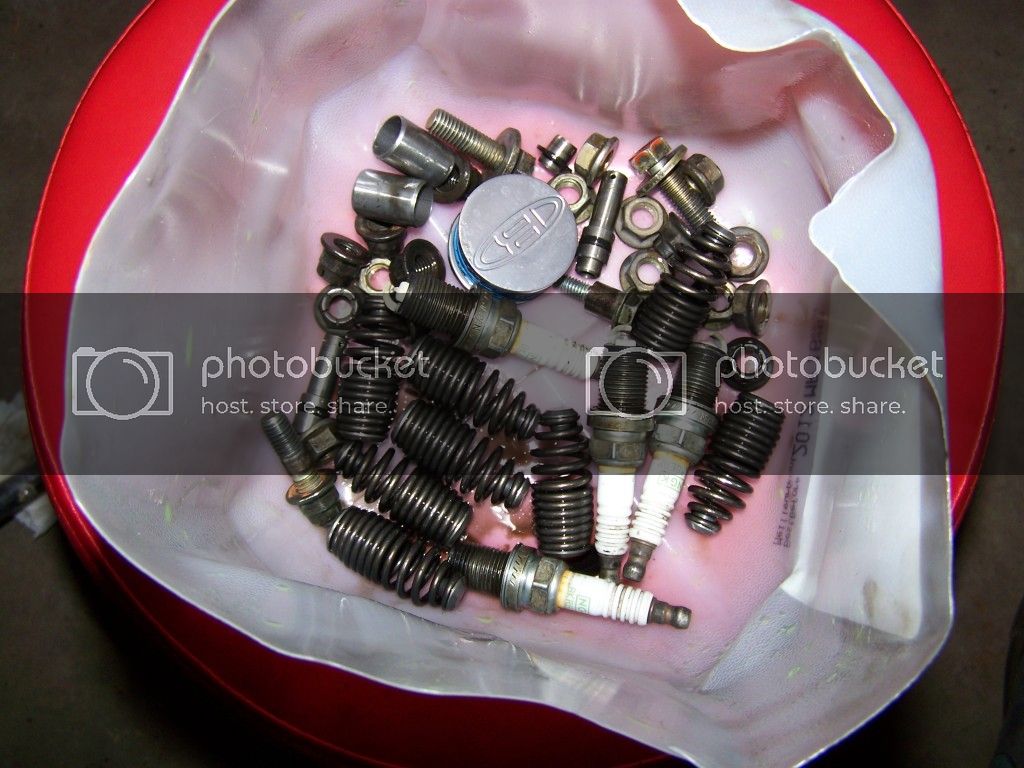

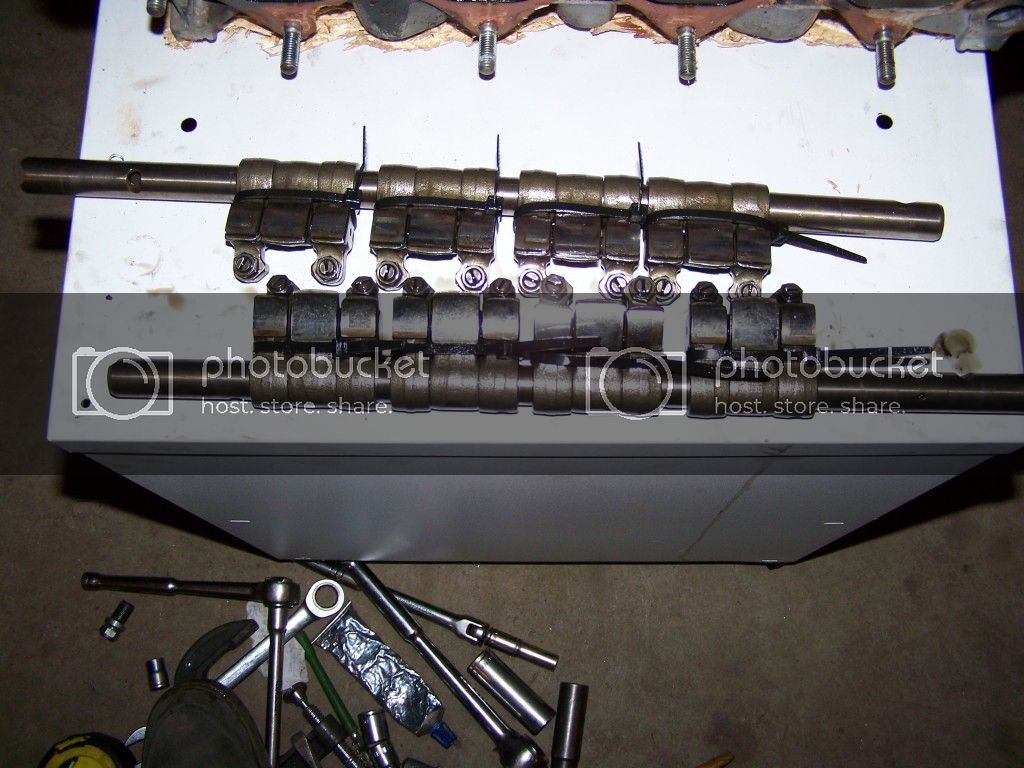

    The head has been completely stripped and ready for the machinist tomorrow. Because of the age I'm going to get it rebuilt anyways. Hot tank, valve grind, valve seals and I might talk to him about porting. I'd like this thing to be a screamer one day.

    Did you check the bottom of the head (deck) with a nice and true metal straight edge?
    Gasoline trick is super old school... when you place the head on a bench upside down (bottom of valves exposed) and pour gas into each dome (cylinder). If they stay the same level....no leak that caused compression. If some disapears....found a problem (like valve seats/job/etc.) Narrows down the culprit :shrug:
