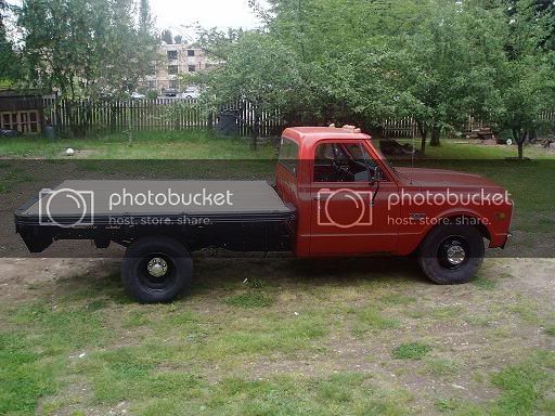

Shop around, I got "Billy Bob", a truck exactly like this one, dually and all, but white:
For 200 bucks. I took the motor/trans out and sold the shell for 200 bucks. Got a free 350 4 bolt main and a turbo 400 trans out of it.
Come to think of it, I still have the motor and trans in my shop, I never used it.
