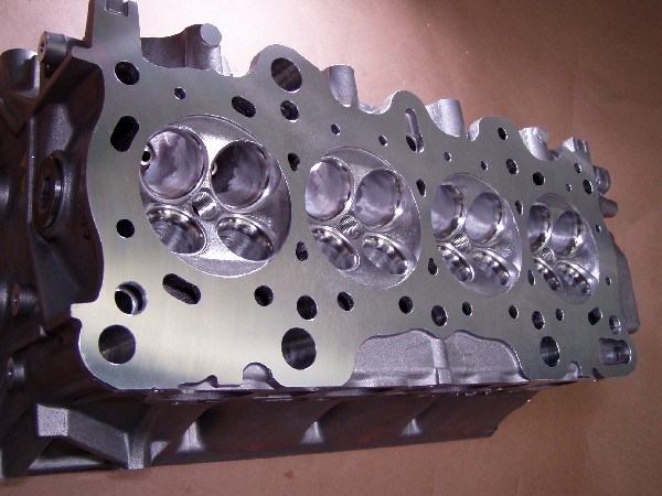

    Here's a pic from Endyn where you can see it well:

    Ahh, I see it now. Thanks for the pic.
