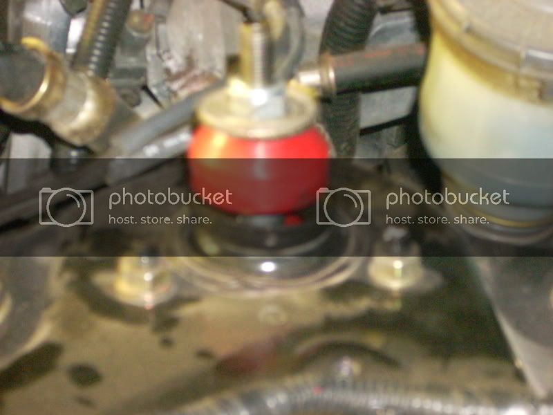

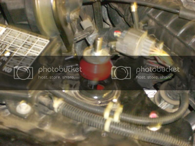

    alright i may be fixing to ask a completely stupid but im having a problem that i can't figure out....
    i just lowered my car with the complete skunk2 lowering spring and sport strut kit, in the front they gave me two polyurethane bushings to use so i did but now im having a major problem with the mount on top, yes the spring is seated correctly i know that for sure, and yes there is a bump stop in there but i can't figure out whats going on! look at the pictures and tell me what i need to do!
    it is like that on both sides....
    any thoughts?

    you have the assembly together wrong , i would suggest a hayes service manual or have it towed to a shop . red part in the wrong place , goes below the upper mount . i assume this is your first spring job . expect to be flammed alot for this

    first on my car with aftermarket suspension, and yes i know about the other one, there was two one is on the bottom of the top mount and the other is where its at in the picture, and i can take the flaming, i just need everyone's input

    Did you install the lower "washer" piece that holds the bushings?

    Did you buy them from skunk2. If so they should have com e with instructions. If not go here...skunk2.com, they have online instructions for most of there parts that you can download. If I new exactly what you bought I could have given you a direct link, but you should be able to find them. I think that the bushing should go inside the plate that sits against the suspension tower, you have yours on the outside.

    well guys we figured out what it was today, and being stupid me and i guess trying to finish quick i missed the washer below the bottom bushing on both sides..... yes yes i know stupid right? lol but all is good and she rides like a dream :)
