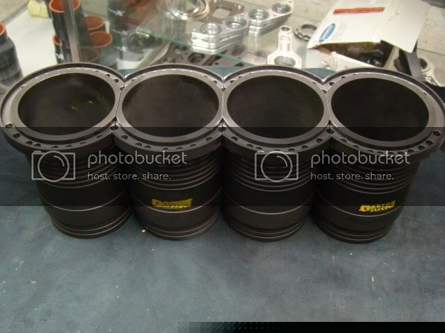

Thanks for the good info, What are the best prices for sleeves? Dartons are the only ones I know of...:huh:
Bensons, golden eagle, JG, and a bunch more do sleeves
Wet sleeves are better better than dry I am guessing?
I WANT!! They are not cheap tho.

I would think it would be cheap and ineffective compared to sleeves. Blox is like the APC of tuning products. You can find Darton Sleeves as low as 200.00 Shipped but if you want to go ahead and spend the money on a guard then I don't think it would really matter if it was Blox or a generic Ebay Block Guard.
most sleeves crack from the center...not from the top... where the rod/stroke angle is at its worst angle pushing sideways on the sleeve.
the block guard only goes on the top, and thus, it blocks water flow, which leads to more heat, detnoation, and doesn't even effect the problem area-- the bottom of the stroke.
