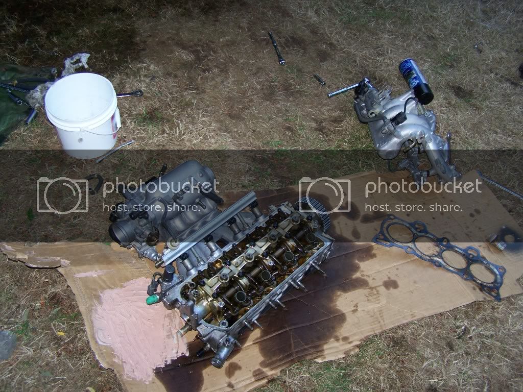

I've pretty much gave up on that Y8 manifold. I put a new gasket on it, I've re-done the mating surface with Devcon then sanded, it's super smooth, and it still leaks bad. I'll probably put a a6 one on back for now until I find a bare y8 manifold.

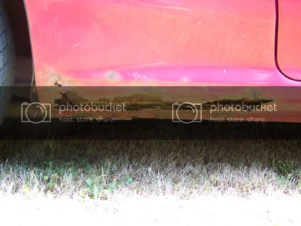

OGMatt is borrowing our Accord for a week so my dad insured the red Si for a little bit, that thing has some balls for a d15b2. The car is going to it's new owner in about 2 weeks so I have to finish up that rust patch, I got a lot done so far. Pics up later.

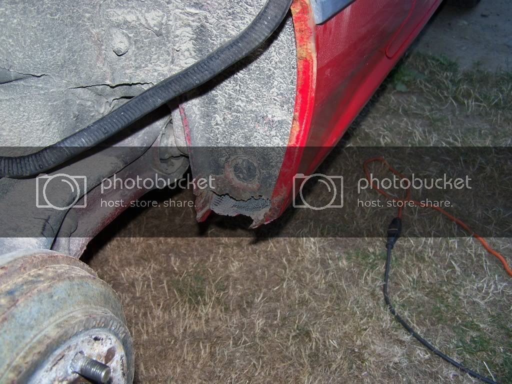

Well depending on the size of the hole, get some metal mesh, as fine as possible but not too fine that you can't form it. Then fold it over a couple of times to create less holes, stick it in said hole to be filled, it's good to apply back force when bondoing over, then sand, and mist WITHOUT tapeing off the area to get a good transition.
Well there aren't too many holes, I'll post pics later, but i'm thinking about respraying my car, just for the learning experience, for when I want to paint the rex. I was thinking about doing the oem teal color with the gold pinstripe, but I don't know about doing the door jams, trunk and engine bay.

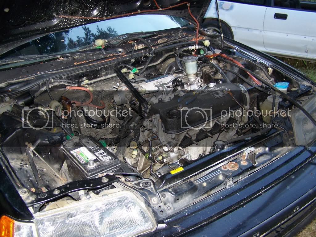

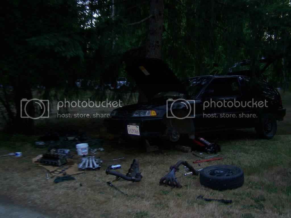

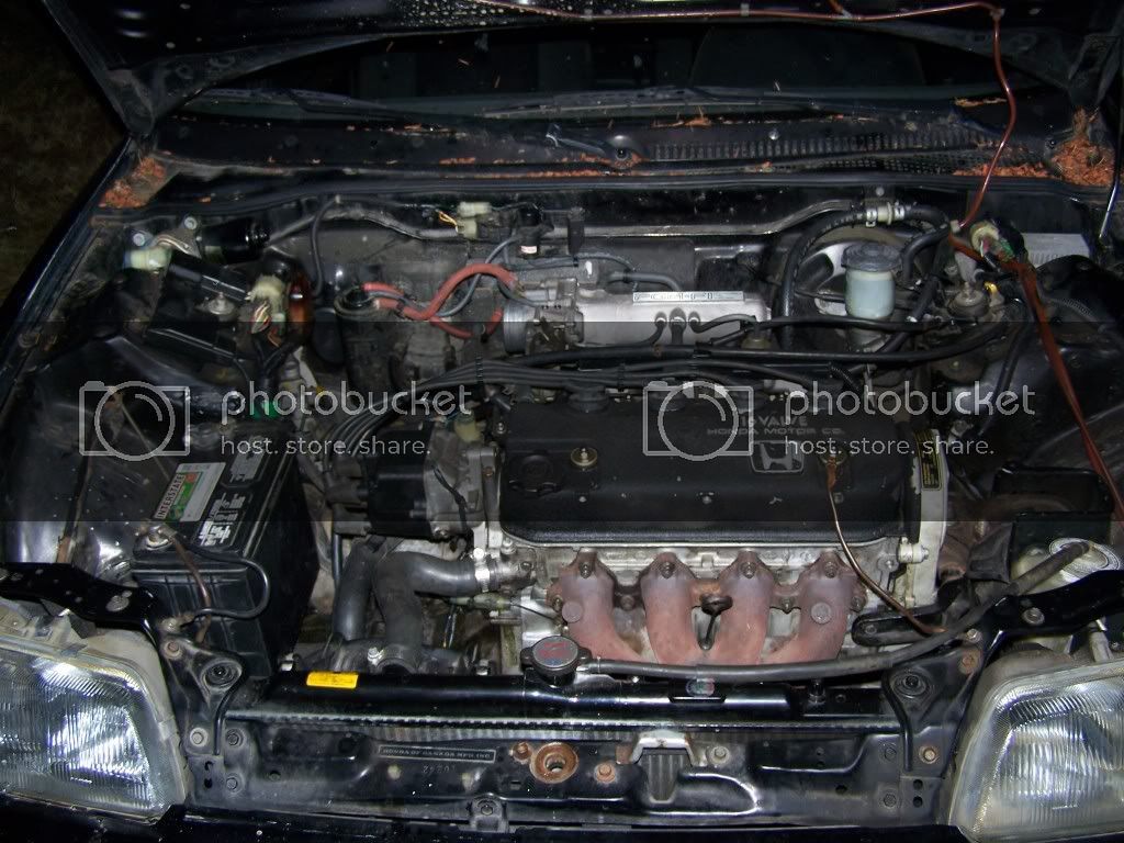

Before I can even TOUCH the CRX I have to sell a EF. So my dad and I have decided to sell the black one. I took my Z6 head and Y8 manifold off of it and put the stock head and parts back on. After that I have to take out the short shifter, swap the tail lights then get the tires balanced. Hopefully done with the black one this week. Pics up sooner or later...

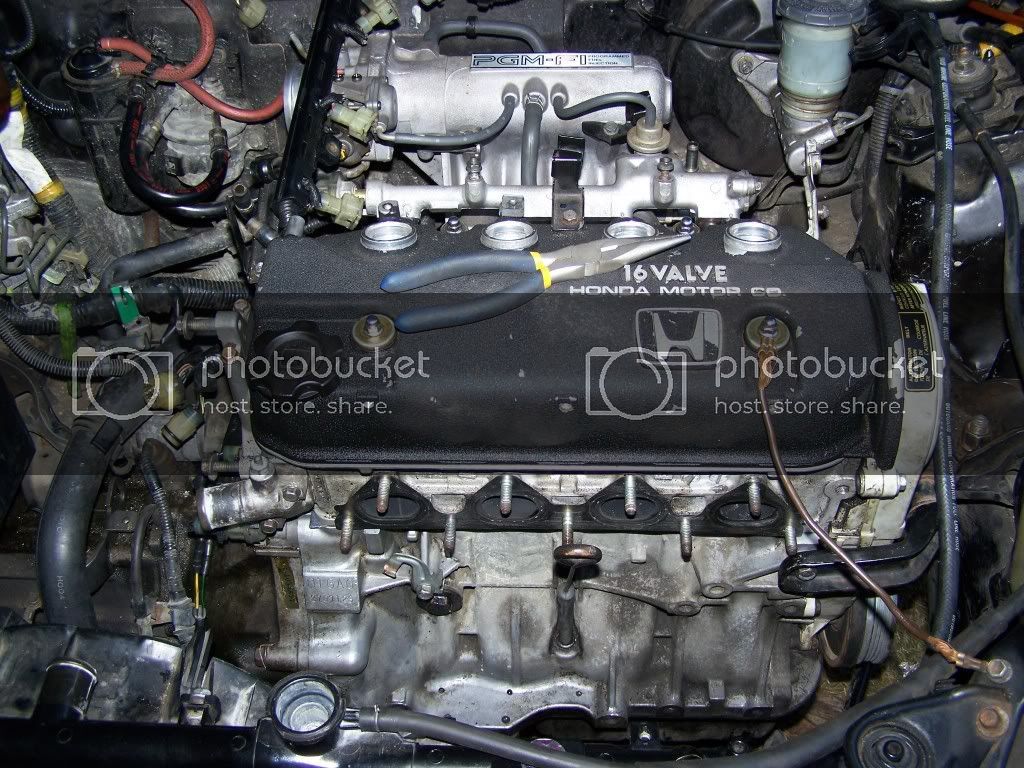

I dialed in the timing and put the intake on, the exhaust is still off because I have to swap the shifters.
Good:
Headgasket sealed great
Runs perfect
Bad:
Burns oil like a mo-fo and idk why
