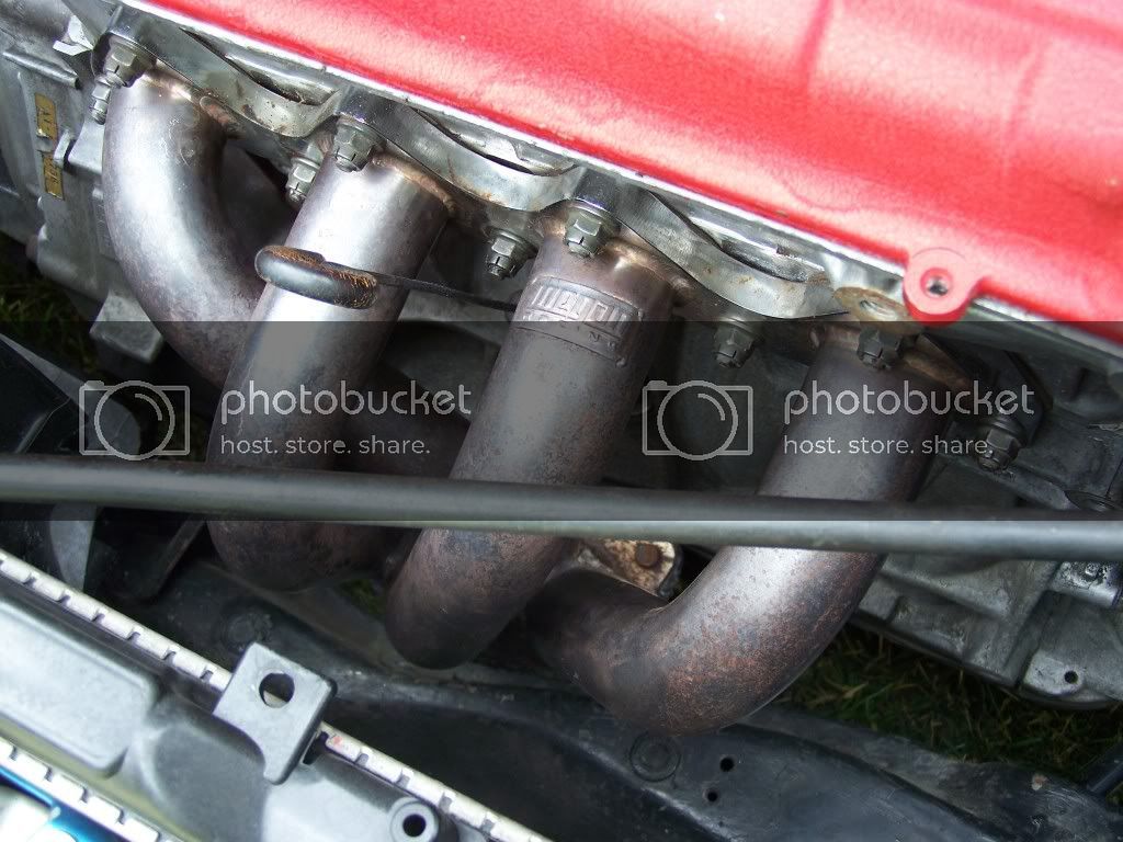

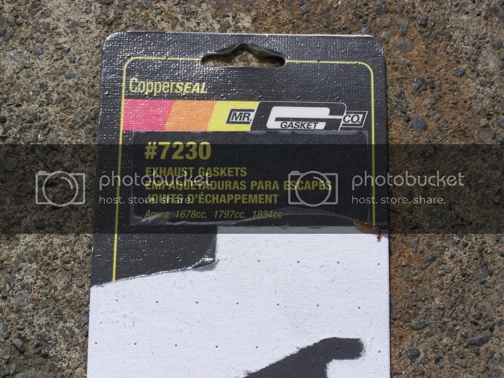

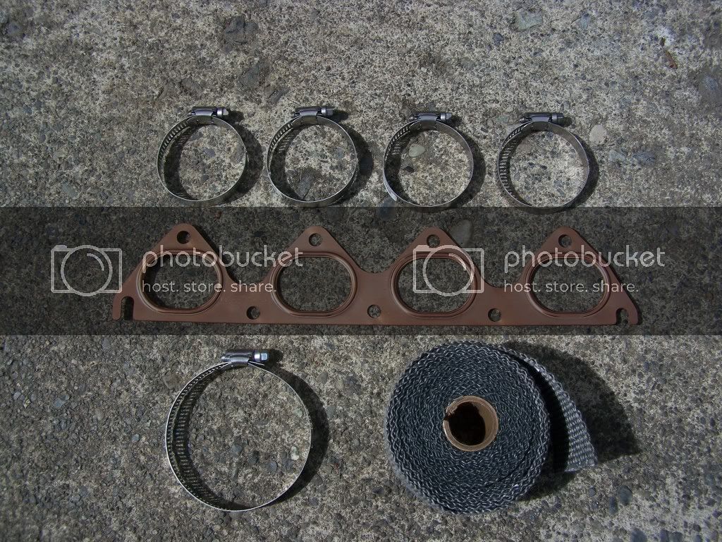

So I found this copper gasket on sale randomly cheaper than OEM so I started a mini project.
OEM gasket underneath. New one is bigger. :)
02 sensor is really clean.

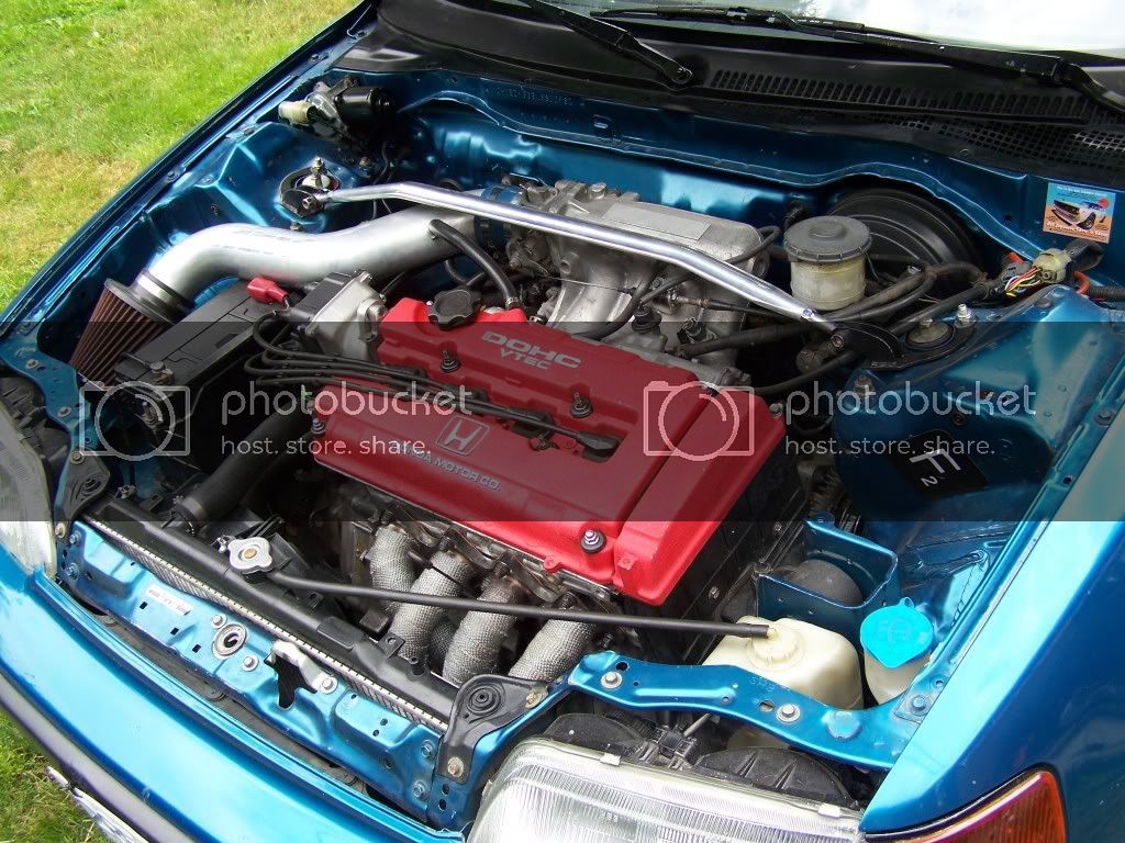

That positive battery terminal in such close proximity to the intake tube concerns me. Would be a good idea to wrap that in the area of the terminal to have insulation on the battery lug and on the tube. Even a couple of layers of electrical tape wrapped about 2" wide would be much better than nothing. Or you could scuff the tube and make an RTV patch 1/4" thick and about 2" square where the terminal is. Or cut a piece of PVC in half, heat with torch or in oven till it's plaible and place on tube to shape it - once cool, glue it to the tube with RTV.
Need a longer piece of tubing to the overflow tank and straped down to chassis.
Put a couple of small wire ties on the plug wires to bundle them.
There, done picking on ya! :)
EDIT: Naw, not done yet. Shitcan the screw type clamps on the radiator hoses and use OEM spring type. They be mo betta.
That's all nitpick stuff - but you are a perfectionist and that's the cleanest shit I can think of.

The terminal is like half an inch away but its fine to me, intake will not move at all. I am planning out a proper battery relocate with a 3" short ram straight intake once the batt is gone. :) I like the overflow hose like that, don't see a downside. :dunno: I want OEM B-Series plug wire tie in's when I get a carbon plug cover cause mine are non-existant with the plug cover. :( Not down for the hose clamps either but B-Series motors use larger diameter rad hoses so it has to be a bitch fit. I like these clamps:
And I am sort of a perfectionist, I sweat the details where I want. I love the wrap too. I would have done the whole thing but ran out of my 50' roll, it was remains from my old D-Series one I gave to my dad. I really like the idea of the thermostat shut down. ;)

On the overflow tube; I think its because it looks out of place and in the way. You did all that work tucking things here and there to keep a clean look, then just put that right in the middle of everything up front. Kinda lame to be honest. :p
