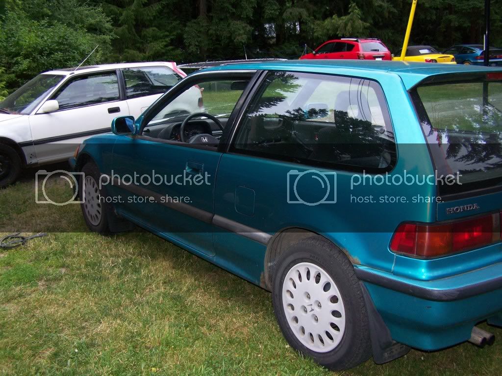

    This thread is for my new DD so I don't drive the CRX all the time - 1991 Tahitian Green Civic Si.
    Cons:
    353,XXX KMS (pretty high)
    One owner (she was a pig and didn't take care of the car)
    It's been very poorly maintained and burns lots of oil (took 3 liters in one day)

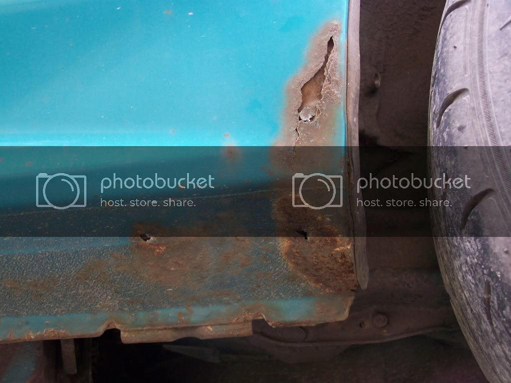

    Came with a EW Civic radiator that was cracked/leaking (put a good one in first day)

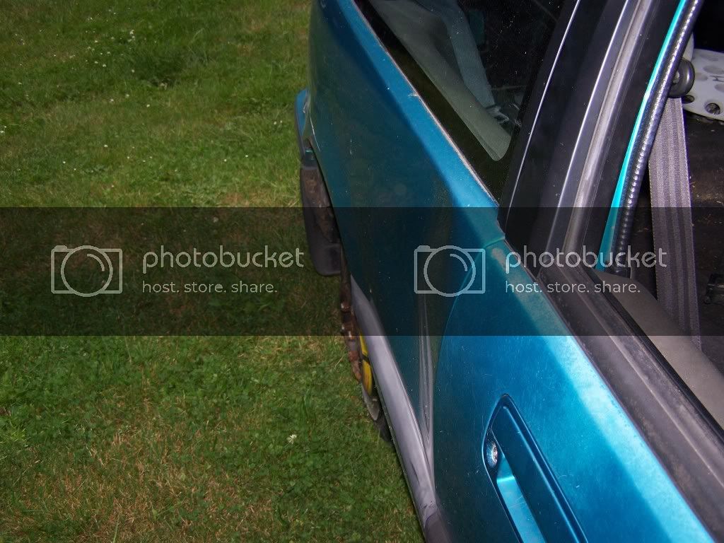

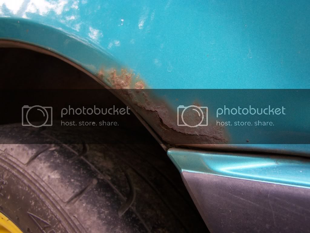

    It's been driven over the BC Rockies lots so the front end is scabbed up pretty bad from rock chips

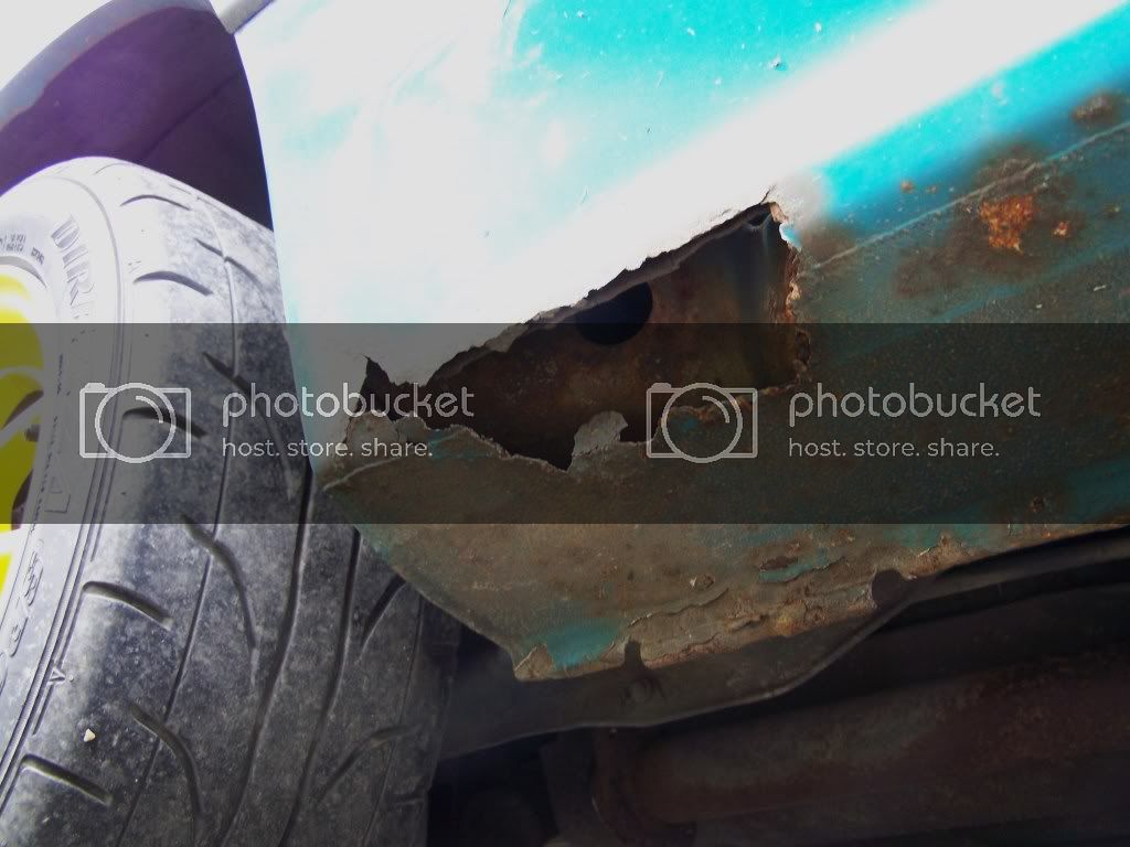

    The wheel wells and rear rockers are rusted out
    The lady smoked a deer and mangled the hood
    Cracked windshield and headlights
    I drove it home with a 185/70/14 on one side, 185/65/14 on the other side and a doughnut on the back
    Cat is badly clogged
    Needs front end and brake work
    The rest of the car is straight and sorta clean. :)

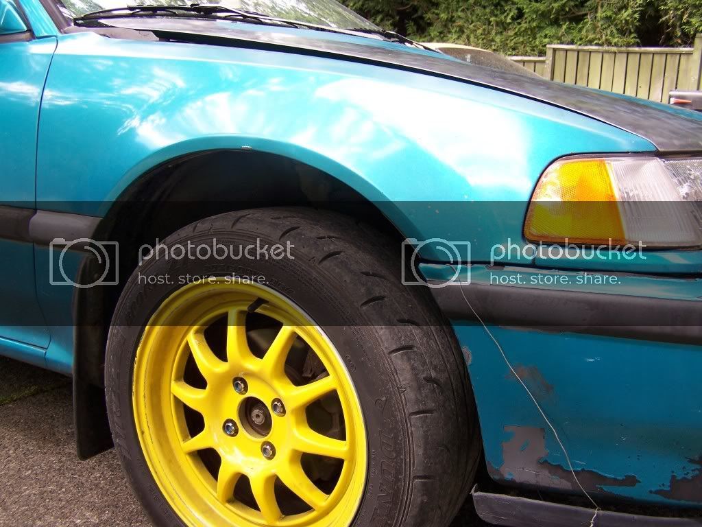

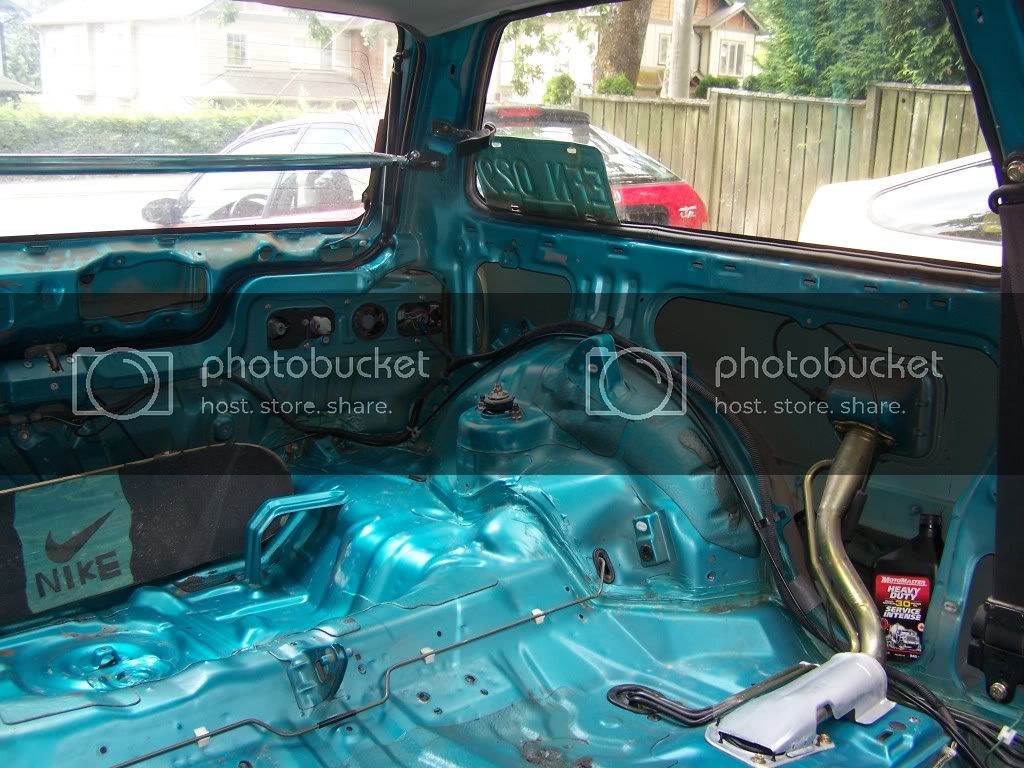

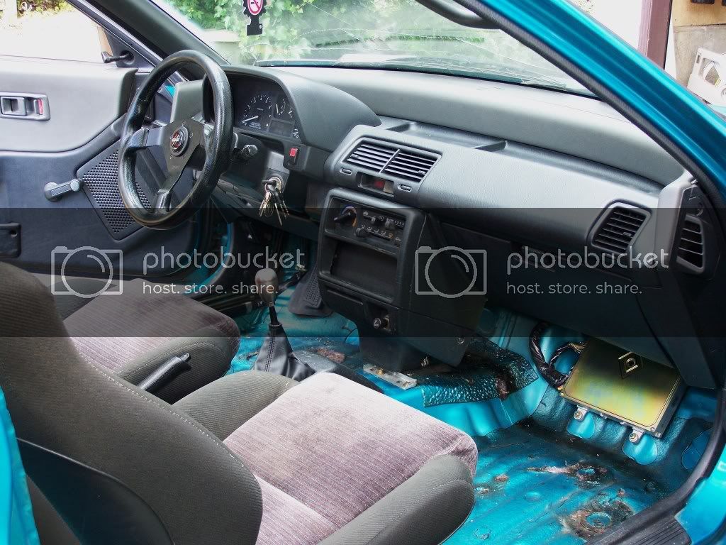

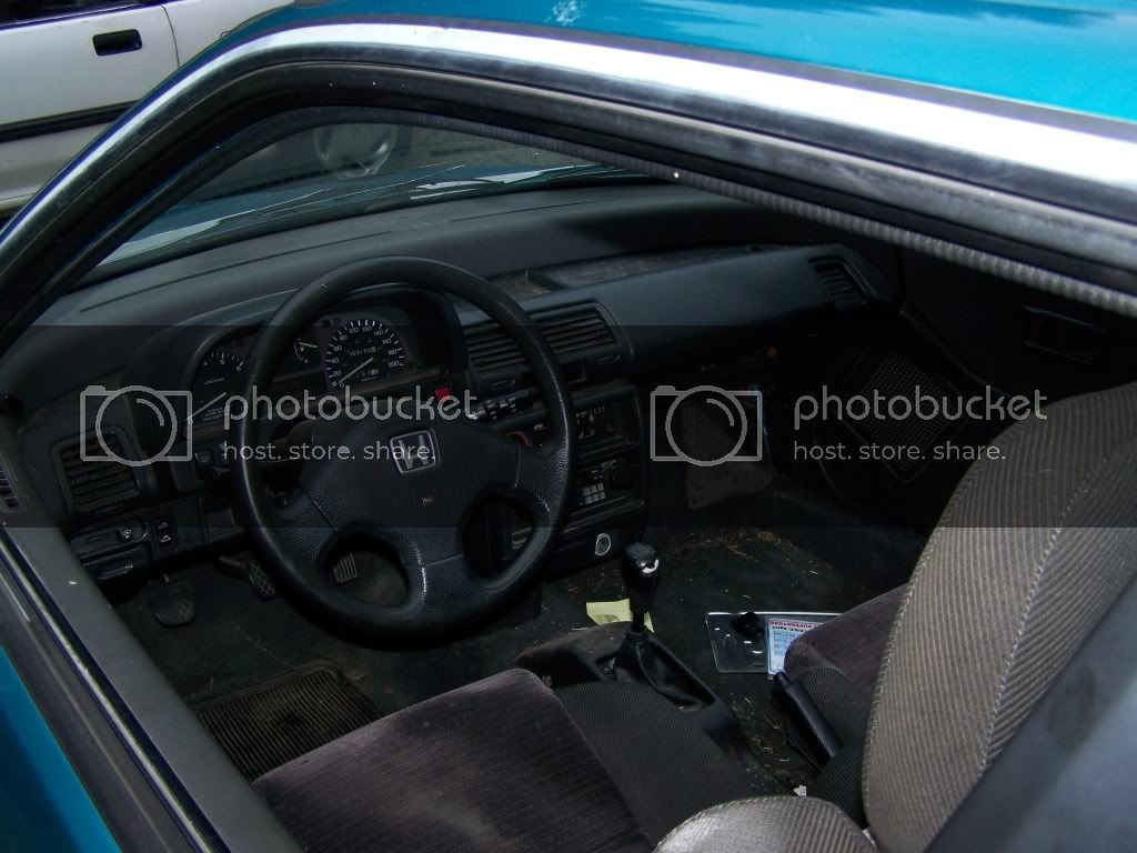

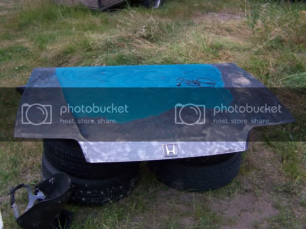

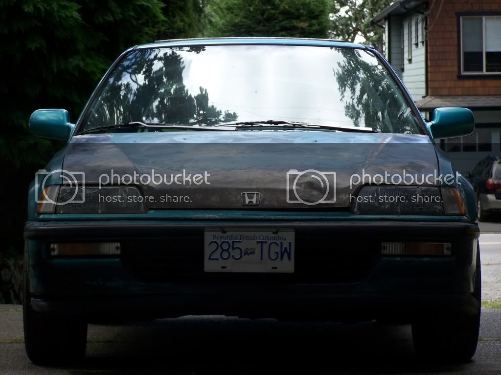

    Since the hood was hit by a deer and covered with rock chips - I'm rusting it. :D I didn't want to deal with the filthy interior so its gutted. No carpet, no rear seats, no rear pannels, no stereo. Just the complete dash, door pannels, MINT Si seats (from the white hatch) and center console. :driver: The wreked hatch is actually really handy, this car will be pretty clean when I'm done.

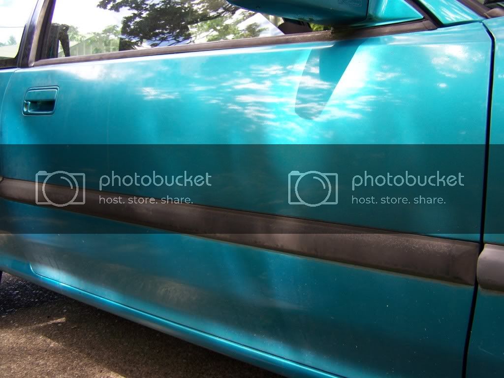

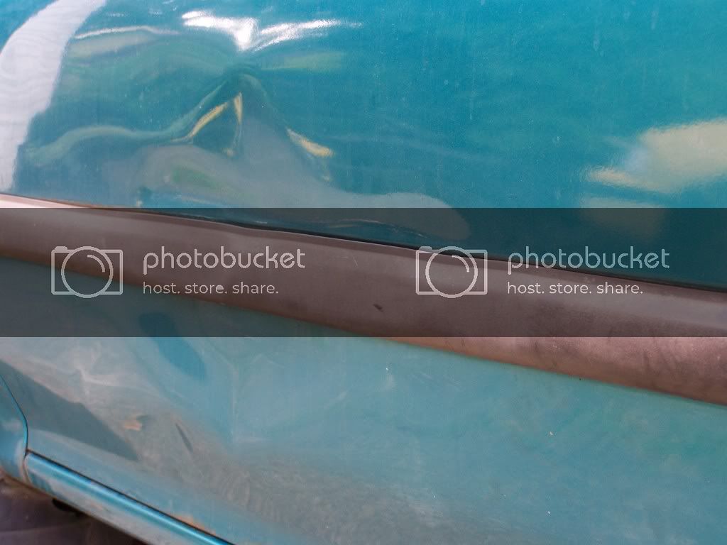

    The quarter had a huge dent that I popped out after it was gutted. :) My yellow rims are on the car but I gotta take em off, the alignment is wack and theres a clunking goin on (I think ball joint). I hope to steal the coilovers from my CRX, put them on the hatch then get it aligned w/ the yellow wheels.

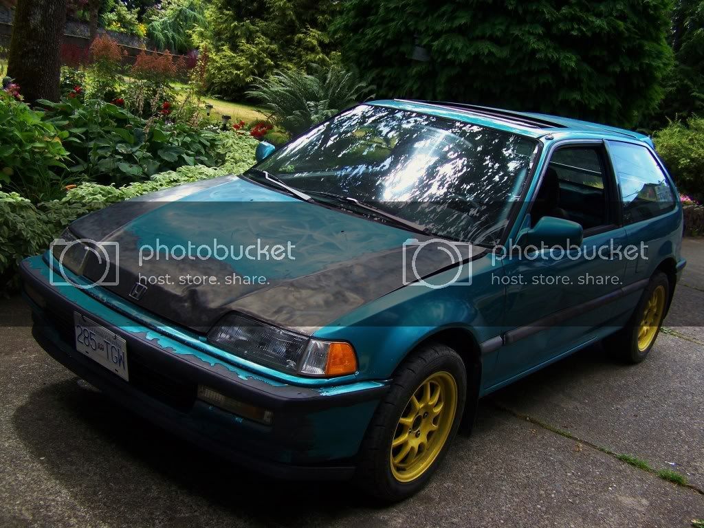

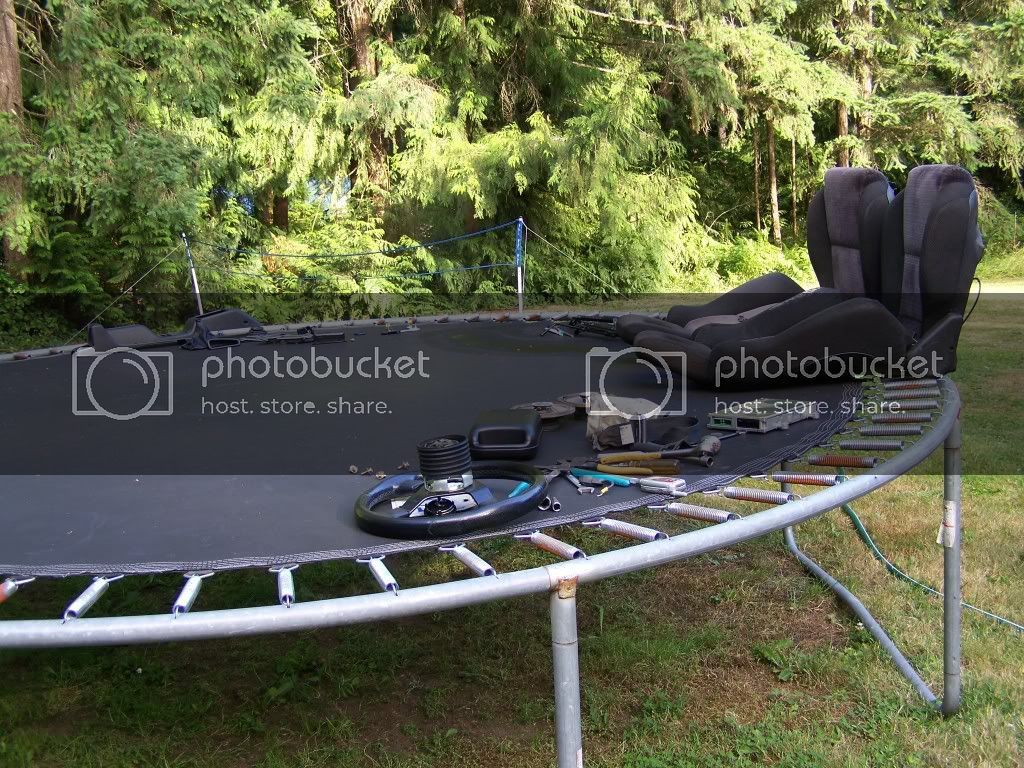

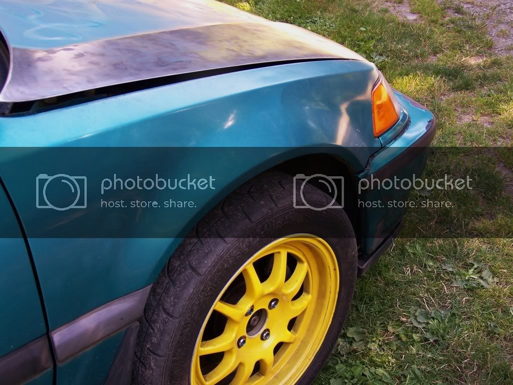

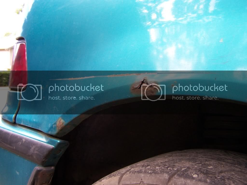

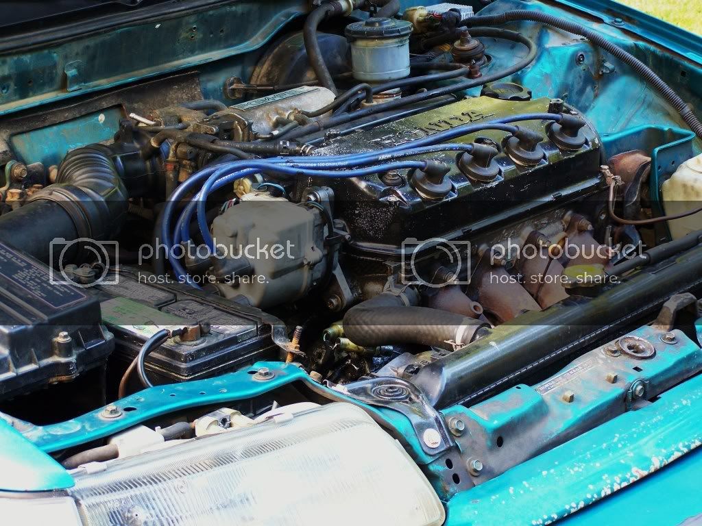

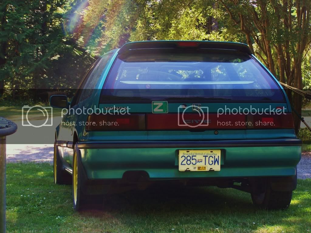

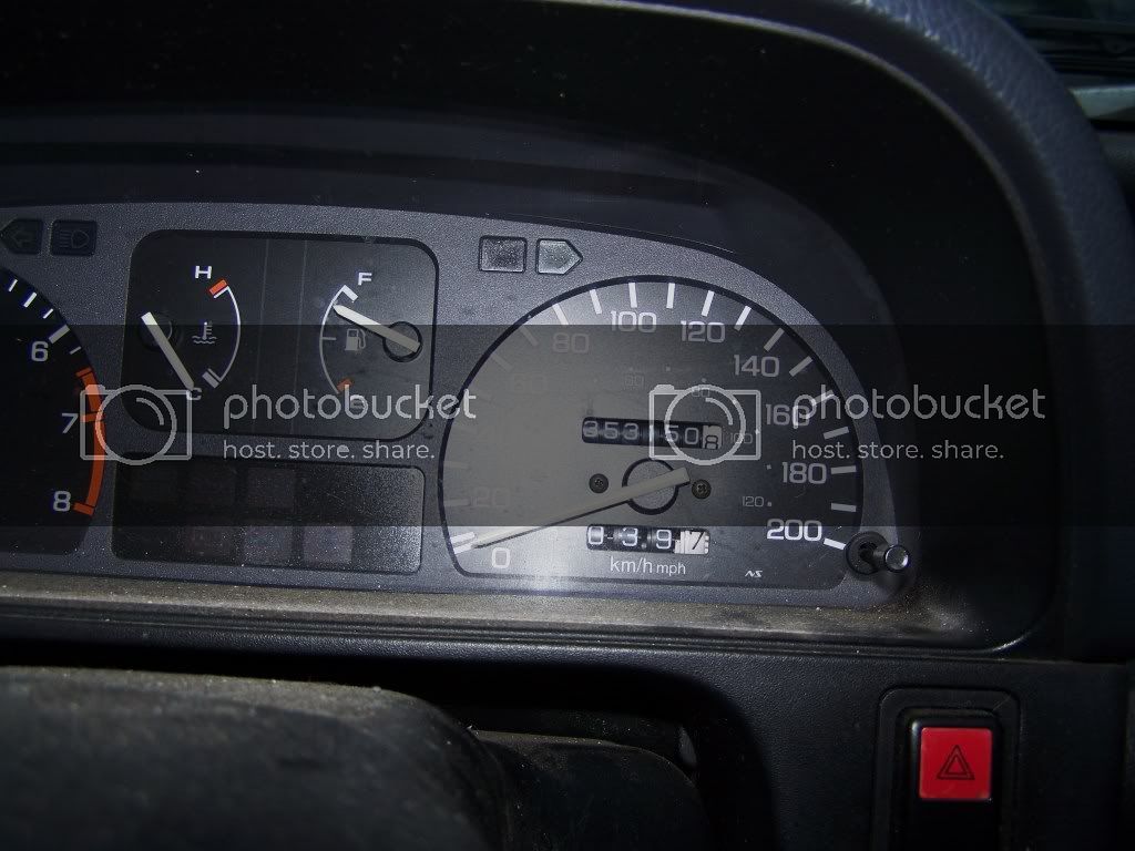

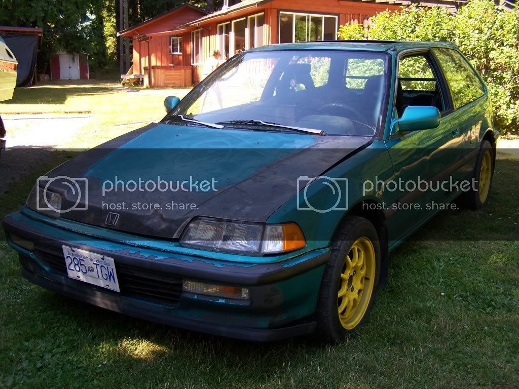

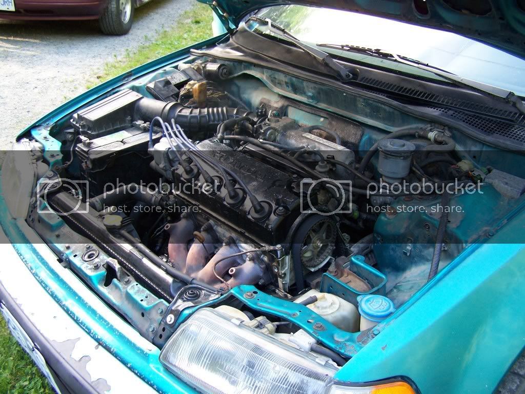

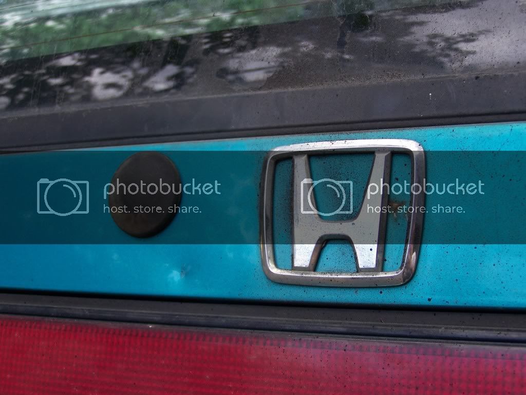

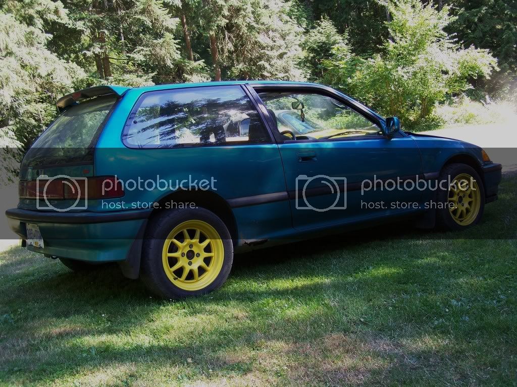

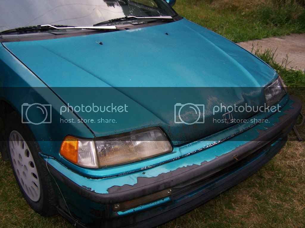

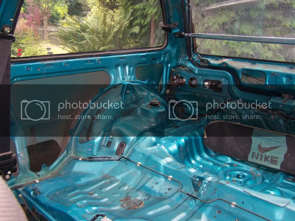

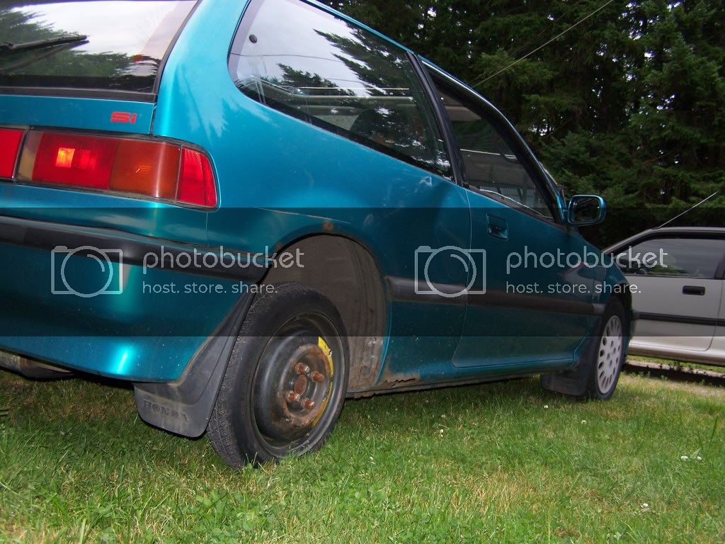

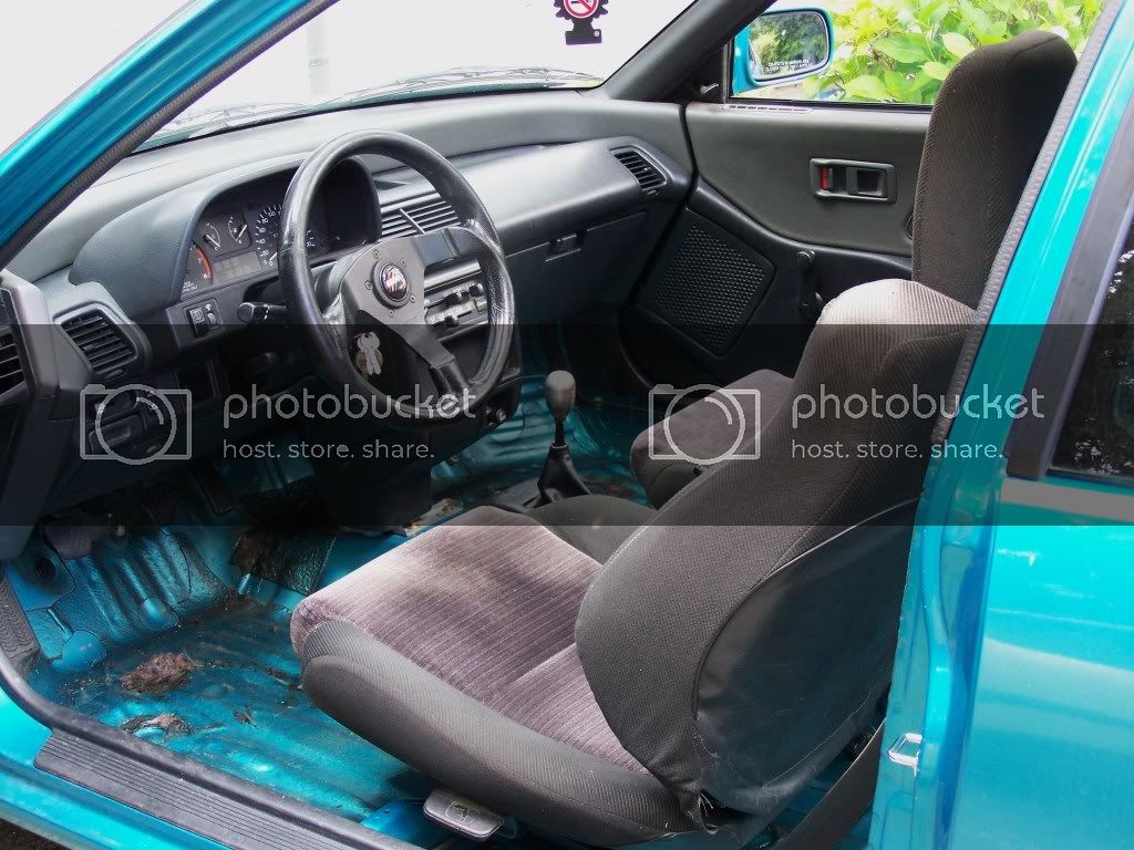

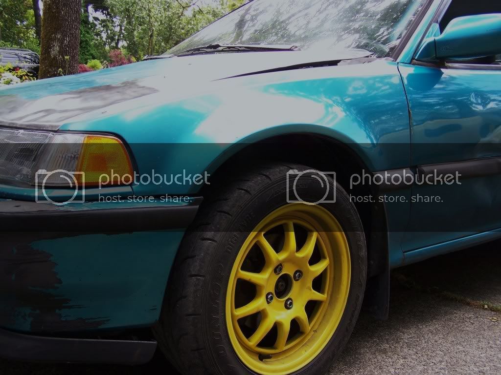

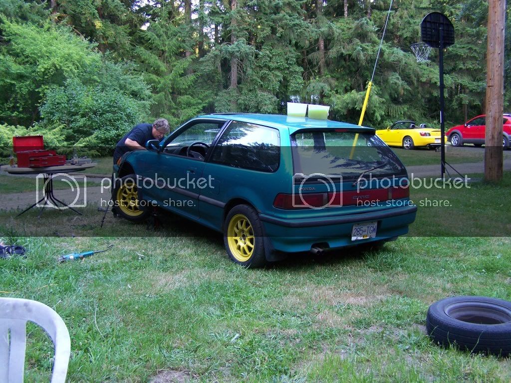

    I almost had the upper ball joint come apart 2 hrs away from home, been dealing with that all yesterday and today.
    Revival time! (Beware of 4x4 :ph34r:)
    Stock and untouched.
    The motor was soo tired.
    Stripping off the head.
    Pops' working away at the timing belt.
    New Y7 head back on and running strong! I can't believe how much life came out of the little D.
    Got started on the hood. Still hasn't rusted. :(

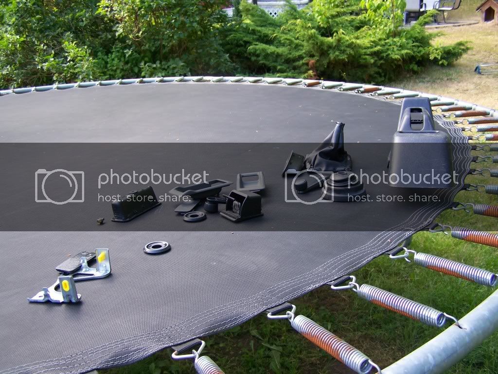

    Freshly gutted (not cleaned).
    Parts out to clean them.
    Random pic of my dads California certified S.
    Wiper delete and oil spray everywhere because it used to burn a lot.
    The plate that came on it. ;)
