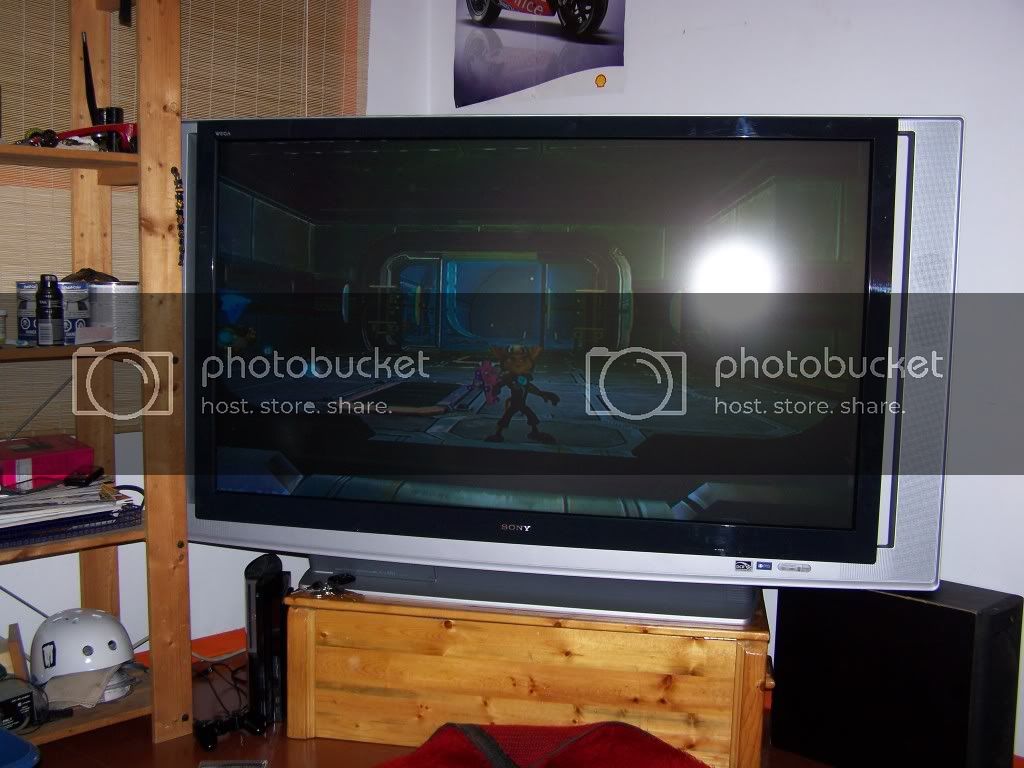

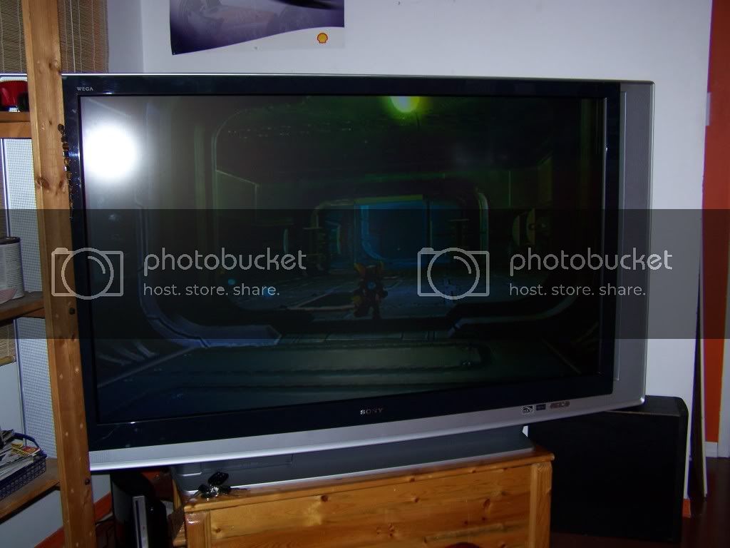

Just got a FREE 60" Sony HDTV. Rear projection, about 4 years old. Theres a part called the motor that combines all three projectors into one picture, only Sony uses the "motor" system. Well it failed and now theres a light green splotch in the upper middle. But it only shows up on lighter colors, bolder colors look fine. Anyway it makes a kick-ass PS3 TV for a 16 year-old, and the price was right. ;) I might buy a cheap HDMI cable and wire for actual cable TV.

And this one is defentally not that bad at all. Playing today I completly forgot about the splotch. Oh yeah, I got a cheap HDMI cable and NFS Shift. So far I have the S2K painted yellow and all stage 1 stuff. I also got a Civic Si, almost stock. Shit is FUN!!!! In the drivers view its like life size and its clear. :)

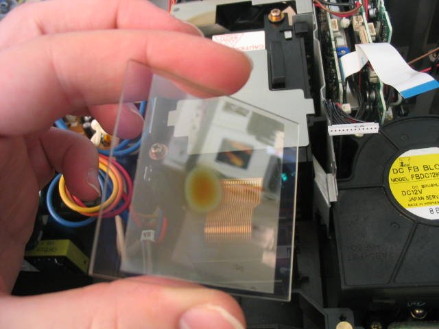

its probably not any type of 'motor' that's making that green splotch. it's probably a polarizer panel that went bad. That happens in LCD's all the time, and Sony's LCoS displays are like a combination of DLP and LCD (for simplicity's sake, that's what i'm going to say).
Basically, after extended use, the organic polarizer decays and it makes colors in the are of decay look exaggerated. Once it really dies, you'll have a very noticeable splotch like someone spilled yellow paint. The part is replaceable in front projectors, but its not something a novice would want to do. I've never seen how its done on a RPTV.
Here's a picture of a FUCKED UP panel:
The bad news is, it's about an $800 repair, so I wouldn't bother looking into fixing it since for that price you could get a new tv.
Basically, after extended use, the organic polarizer decays and it makes colors in the are of decay look exaggerated. Once it really dies, you'll have a very noticeable splotch like someone spilled yellow paint. The part is replaceable in front projectors, but its not something a novice would want to do. I've never seen how its done on a RPTV. The bad news is, it's about an $800 repair, so I wouldn't bother looking into fixing it since for that price you could get a new tv.
My dad phoned Sony and they said all TV's of this model have had the "motor" or "engine" fail at 3-4 years, 2 years for heavy users, and its a $1500 fix for only about 3 years more. I got the TV from my dads co-worker. He paid $5600 new and Sony gave him thier top of the line new LCD TV for $600.

ahh they're referring to the light engine. its basically the same issue though, some people refer to it differently. didnt put engine = motor together in my mind. (sorry, Home Theater is my current stupid hobby)
