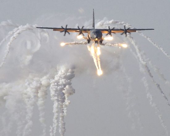

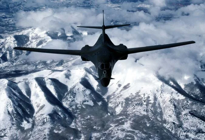

Whatever, I used to fix these
these
and, oh yeah these
Your bearings don't scare me, I just suck at trouble shooting. Besides I have a Chilton's :)
