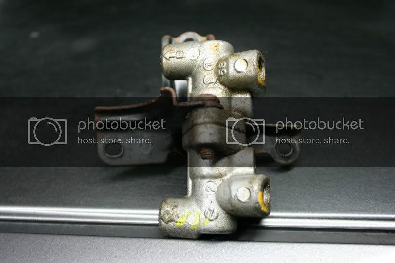

easiest way to know is do a search for the part numbers on each car and see if it has the same part numbers. The parts departments at the dealer can also check for you. I have good luck talking to them and trying to talk about interchangeable parts. Key that you have to consider is that if you use the wrong one, you may limit the pressure to the rear brakes and potentially under-brake the car. On the other hand, it could not limit enough and you will lock the rear wheels before the front (and maybe send you into a slide). You have to get it right, seems like a innocent part but could have big change to the performance of the car.
