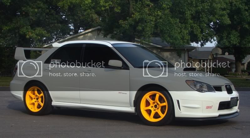

red is a tough color... if you are going to paint them bronze or gold, i would go with a bright gold
like this

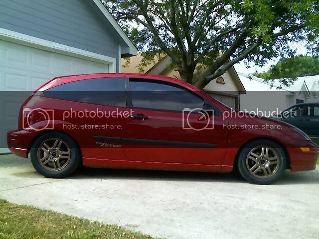

a darker bronze on a bright red car is going to look dingy
like this

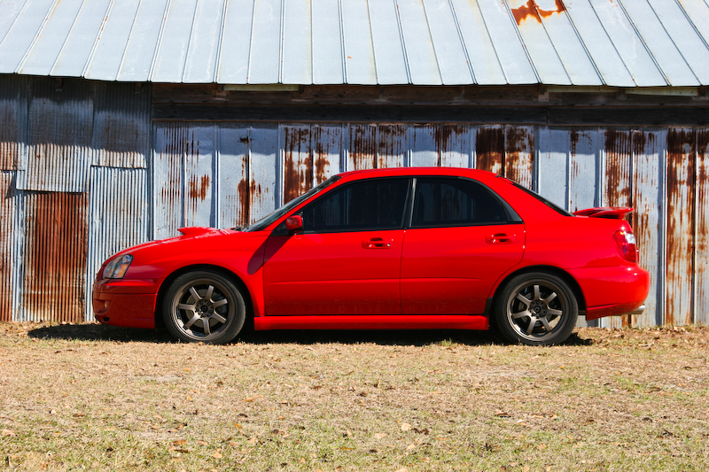

bronze would look a lot better on a darker red
like this
im not sure if this color would work on a bright red... maybe a darker more maroon type red would work better with them :shrug2:

haha anybody notice the sticker on the focus? DOHC ZETEC, never seen that before, doin it honda style!
