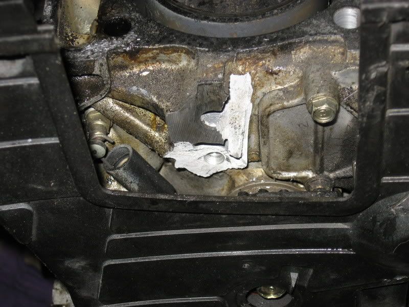

    I was a little upset when i pulled the timing belt cover off and found that this was broken... http://i35.photobucket.com/albums/d197/tiidan2864/b.jpg / http://i35.photobucket.com/albums/d197/tiidan2864/3.jpg / http://i35.photobucket.com/albums/d197/tiidan2864/2.jpg
    I had just removed the Head to get it ported and polished when i discovered this, I may have broken it or it was broken when i got it. I think its a motor mount bet im not sure. If anyone can ID those parts and give me some advice on what to do, that would be nice. If you need more picture i can get them tomorrow, my camera died, i'm just hoping that it is fixable and i can continue my project.

    looks vaguely familiar, but i cant ID, maybe some wider angle shots?

    cmon reiko...
    timing belt side motor mount :)

    lol, i dont work on civics....accord/prelude, remember. i needed to see where it was before i could be sure.

    so it is a motor mount....should i be looking for a new block?

    i think a temp fix would be to devcon it back together. i dont know how well it would work on a motor mount considering the stresses that particular mount is going to be under. i do know that it worked on a broken power steering pump bracket that is still in use on my prelude today.
