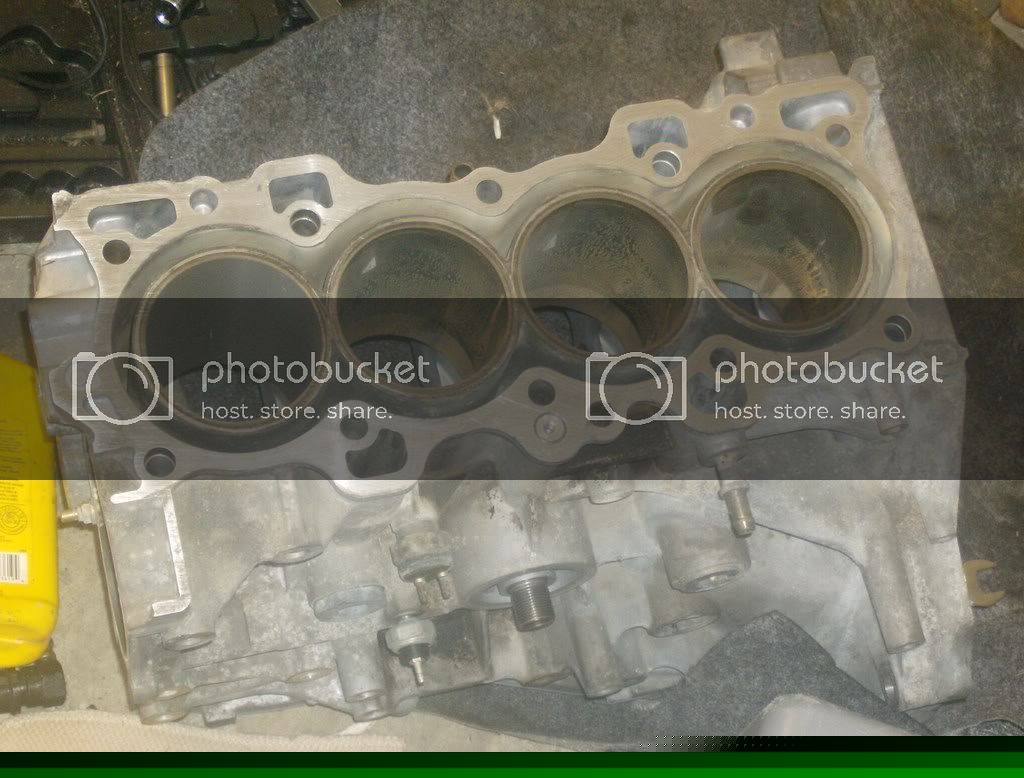

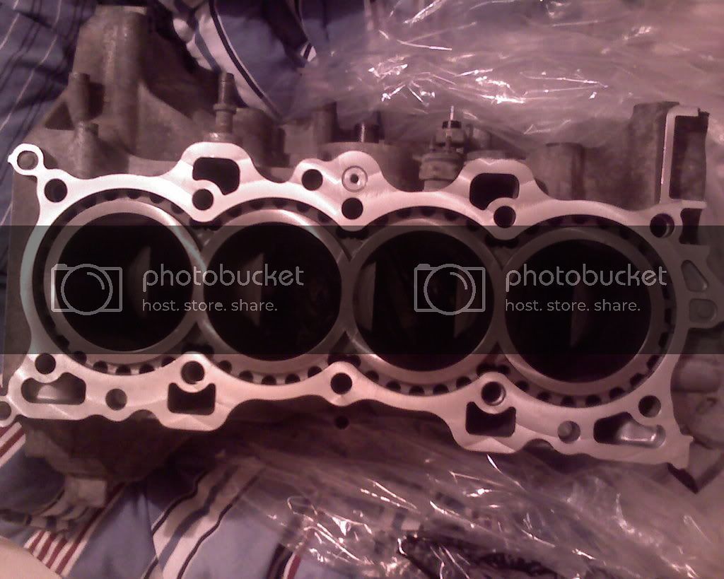

    Before The block Was Sleeved
    This is how the block came out with Golden Eagle Sleeves (Bore Out To 84mm)

  19. Luis998
    Luis998 Honda Enthusiast
    2,868
    56
    Jan 14, 2008
    Orlando, Florida
    GOD that's beautiful! *sniff* I can't wait until I get to see mine. *wipes tear*
