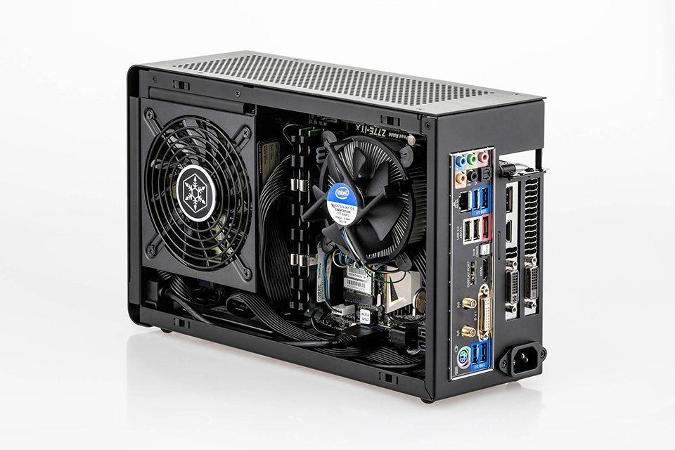

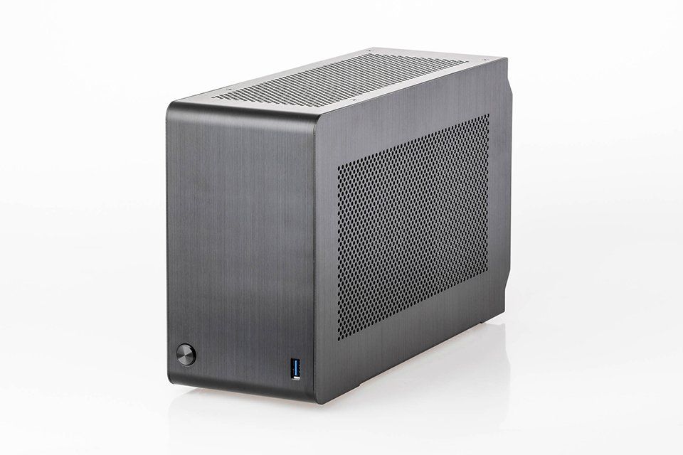

if you want SFF, look into mini-ITX. it has a ton of support these days. they have mini-ITX boards that support the latest processors (not just tiny shit like the Atom), and a single full size PCIe x16 slot for a video card. a lot of times they use laptop SO-DIMM memory to keep the board small.
this case is pretty awesome: 8"x4"x12"
http://theawesomer.com/a4-sfx-mini-itx-gaming-pc-case/369935/

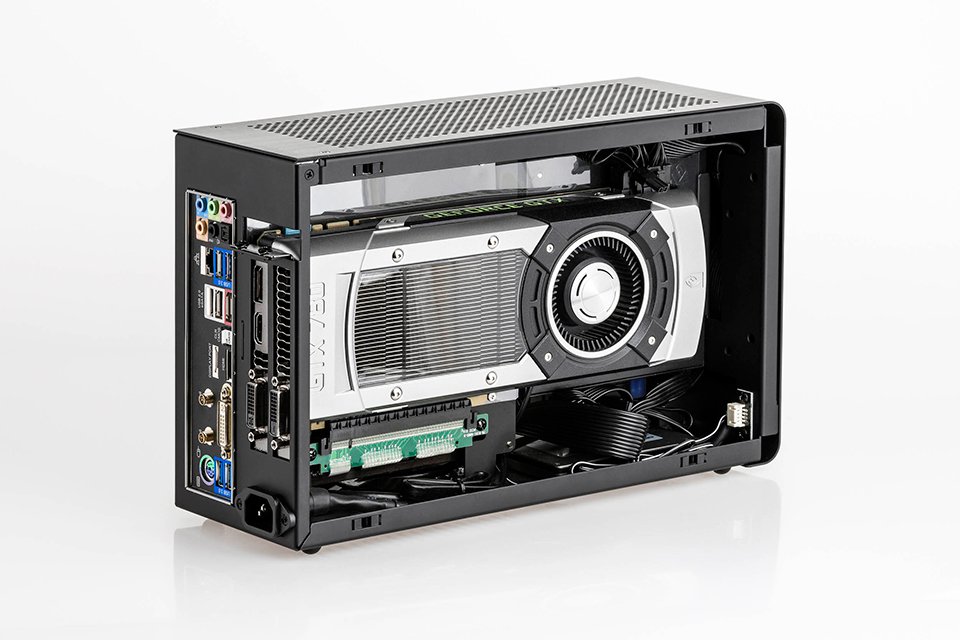

its either a 1070 or a 1080 , my rx 480s out perform them in crossfire mode ;) open GL games though single card is superior
it says right on the card that its a GTX 780... and it wont be any more of an oven than a regular PC. it has access to fresh air right through the side vent and is sectioned off from the heat of the rest of the system on the other side.
that particular case was a kickstarter last year, but they are planning on producing more this year. if i wanted a SFF portable gaming rig, id use that case. and toss in a monster single card (GTX 1080 Ti seems to be the best single card available now)
the only downside is noise. youll hear the GPU fans more. but if you care about noise, you'll need a big case to support water cooling. my watercooled rig back in the day was sooo quiet. and didnt get louder under load since the fans were at the same low speeds at all times.
