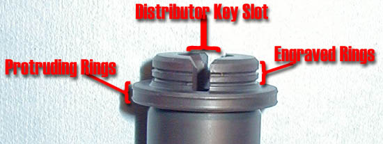

thats the CTR cam, you can id it by the 2 rings, the ITR has 1 i belive. i got this from http://ff-squad.com/VtecCams.htm and for some reason the rest of pics arent loading. just look to make sure there is no excessive wear when buying used cams. i've used the CTR and skunk2 stage1, i liked the stage1's better, but the CTR's are still a great choice.
so as long as I can see a pic I should be able to tell visually if the cams are in decent shape?

na, if you're keeping stock valvetrain i'd just get the CTR's. ya, make sure he takes many detailed pics for you, and that it is someone you can trust.
