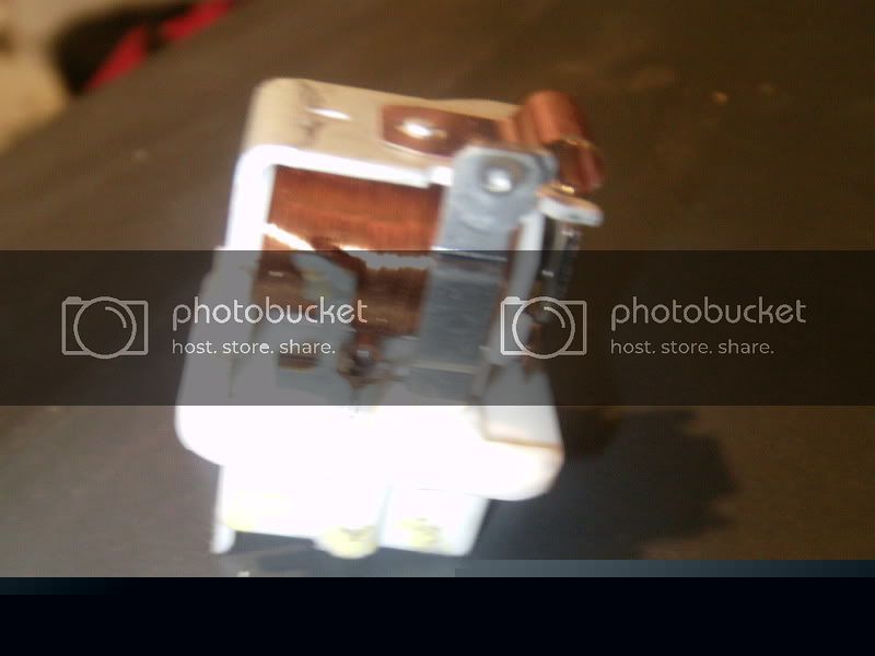

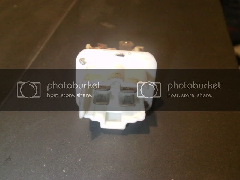

    I think this thread is about to solve my summer heat / stranded, no start, problem and a help out a ton of crx/civic owners. Here is a pic of one of my relay's. They differ from the ones pictured in the link provided above and they do not have the soldering points like what you guys are thinking. I don't want to solder into a copper spool? :confused: When it's Hawt, I just take one from under the seat and swap it out, if that one did not work I had a backup for my backup. If you look closely, you can see a small resistor?
    THNX DUDES.

    Thats not the main relay, the main relay has 7 pins in it IIRC.

    Then what is it? I bought two from AutoZone and they said it was a main relay. I also pulled the old one from under the hood latch exactly where the relay supposedly resides...:ph34r:

    The main relay is tucked to the left of the hood release lever. HELMs even has the pinout.
