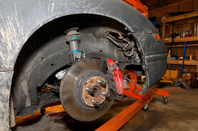

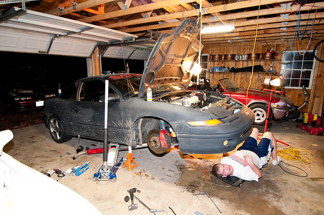

    You can get someone to make you an adapter plate for just about anything.
    Here's proof:
    Saturn SC2, 1994, with Porsche Cayenne calipers. Funniest thing was that they didn't have much more contact area than the stock brakes. (we took them off.)
    Put some better pads in, and you won't need the multi-piston brakes.
