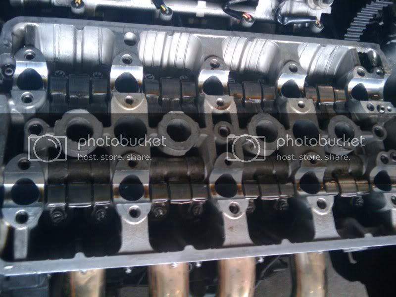

<a href="http://s19.photobucket.com/albums/b161/chacal06/?action=view&current=2009-10-13154042.jpg" target="_blank"><img src="http://i19.photobucket.com/albums/b161/chacal06/2009-10-13154042.jpg" border="0" alt="Photobucket"></a>
That's what it looks like so I'm guessing vtec....so I can use b18c or b16a camshaft ?
This is what it looks like so I'm guessin its vtec...so I can use b18c or b16a ?
Yup, looks like it, what's wrong with the cams? They usually don't really go bad, no much can go wrong with them other than wearing out.
Rockers look ok judging by the pics.

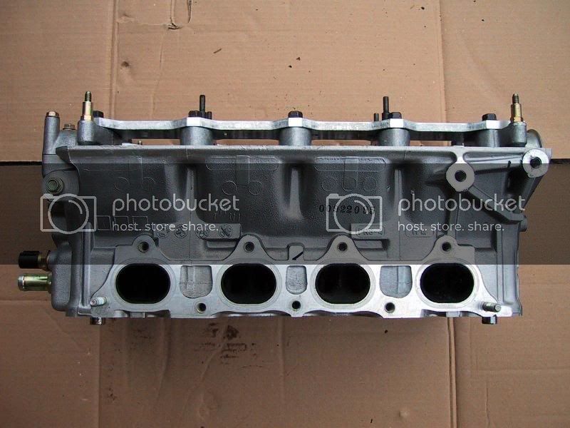

I agree, take it to a different mechanic. There are codes on all the heads.
B16 and Type-R motors have the same CAST head...some of the differences between the two heads are that the Type-R head has a better and stronger valvetrain, the cams, lighter valves, the better intake manifold and bigger throttlebody, and a mild port job from the factory.
b16 and type-r heads are stamped PR3-X (x being a random number...in this case its 4)
see:
P72 cast head - GSR b18c head
Also another random fact: u can tell the date of the head by the numbers to the far left of those circular stamps with numbers on it. See the " 0 0 " ? That means this head was manufactured in 2000.
