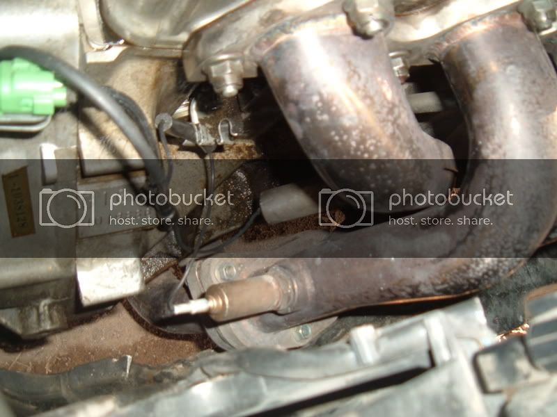

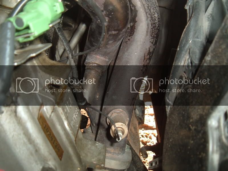

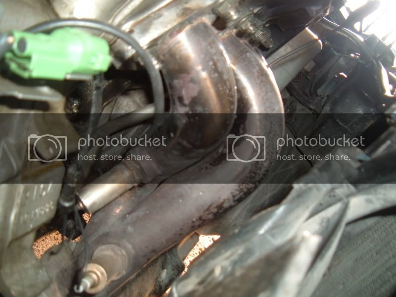

  10. 91si
    91si New Member
    108
    May 26, 2007
    Ima get you a pic of mine. Need an hour
    Here are some pics of my headers with the o2's. these are the factory places for the o2's.
    best pics i can get. hope it helps/
    and i just noticed i have a headgasket leak....nice...thats ganna be fun to change.

    hey 91si, i think your headgaskets leaking. lol. j/k.
    but those pics should be helpful, at least he knows which to weld the o2s on.

  14. burninriceinva
    burninriceinva New Member
    44
    Jan 4, 2007
    Hampton Roads, VA
    thanks for the pics thats what i needed to know. good luck with the head gasket leak.
