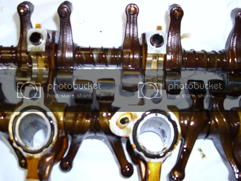

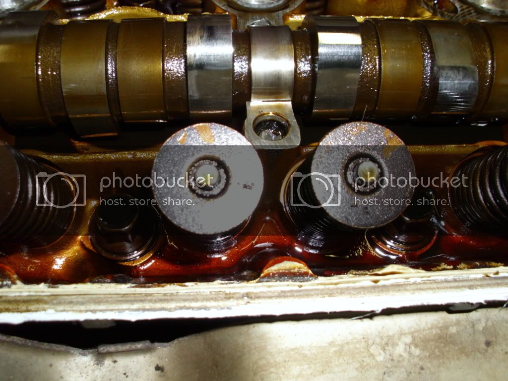

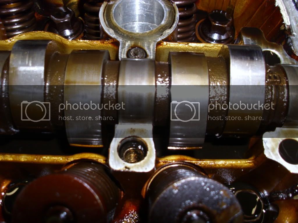

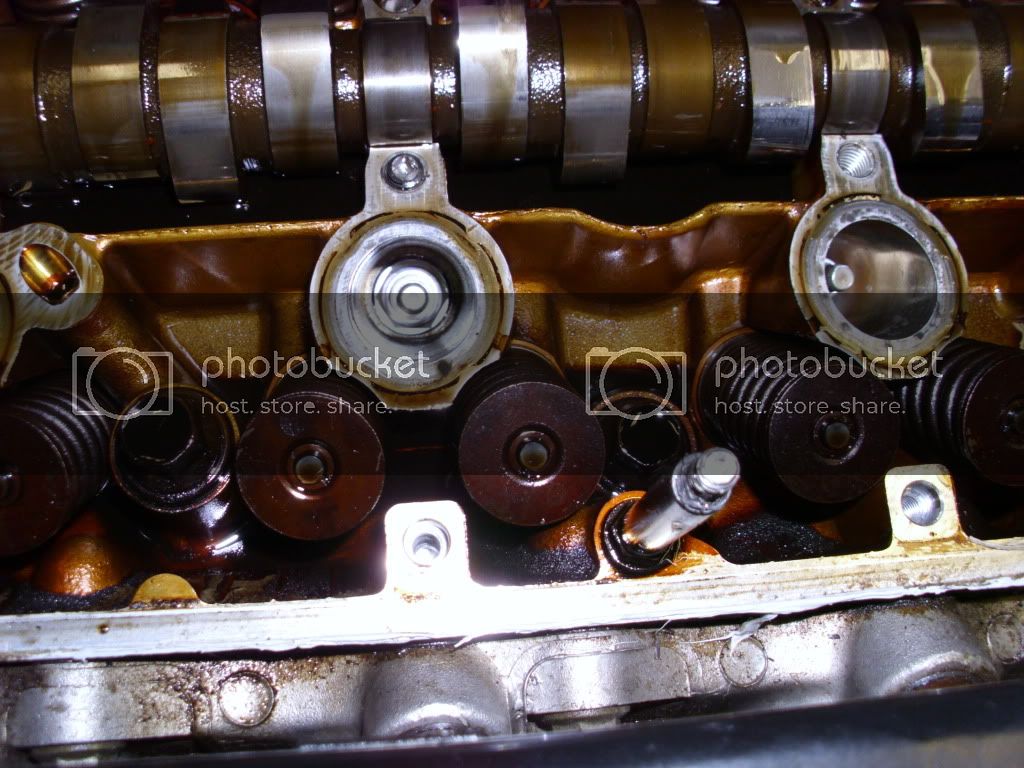

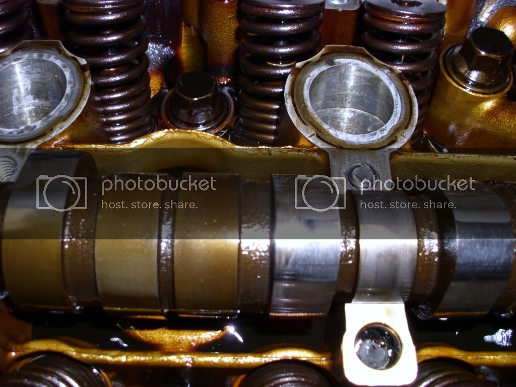

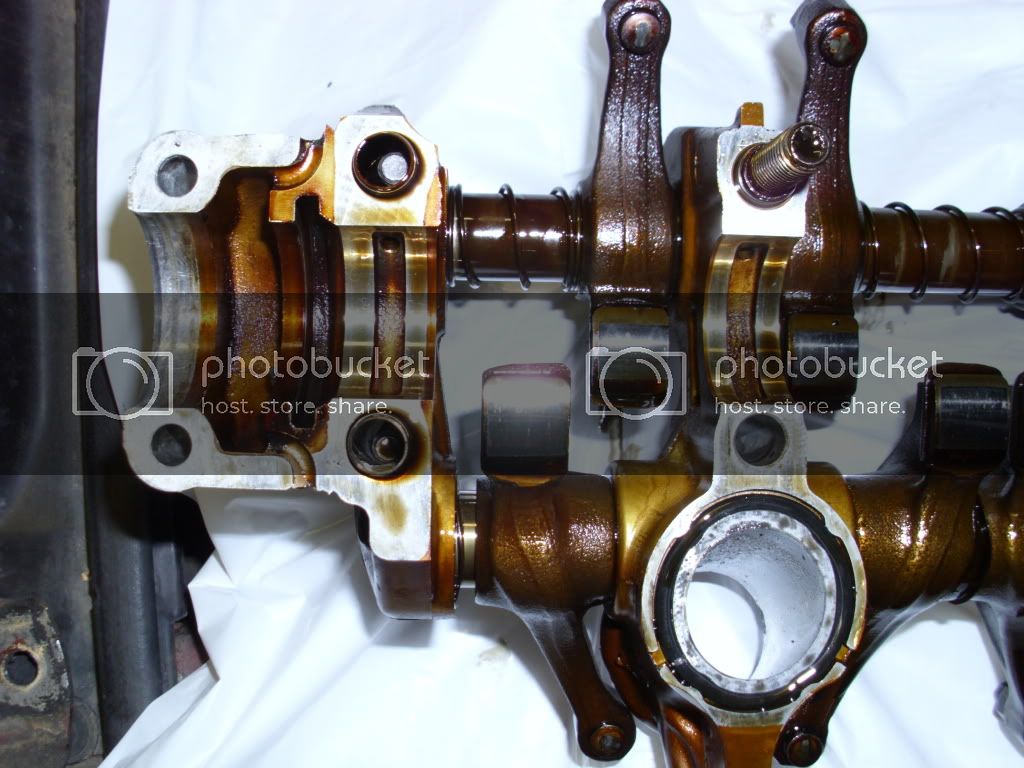

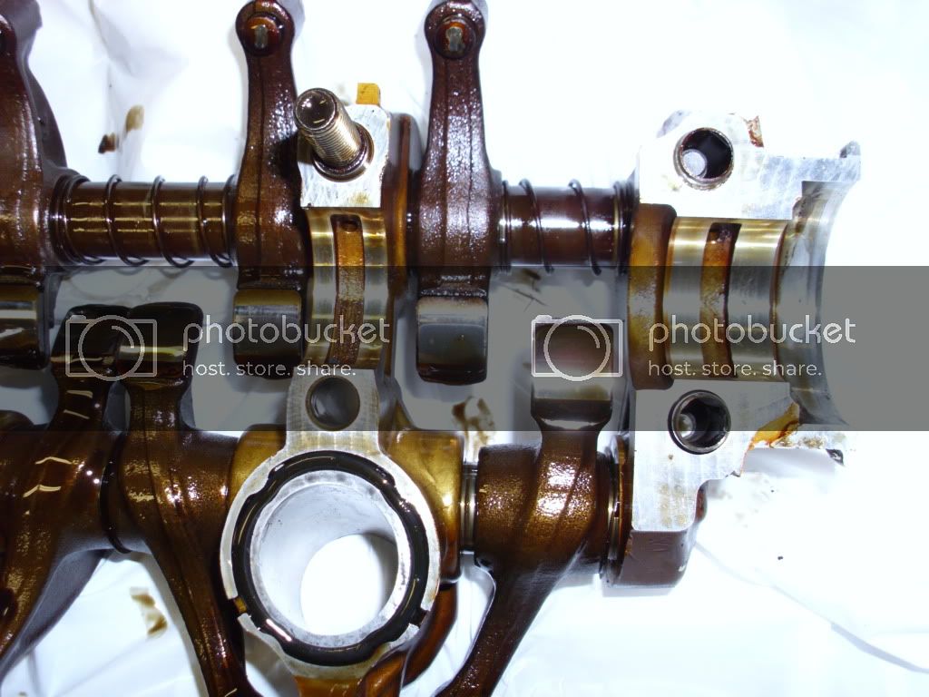

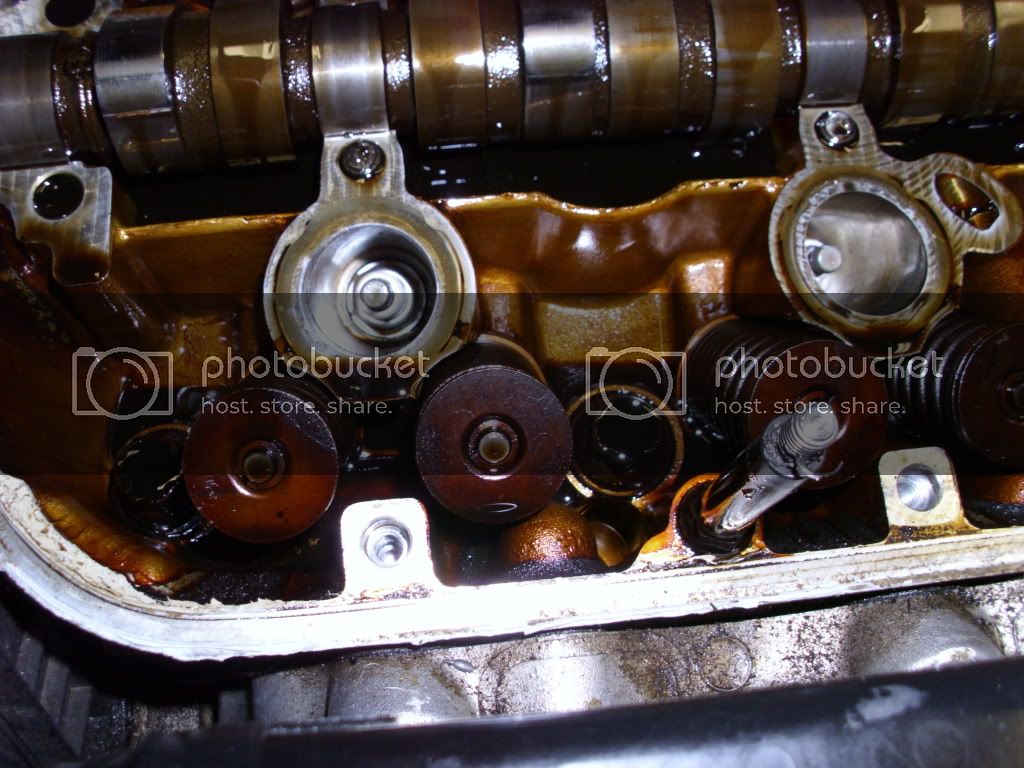

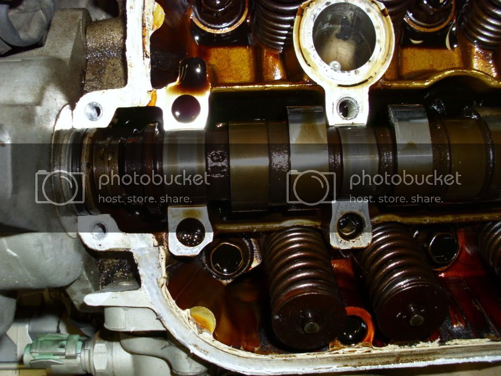

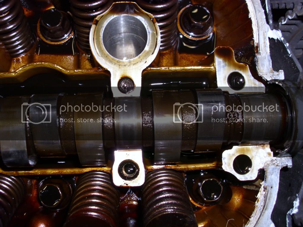

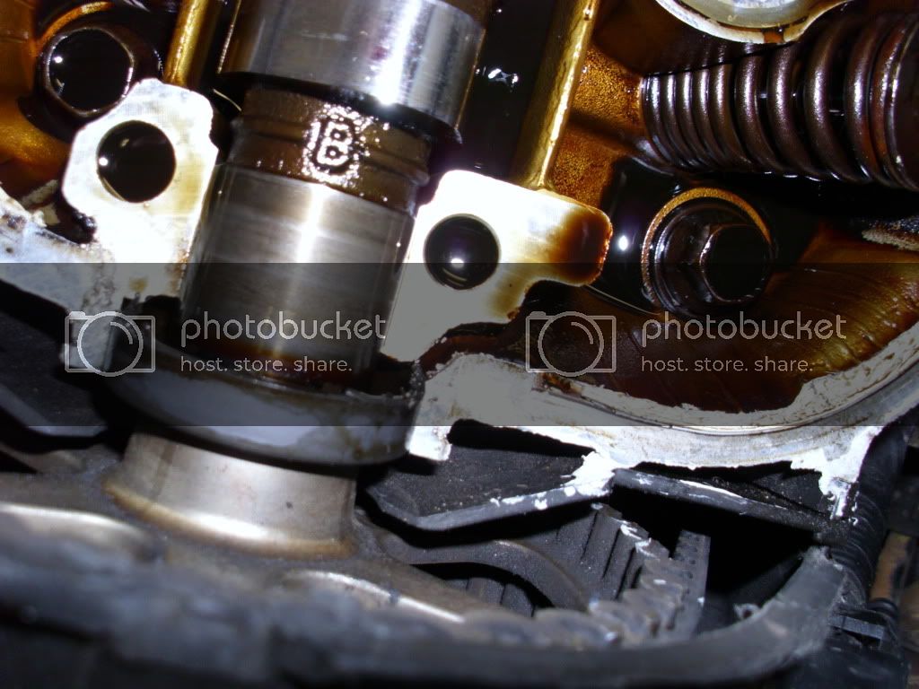

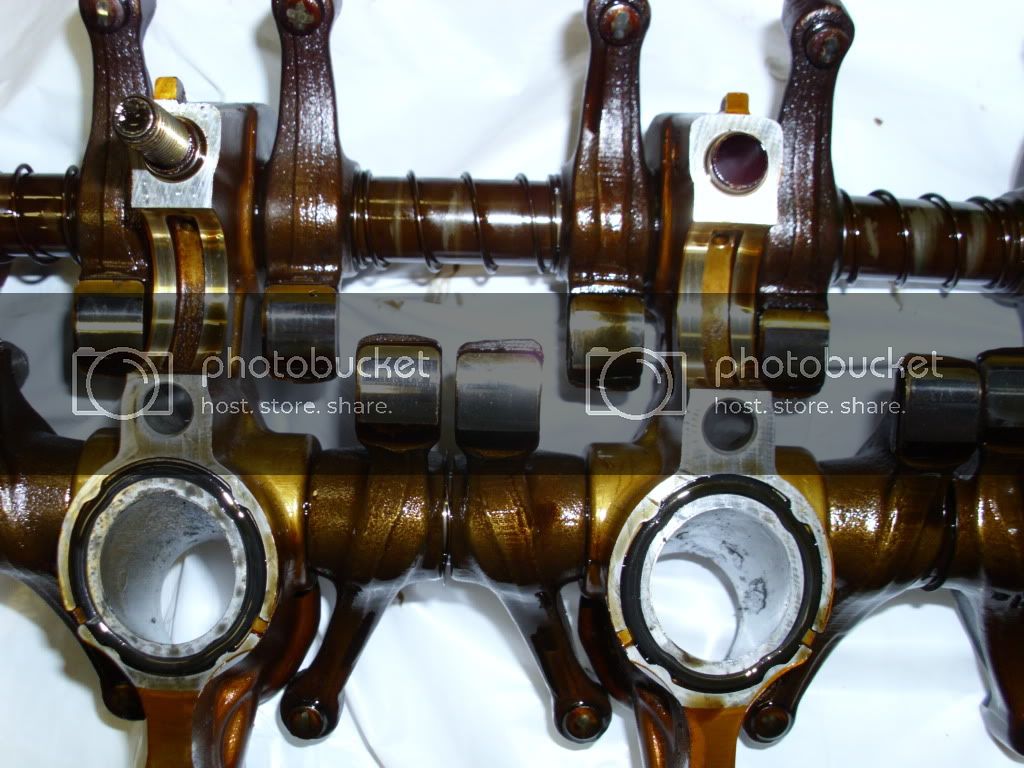

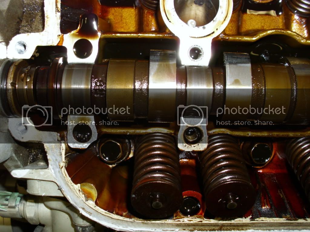

i got some new pictures of the cam and stuff.
if you guys wouldnt mind looking at them as closely as possible and telling me if you see anything wrong with them i would greatly appreciate it.
i am thinking of just gettig new bolts and redoing the rocker assembly and seeing if that fixes any problems.
any ideas appreciated :)
