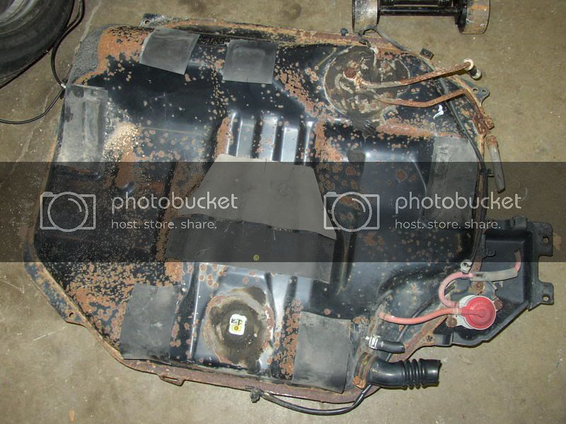

I believe the access port only uncovers the sending unit. see attached. Pump is located at the rear of the tank

Is it likely, that the person who did the swap into the car I'm pulling a built B16a w/nos out of, upgraded the fuel pump, is the fuel pump something you would upgrade to run a built B16a w/nos? Thanks. Ps, there is a pressure gage on the top of the fuel filter if that helps you.
Ok, just checked alldata, it says that you have to remove the tank, sorry, I thought all honda's had a cover. As far as a fuel pump upgrade, its hard to tell if it was my car I probably would have just put in a new pump, not necessarily an upgraded one. Good luck
