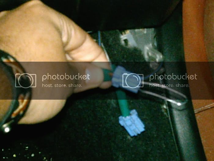

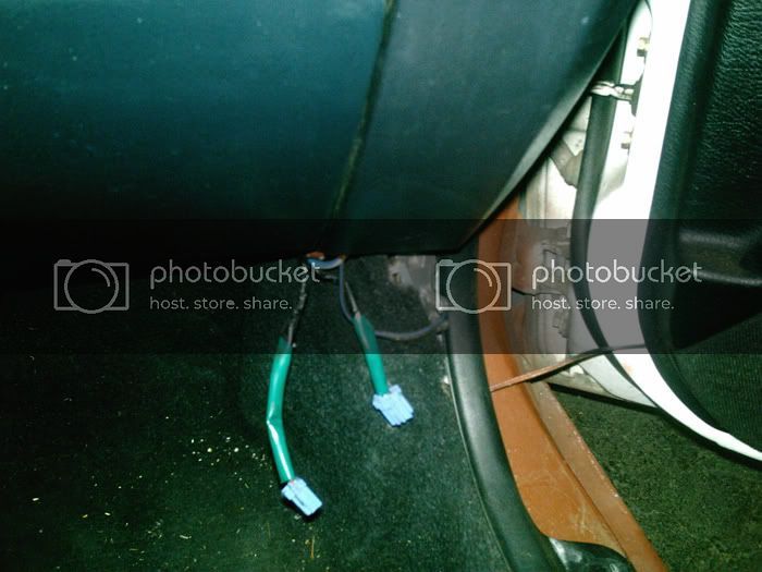

    In order to retreive the code, access the passenger side kick panel. Located above the ECU is a seperate brown plug tucked inside a green rubber boot. Jump the two wires together with a paper clip or stand of wire. Once that is done, turn the key to the ON position but do not start. Count the number of flashes. each long flash = 10 and each short flash = 1. i.e. two long flashes and three short flashes = 23. Once all stored CEL have been cleared, the Check Engine Light will stay solidly illuminated. Pull the jumper wire or paperclip back out and reinstall everything behind the passenger kick panel.
    Plug:
    Connector located within the plug:
    Jump it like so:
