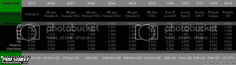

    An H22 transmission isn't a necessity, but you'll probably want it for the gearing...

    Actually, I'm gonna keep my H23 tranny. 4k rpm at 80 mhp is plenty.

    I looked at the gearing charts again and decided to go with the JDM tranny. It has shorter street gears but a longer 5th, which is perfect. It was the usdm vtec tranny I wanted to avoid.
    Old tranny: M2S4, New tranny M2A4

    How did it work out? I would have advised that you get the m2b4 (LSD)... I like the way that transaxle feels... same gearing as jdm vtec tranny... and it is true the usdm vtec tranny had the shortest gears... I had an H23 before my swap and I used to twist 3000 right at 60mph, now I am doing about 62-3 at 3000... not a lot of difference, but my mileage has not gone down even though i have been playing with the vtec since it's new to me :)

    I LOVE the M2A4 tranny. It's the gearing I've always wanted, short of adding a 6th. I could have paid an extra $400 for the M2B4, but I'm just not into spending money on car performance enough to buy an LSD. The motorcycle cured me of that.
