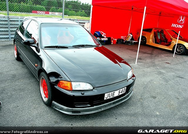

here are some pics of my EF and a bonus pic of my baby civic eg6 :p
My EF is far from ready. right now it looks kind of messy :S
http://i247.photobucket.com/albums/gg127/Lars-P/PICT2265.jpg
and my sweet eg6.
over and out from Sweden
