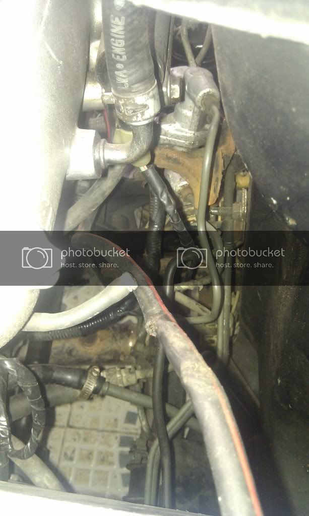

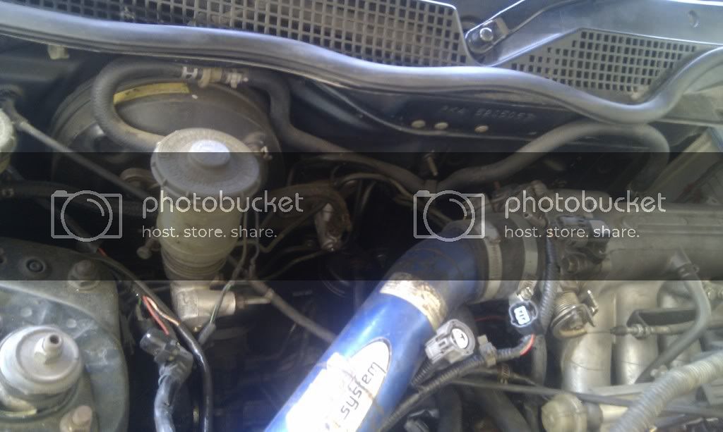

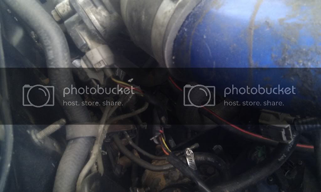

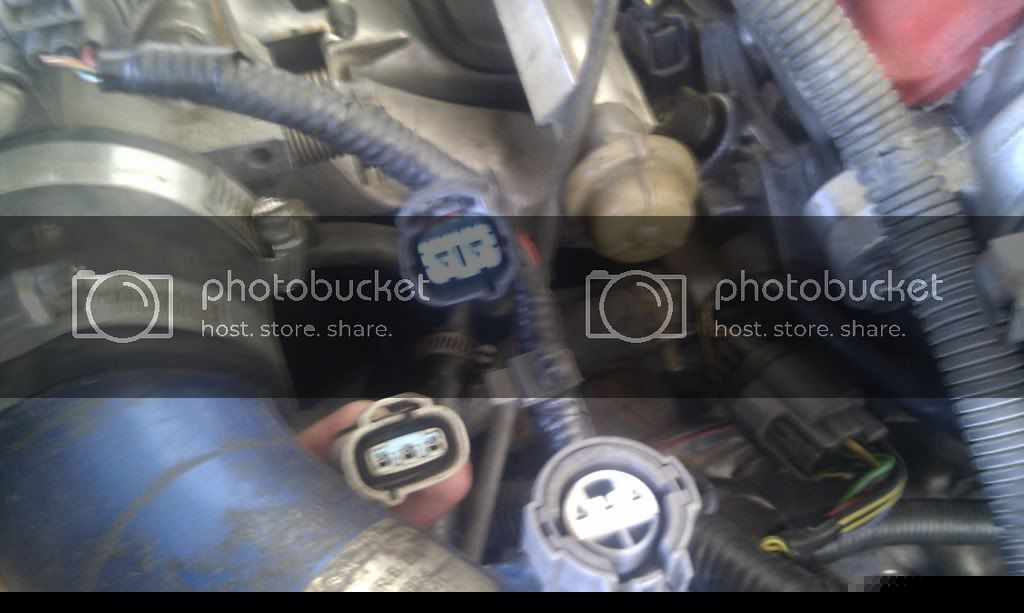

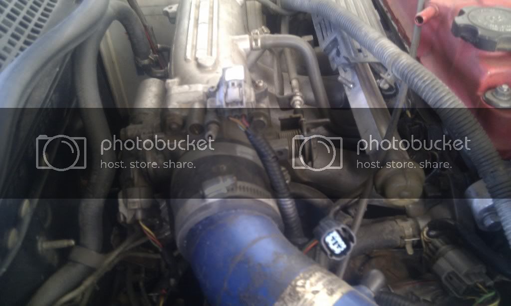

    Hey guys hope you're all doing good.

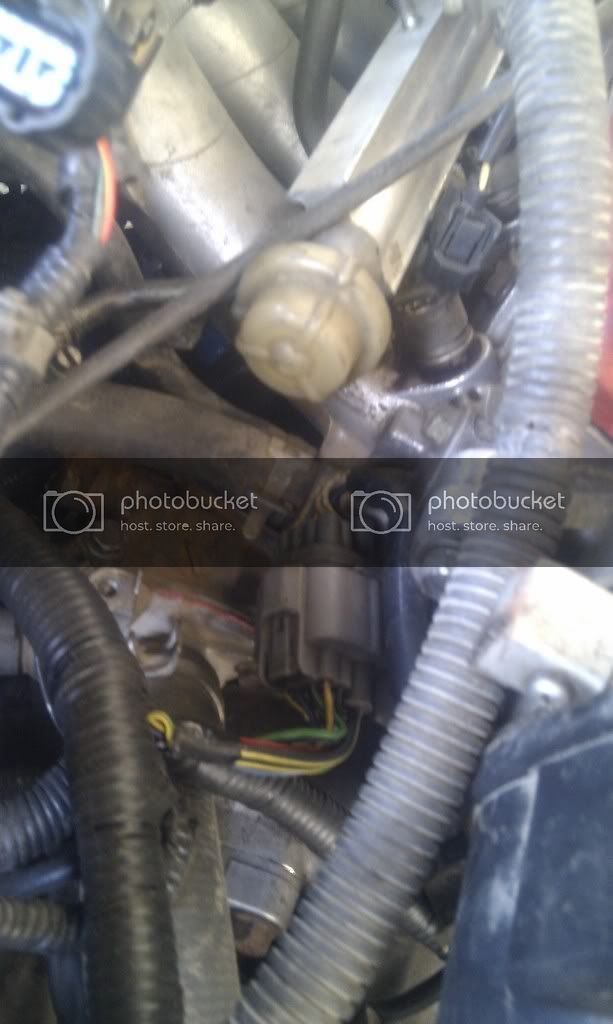

    I have a little problem. Swapped a B16A4 OBD 2 P2t ECU into my Civic EG SEDAN recently. Retained my original D16 wiring harness since I got none with my b16 ><.
    Anyways, I have a MAP sensor missing aswell as INTAKE sensor that plugs into the intake pipe. Also getting a CEL code for Knock sensor. I'm currently getting Code 3, Code 23 and another one for intake sensor missing. Anyway, the problem is that the car is running like absolute shit, stalls alot, idles low as **** and I don't even feel the vtec kicking in. ALso running very rich. I also noticed some oil getting into cylinder 1 plug.
    Another thing is that the car gets even worse after a bit of harsh driving around the city, temperature gauge stays on normal temps but the engine is REALLY REALLY hot even after several hours after being parked. Or maybe thats just me feeling paranoid.
    Anyways i'm getting MAP sensor and Intake sensor tomorrow, so that I can resolve these issues for the time being. Knock sensor I can't find at the moment where i'm at ><.
    Guys any help will be greatly appreciated!

    Get a OBD1 P30 ECU you are running an ECU that is looking for 2 O2 sensors....you got one. And its just a better fit anyway.....OBD1 in OBD1 chassis.
    Map sensor is missing from the top of the throttle body or is there a vacuum hose for a MAP sensor on the firewall (JDM)??
    Run Knock sensor to the ECU or just look into a chipped ECU with it deleted.
    And.....get the IAT sensor installed.

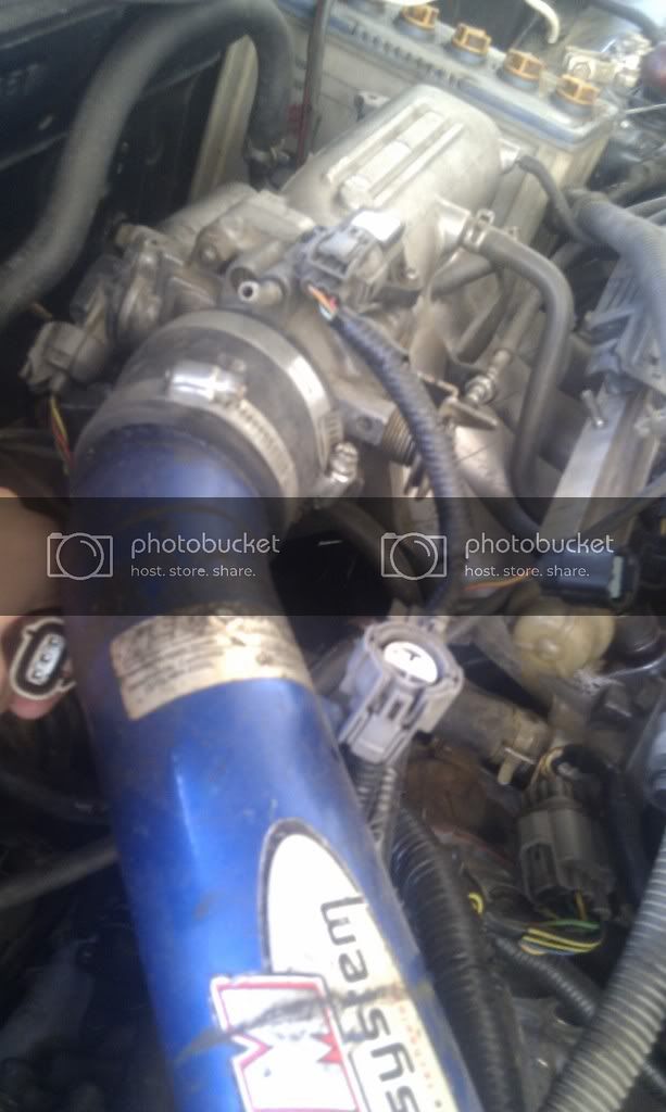

    Alright I just got hold of the sensors. Installed the IAT and MAP sensor. Now i find out that I ALREADY had a map sensor installed on the TB :S i mean, wtf ?
    Theres a hose coming out from the back of the Manifold to which I thought i had to install the MAP sensor to.
    Now what ? I've got 2 different places for MAP sensors. I'm officially stumped!

    Use the one on the TB. You do not need the hose for that one because the vacuum comes from the TB.

    I always had that MAP sensor on my TB. But i was still getting MAP sensor error :S

    Maybe a stupid question, but it was plugged in right? If it is then you could just replace it with the new one.
