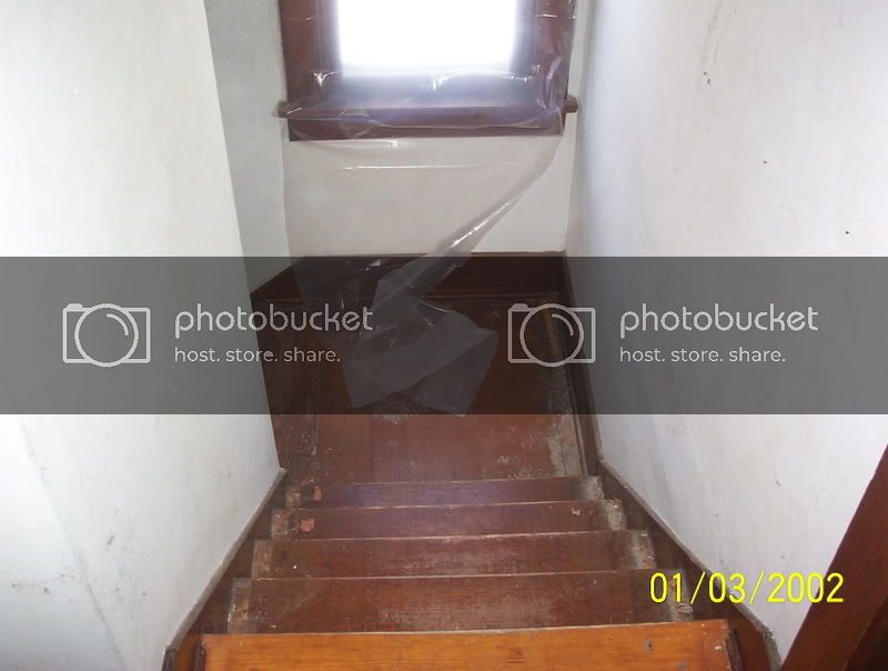

i went and helped James (2000Si) on the house today. we put plastic over the windows upstairs and a few on the windows on the main floor that needed it bad. that helped alot. it wasnt as drafty in there.

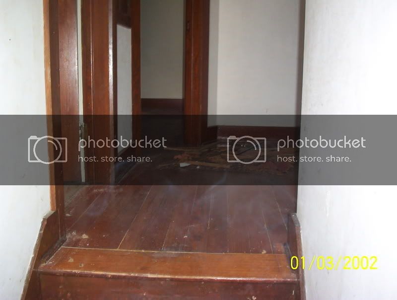

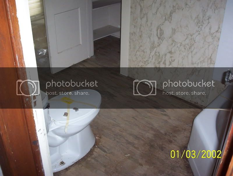

i pulled the carpet and padding up in the bathroom, the hallway and the stairs going up the stairs to the 2nd floor. man did that carpet smell aweful!! it had a bad cat piss odor to it..yuck! we also pulled the carpet tacking (not sure what else to call it) up around the walls as well as pull out a majority of the staples out that had held the carpet down in a few spots. it looks better than it did by a long shot. just needs some new tile in the bathroom and it will look tons better. we got all that done in a few hours time. we were quite pleased with what we done.

But yeah, Brian worked his ass off taking out every single staple that held the padding to the tile.
There is an ugly green tile that was under the brown carpet in the green themed bathroom. (gross).

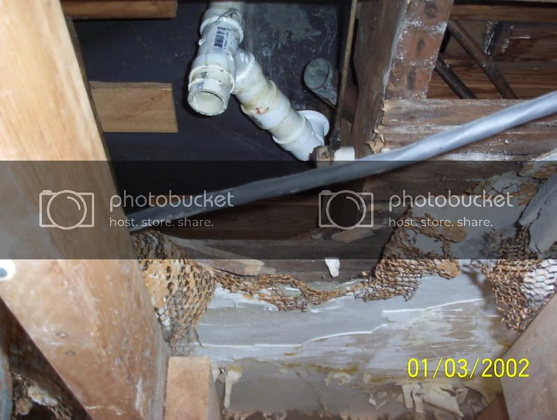

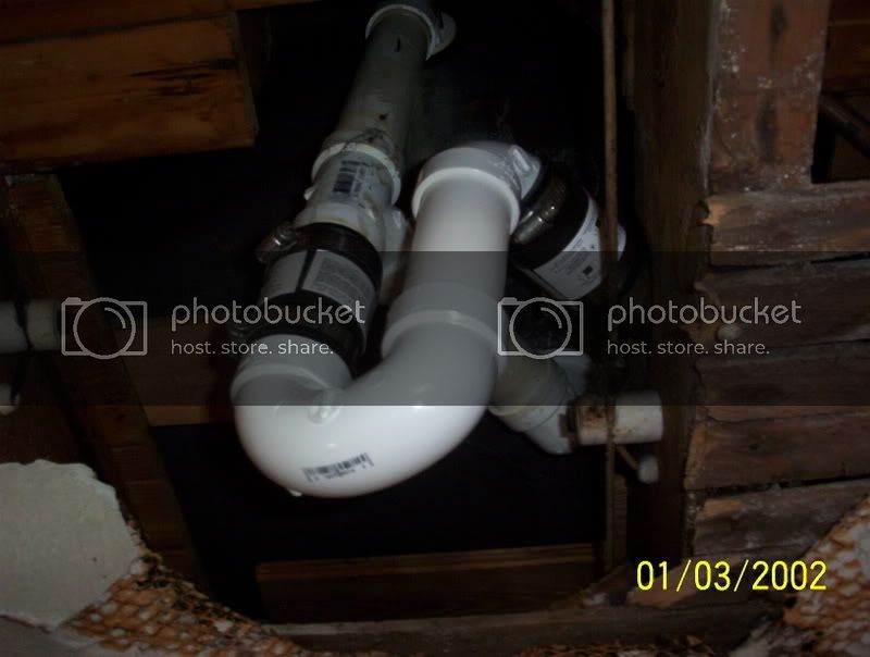

My dad is coming over to help me figure out the piping. I forgot to mention here that there is a giant hole in the kitchen ceiling below the bathtub on the second floor. Apparently a pipe burst/broke from the tub and they had to repair it but never got around to actually doing it.
Once I figure out what I need and how to do it, my piping will be complete just in time for my 2 pm appointment with the city to have my water utilities turned on. Then I should have the winterizing company come out to de-winterize the house. The next step is getting the gas turned on so I can heat up the house because I can't do the tile until it's at least 65 degrees.

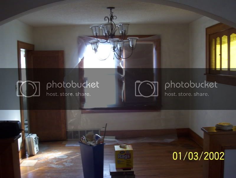

Oh and Brian and I are playing a game... it's called "Let's see how many times Brian can walk into the damn chandelier in the dining room" game.
I swear he hit his head on it about 10 times today. haha
lol yup. thats exactly why i ripped out this pos (pic 1) and put in this one (pic 2)
hit my head on it all the damn time.
Yeah, and it's already bunched up as far as it can go to the ceiling. When we move in my table will be directly under it so it won't matter. It's an ugly chandelier, EVENTUALLY I'll put some new lighting in.

Brian and my work upstairs in the hall/bathroom ripping out the carpet;
Plastic over the windows;
Now as for the piping I mentioned earlier, this is coming off the drain for the tub upstairs;
$15 bucks at Home Depot later;
I still need to get some primer/cleaner on the PVC before I cement it into place, but it'll be set tomorrow once I get the caps off the damn cleaner.
Just think of it as a sort of... time capsule;
What's left of my kitchen ceiling;
:bo:
That's why I put all that shit under it.
what did you use to keep the plastic up? there is adhesive type that all you need is heat and it seals it up air tight..
Staples. $2 bucks at home depot, which I used with the T25 staple gun off my work truck.

Now there's even less of the higher ceiling left. I ripped the living shit out of that damn thing. Fucking mesh. I did so incase in the future I decide to replace the drain pipe going downstairs with a PVC pipe. But it's good to know where all my plumbing is anyway. It's all down the wall behind the cabinets right by the back stairs leading outside, but on the inside wall.
