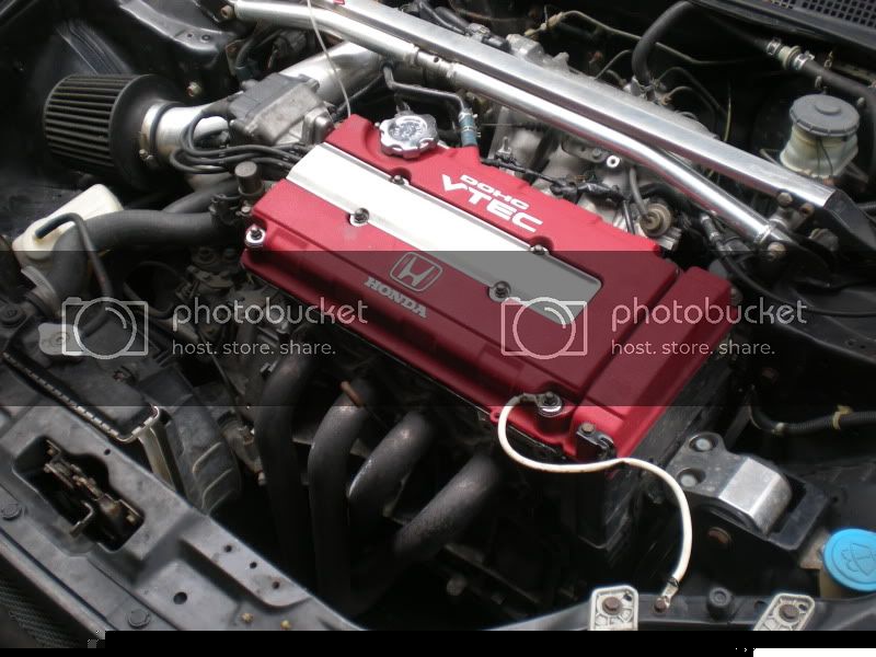

jdm b18c swap. lsd s80 trans
Busted 4-1 ebay header. The thing was all busted up from being bottomed out and leaks. Threw a stock gsr mani on there for the time being.

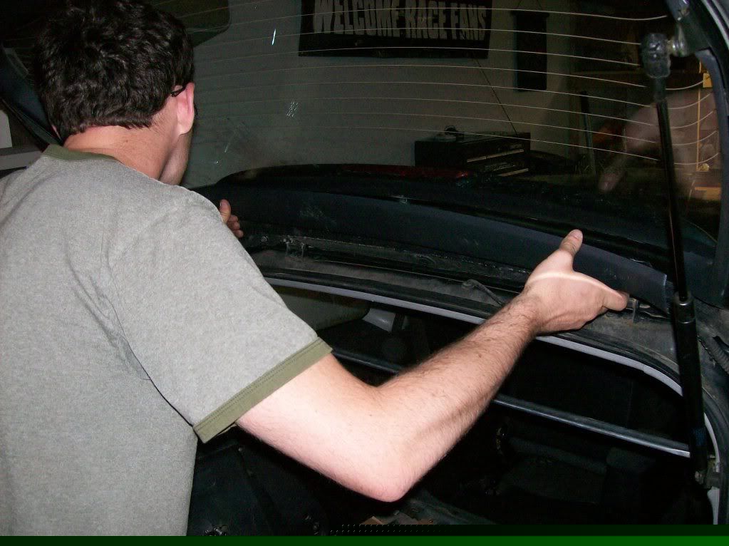

I then set out to cure one of the things I HATE about high hp cars with stiff motor mounts: Rattly interior panels. I removed every single panel, checked all the clips and screws, and put 3m adhesive foam stripping on all of the contact surfaces with the body. It was alot of work, but it sure paid off.

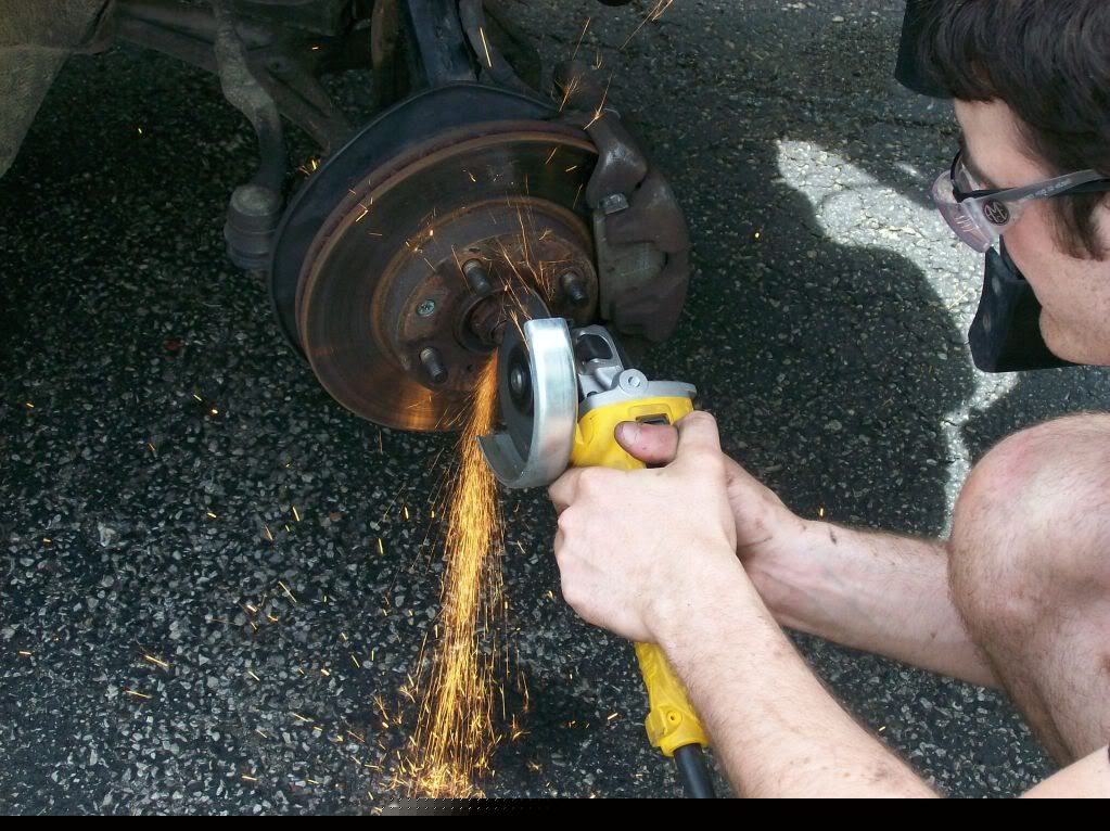

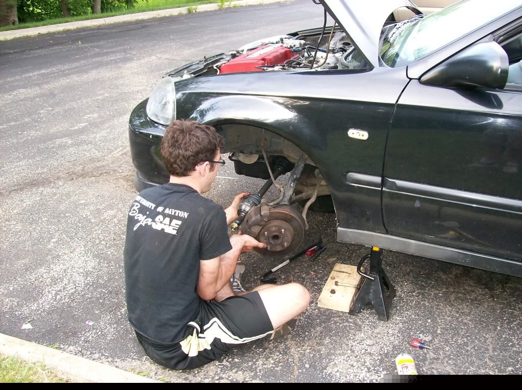

I could not get the original axle nuts off for the life of me. I tried every trick in the book, even snapped a breaker bar. I said fuck it and ended up cutting the nuts off.
Swapped new autozone CV's into the new hatch. Lifetime warantee FTW

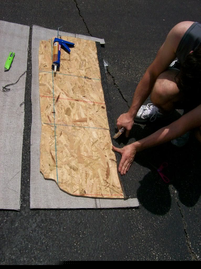

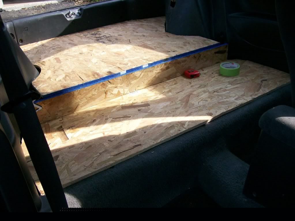

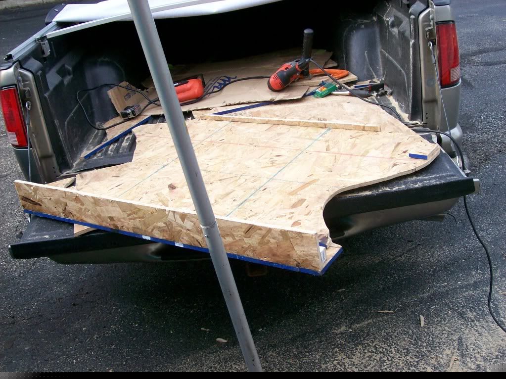

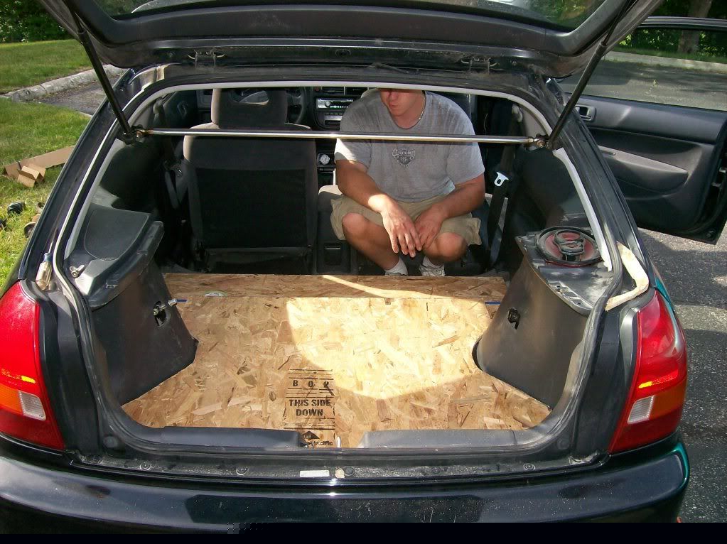

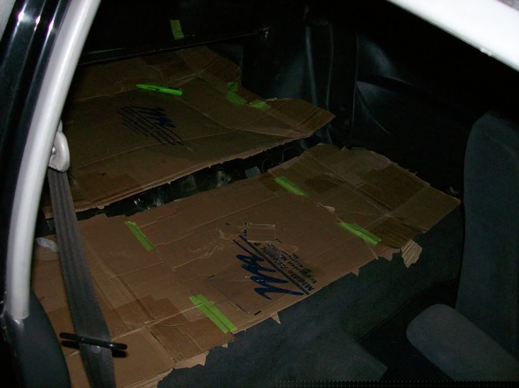

Oh. forgot to mention, I sold the ebay racing seats and replaced them with a set of 00' si seats. Anyways, the main goal was to do something about the rear seats. The teg seats looked like ass, used hatch rears were hard to come by, and hell, I never use them. I usually use the hatch for its utility with the seats folded flat. I decided to build a carpeted hatch deck with the help of a friend.
Using a large box from a dumpster as a precision tracing tool:
Cutting out the form from 1/2" plywood and assembing with screws and lotts of liquid nails (to prevent any creaking)

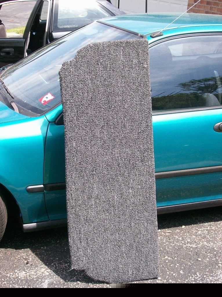

like a glove:

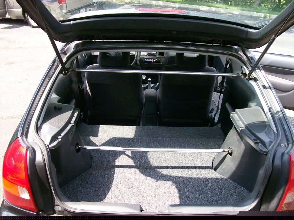

Carpeting like a pro:

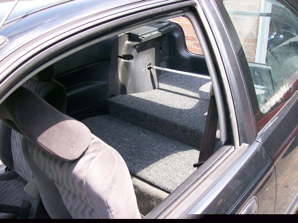

Looks good...
Factory Fit n Finish
The carpeted deck is great for utility and keeping things clean. Mine definately added a few lb to the car compared to the seats. I used 1/2" plywood. It's extremely strong and doesn't flex much. If I did it agian I'd go for 3/8"
